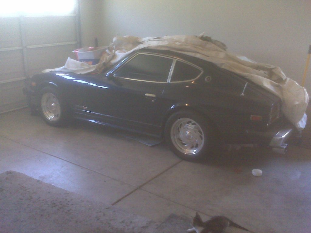

My Z is garage kept but I will be taking it in for a new paint job. I will stick with the Sikkens paint system. Estimated date of completion is summer of 2011.
Before paint begins I plan on working on chassis and steering, installing: a new set of frame rails, sub frame connectors, 4 point roll cage, camber plates, shock tower braces
Larger sway bars, New rack and pinion with bump steer brackets, new AC system (Nissan), Leather seats with lumbar supports etc.
Mechanically: Build a larger than 3.2L stroker given block clearance WITHOUT taking the bore to its max size. Turbocharge it,
tie it all together with a Haltech ECU and a coil pack per cylinder setup along with a rebuilt T5 and a centerforce clutch.
I will save lots of money fabricating or modifying much of the things myself. Pics will be added as the project progresses.
For now, this is our kittens' bed at night.
