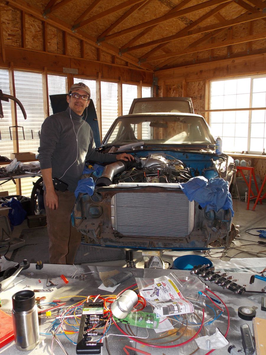

The engine is running using Megasqirt 2.0 with circuit board 3.0 which I soldered up myself.
It has 4" intake tube into '96 Mustang Cobra intake manifold.
The engine I pulled from Pick n Pull..................1993 Lincoln Mark 8
4.6L DOHC
Transmission T-45....output yoke has 1330 u joint fitting....I welded a 1310 yoke to stock Z drive shaft front and used conversion u joint 1330 to 1310. Works but not balanced.......I'll order a real drive shaft soon.
