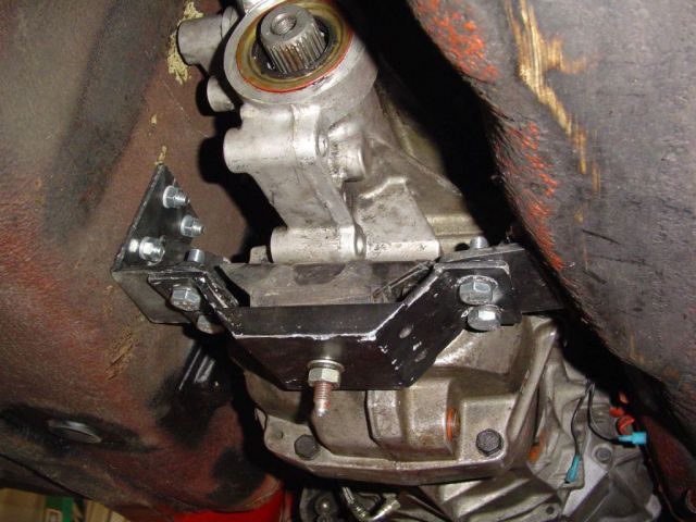

Fully adjustable T56 Mount
Large plate on the inside of the car is undectable through the carpet. Side plates create a level platform to hold the carrier. Carier may be slotted for lateral alignment. Carrier may be spaced down with washers. I intalialy mounted it with the T56 jambed against the roof of the tunnel to ensure the full range of adjustment. When you are happy remake the mounts and bolt them in if you don't want the slots and washers. Uses stock Camaro T56 rubber mount. Excellent exhaust clearance. Easy removal of transmission, just 4 bolts.
