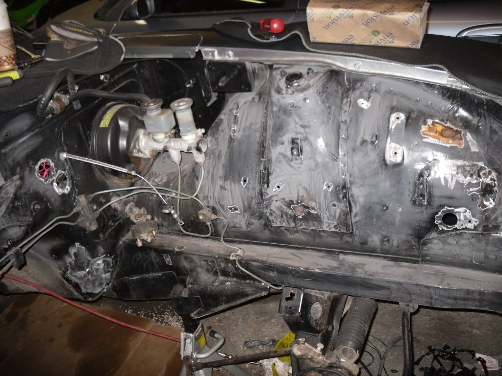

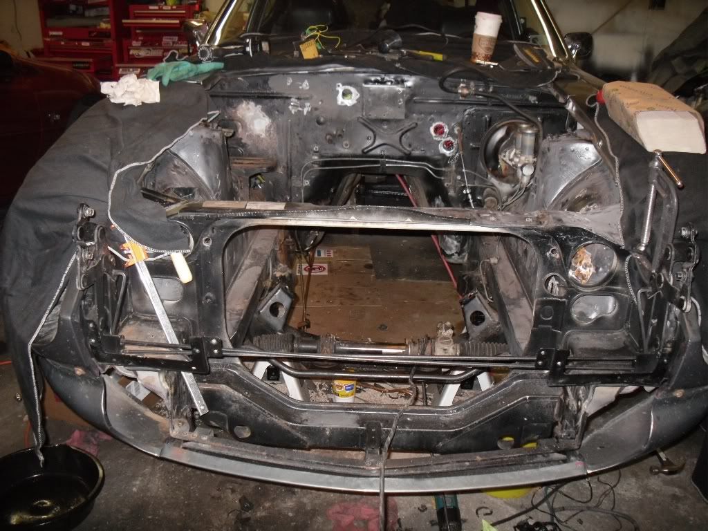

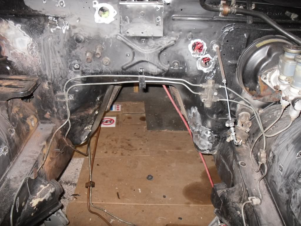

I tore into the wiring, labeling everything, and taking it out of the engine bay. I'll be using a stand alone wiring harness, so 90% of this will be replaced / deleted.
Posted Image
Here's the engine bay, pre-cleaning, without all the wiring.
Posted Image
Here's where all the wiring now resides. haha, Just for the time being.

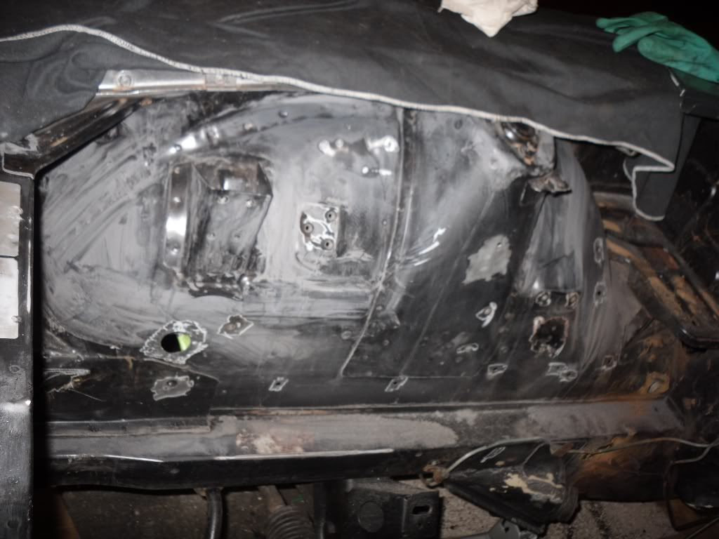

I did find a couple more small rust spots, in the culprit areas.
Below battery box
Posted Image
and on the drivers side, same spot
Posted Image
here's the rust on the passenger's floor pan. Not terrible, but I'm gonna replace it.

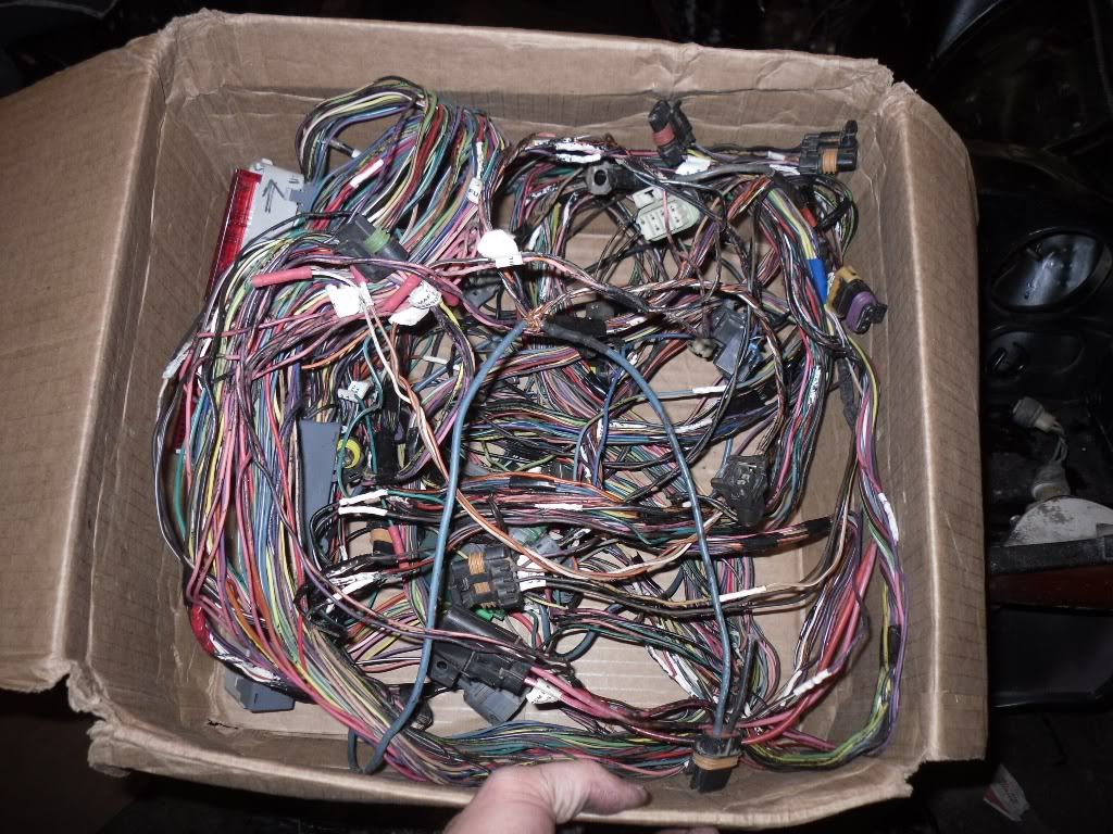

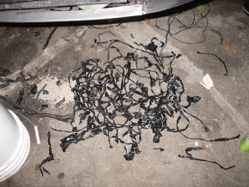

I took the stand alone harness out of the box that I received it in, only to find that it was wrapped head to toe in black electrical tape. This is a serious NO-NO. It was built at least a couple years ago, and the tape decided to deteriorate, and get gummy. So I stripped it all off ( HUGE PITA )
Here's the aftermath
Posted Image
Now I'm left with a gummy harness, so I've been using adhesive remover to get all that **** off.
Posted Image
It was a good thing I did this, as I found some shoddy connections held together by the ol "twist, tape, and hope" method:bang:

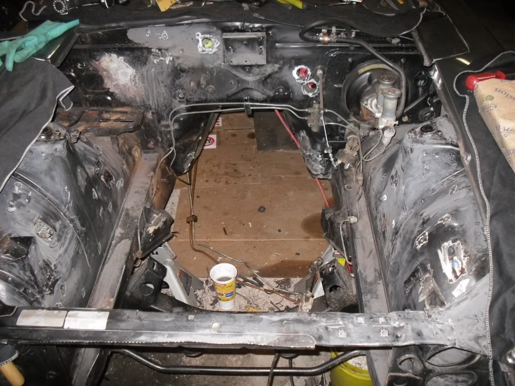

I went to work on the engine bay, sanding it with 220, and taking all the unnecessary crap off the fender wells and firewall. I intend to weld up all the holes, and make it a nice smooth final product
Posted Image
Posted Image
Posted Image
Posted Image
Posted Image
Then I went through the car harness, and trimmed out everything I won't be using. Leaving basically the horn, and headlights / side markers. All these will be run together, through the frame rail to the front, so they'll be completely hidden, and out of harm's way.

Posted 09 December 2010 - 07:11 PM
Quick shot of the brackets I build for the rear of the fuel tank mount straps. 2.5" angle iron, 1.5" wide. drilled a 3/8" hole, tapped it to M10x15, threaded the rod into it, welded the back side. I then welded these to the 1.5" square stock above the tank. Came out really nice. More pics to follow later
Posted Image
Posted Image
And then I FINALLY finished the body work in the engine bay. Ended up smoothing most of the welded areas over with bondo, to get just the finish i wanted. Here it is after 1 coat of primer.
Posted Image
Posted Image
Posted Image
