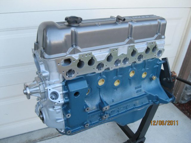

  8. There is a hole in the rear drivers side of the engine block. In the pic it is in the blue area to the right of where it says Nissan- Japan. To the right of the block plugs. It looks like their's a bolt in it, in the pic. What's that hole for? Thank you.
