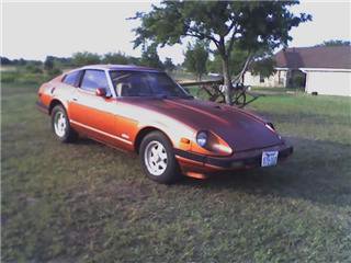

  1. Iam using a stock tuneport That I got from a local junk yard,complete system wiring harness and ecm for $ 250.00 going on my 83 zx SBC
  2. plus $500 paint and body work I do my self plus $ 500 for interior parts
  3. 1. car 83 zx $200+ traded a 454 block 2. used good runnning 1975 350 bought the whole 75 malibu for $75.00 3.sold the malibu for scrap iron for $65 4. 350 motor cost me $10.00 5. complete gasket reseal kit for 350 $100.00 6.transmission 2004r overdrive free, came from a 84 olds with BOP and chevy bolt pattern 7. rebuild kit for trany $100.00 8. home brew shift kit for trany free! shift fim in 1-2, 2-3,&3-4 sweet! 9.motor mounts free 75 malibu and home made to fix zx free 10 exhaust manifolds I have discoverd that the old 60's to early 70's ram horns style will work ...use 2 passenger side they work on either side! with the motor set backabot 2 inches, that's about 1 inch measuring from the back of a hei distribtor housing to the fire wall. pics to come shortly! total so far $ 210.00 all I need is the drive shaft cut and make my home made trany mounts!!!!!!!!! plus $200.miss .............so it cost me about say $600 when Iam done!
  4. getting ready to pull my 260z motor & 5 speed trany out of my 83 280zx and put in a 350 chevy, trottle body motor and 200r4 four speed auto OD trany then buying a tune port from my friend for $ 250, complete system. I want to the see differance in performance in the quater mile
