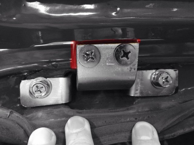

  1. It is the piece shown behind the hinge in the photo
  2. If you have your rear hatch off, the piece that gets screwed to the hinge is a small piece of bent metal that is bent and welded to the hatch. I need to know the angle of the bend I that little piece of metal.
  3. Can somebody do me a favor and measure the angle of the flanges that screw to the hatch hinges? Either inside angle, or outside angle. I am installing a fiberglass hatch and making the flanges myself. I just need that angle I have attached the dimensions that I measured in case somebody else needs them thanks! datsun hatch flange layout.pdf datsun hatch flange dimensions.pdf
