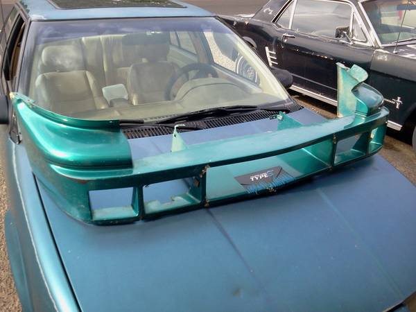

p.s. ive attached a pic of the car and engine just so you can get an idea of what im working with, ill start a build thread later tonight with much more info and pics once i get this engine/trans mounted .
