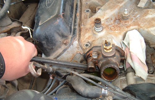

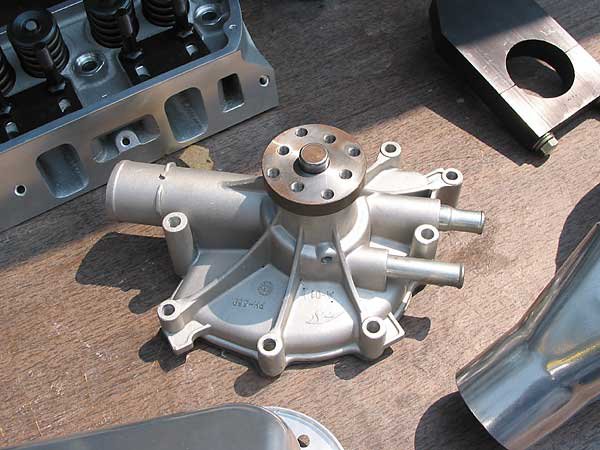

I know the feeling, usually here it is still over 100* outside when i get home from work at 8 pm. Here are some pictures of the same style waterpump with 2, 5/8" nipples (pic is upside down) and the same style thermostat housing just like i have with the boss on the top, where this guys sender is at, but mine isnt tapped. I am assuming there is supposed to be a pypass hose from the side nipple on the housing to the top hose fitting on the water pump since that is a suction side of pump. My heater hoses then should run from the lower nipple on the pump, out to the heater core and return into the boss on top of the t-stat housing. Correct??? -

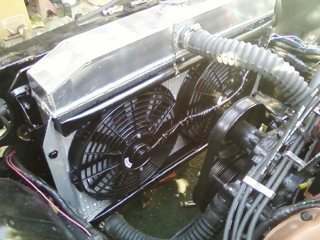

Well i guess i can refab a shroud for the 16" puller fan, no problem at all, just want to make sure it will work correctly before i make one out of 'glass. i have 8" between the radiator and waterpump pulley to play with. I just thought the 2-12" fans would pull more air through the radiator fins than the 16" would. The reason i didnt mount it onto the newer radiator is because at highway speed the 16" fan was restricting airflow and run hot, (s blade style)so i bought a pair of high cfm 12's (straight blades) I guess then that calls for those little rubber flaps that open at highway speeds but held closed by the fans at low speed made famous by GM. Funny thing is i didnt have any problems with the datsun radiator until i had it rodded out, it never got above 190. So the little nipple on the t-stat housing pointing straight forward is a bypass that goes where??? My water pump has 2 5/8" nipples one is on the pressure side of the impeller and one is on the suction side of the impeller. There is a boss on top of the t-stat housing that hasnt been drilled and tapped before the t-stat, is that where it is supposed to go?? same area as the intake side of housing. I can always make a 90* fitting for it. I dont know because i bought this engine already removed from the car and have tried to look at others at the junk yard to see how they are routed. Seems like every one i find has had hoses and wiriing stripped off of them. i am trying to keep these hoses and everything as neatly routed as possible. -

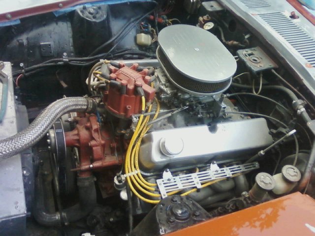

This is a aftermarket water pump for this engine, forward rotation serpentine belt driven as it came from the 88 lincoln towncar originally same grooved pulleys. As for running the heater line into the intake beside the water neck, that port is not accessable, it is partially covered by the HEI distributor. They are run right now into and out of the engine at the t-stat housing before the t-stat and into the bottom 5/8" port of the water pump. Just wanting to make sure the arrangement i now have will circulate enough before i cover them all up with aluminum side panels this winter. And yes i prefer to stick with the top flow radiator because the side tank ones mean i have to run the top radiator hose across the engine bay to the top fitting, dont want that since i now only have a 13" top hose and 16" lower hose that isnt snaked all over the place and just looks neater. And no they arent collapsing. I have been looking for a open faced (No shrouds) 14" to 16" fan to mount an inch or so in front of the radiator like the factory cobras have but cant find any. I have a 16" s blade fan with shroud i can cut out some of the grill work and mount up there. Right now my fans kick in at 150, I just dont want to surface mount anything on this new aluminum radiator. There isnt anything mounted in front of this radiator to block airflow. My trans, oil and fuel coolers are mounted horizontally across the bottom close to the bottom tank. Am i just worrying too much about 210 to 220 degreees??? -
Hey there people i am back again with another question / problem. This summer has been hotter than normal so i had been having problems running hot with the datsun brass radiator, so i went and bought a new aluminum radiator with 2 rows of 1" tubes, 2 new 12" puller fans rated at 1550 cfm each. i did test then to make sure i had the airflow going the right way before installing them. I am using a 180* failsafe thermostat and i am still having a problem of running 210* to 220* around town. Is it normal for this 302 (1988) to run this hot? I get worried when i see the temp creeping up above 210*. The main reason i get worried is anytime it gets above 200 it tends to run on when i shut it down. Right now it is only in the high 80's to mid 90's and it still runs that hot. Hate to think what will happen when i install A/C in the future. My original datsun radiator was cooled by a 16" puller fan with shroud. Another short question, to what points does the heater hoses hook up to this 302?? i have 2 ports on the water pump and 1 on the thermostat housing. New radiator original radiator
