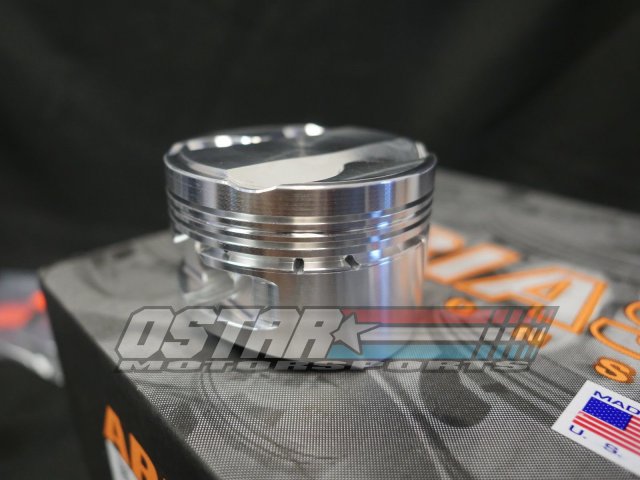

I would have to see the pistons in person but the rb26 pistons look like you could safely skim the necessary off the top. That is why i'm looking at them. It would also lessen the valve cutout problem . I agree with you though there are better ways , just depends on cost.
