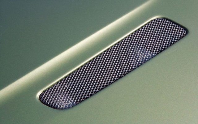

Fresh Air Vents for Velo Rossa As I'm getting closer to completing my build, I noticed that the Velo Rossa hood covers up the fresh air vents on the Datsun. I'm looking for suggestions on how to get fresh air into the heating cooling vents. One idea I have is to run a duct from the front of the car into the air boxes, but that would clutter the engine bay. Another idea would be to put vents on the hood like the original GTOs had. I'm not a big fan of this. To me it looks like they forgot that the driver needed air and just stuffed some vents on. Kind of ruins the sleekness of the car. I guess a third option would be to add grilled vents in the hood above the boxes that sit flush with the hood. The attached pic is vent from an Aston Martin that could look nice. And it also occurred to me that I could punch a hole through the fender well and up into the air box and take advantage of the side vents behind the front tire. Anyone else have a thought? Any pictures you can provide would be great.

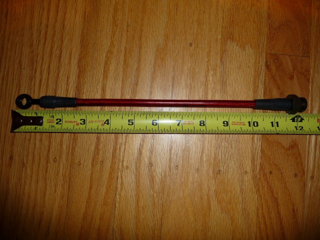

I bought some SS lines that have the right fittings on each end, but they are only about 12" long. With the rear tires off, I can raise the suspension high enough that they bind at the top of the range. I would buy some from Ross at Modern Motorsports, but he doesn't seem to be around anymore. Anyone know where I can get longer ones? -

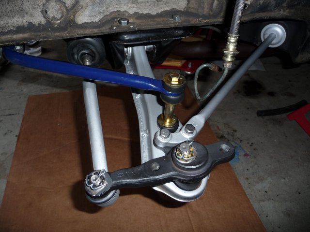

What a happy sight. Everything renewed and ready for when the struts come back from the welder. What I ended up doing is bolting the sway bar to the car as usual and then with the end links in place, I put a long piece of pipe on the top and wedged that up in the strut tower where the strut would normally go. Then jacked up the lower control arm which squished the bushings enough to get the nut on.
Yes, I'm using all the new hardware that came with the end links. I think I will try a combination of compressing the top two bushings with a clamp and jacking the control arm up to squeeze the bottom. I had not thought of that because the repair manual instructs to put the end links on and then clamp the sway bar to the body. Thanks for the advice. Michael
This project has been one of the more humbling ones for me. What I think will be simple becomes... I'll stop whining and ask the question. I'm installing Energy Suspension polyurethane end links on the front of my 280z using the stock sway bar. I can't get everything compressed enough to get the nut on the bottom. The poly bushings have a raised portion on them that is supposed to seat inside the holes on the sway bar and the lower control arm. The raised part seems too large in diameter to fit into the sway bar hole and the lca especially. I think that's partly why I can't get the whole thing together. Please share your experiences in how to get this compressed enough to get the nut on. Thank you, Michael
