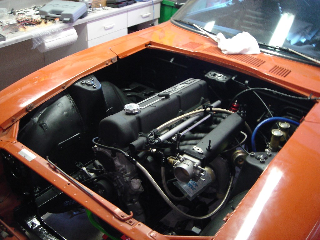

After re-setting lash to fix the "sewing machine" emanations from the engine, I realized the cooling system was, uh, poorly modified to say the least. The PO had slanted the top of the radiator so that it was in front of the core support and cut the stock hood so it had a Ford GT40-style vent down into the engine bay. Since that would completely interfere with the upper radiator hose, they did an Autozone-special and hacked together a "U" shaped rad hose. Needless to say it didn't work, etc. Most of the engine had stuff like that, even though the engine had been rebuilt with head studs and decent bearings, etc. the rest of the engine bay was poorly maintained.
I basically pulled everything and started over. I bought a ZXT powerplant and swiped the turbo oilpan, valvecover and manifold from it. (the rest of the engine sits for now in case I go with a built L28 instead of a VH45DE or LSX) I cut all extraneous stuff from the intake manifold, ported for a 240SX throttle (note the LACK of a spacer), coated it, etc. I built my own Megasquirt II and used BRAAP's old EDIS crank trigger brackets and GM 1-wire alternator relocation brackets. I built my own 3" aluminum pipes, bought an ebay 24"x12"x4" intercooler, Holset, etc. I used Mitsubishi Evolution injectors, which have a 560 cc/min. flow rate and a pretty fine mist (four holes in the tip). Basically here's what it has at the moment:
ECU: Megasquirt-II V3.0, EDIS-6 with passenger side adjustable sensor mount, Deleted Dizzy
ELECTRICAL: Completely rewired chassis and engine harnesses with new fusebox and toggle switch gear, GM 1-wire alternator, 4 gauge battery wires from rear-mounted Odyssey PC-680 battery and billet battery hold-down
FUEL: Palnet Fuel Rail, Evo 560 cc injectors, Aeromotive FPR, fuel lines patched into stock lines at the firewall, ZXT fuel pump
ENGINE: N42/N47 rebuilt by PO with ARP head studs, ZXT exhaust manifold and simplified intake manifold
EXHAUST: Self-made 3" mandrel-bent 304SS piping TIG'd with v-bands, flex section, all-stainless Borla XR-1 muffler, stainless hangars, etc. It connects to the Holset turbo through a 4" v-band which is tapered to 3".
TRANS: Late model 5-speed with ACT clutch and lighter flywheel
SUSPENSION: Tokico springs/struts, Energy Suspension master bush kit, POR-15'd suspension bits, new wheel bearings front and rear, new spindle pins, Rota RB 17"x9"/9.5" staggered wheels (-13 and -19 offset) with 255/40-17 and 275/40-17 BF Goodrich gForce Sport tires
BRAKES: Toyota 4x4 non-vented fronts and 240SX rear calipers with MM brackets, braided lines, new pads/rotors (just Autozone Gold stuff)
TURBO: Holset HE351 with cut and re-welded wastegate bracket, HKS adjustable wastegate for an SR20, ported wastegate, TiAL BOV, 3" aluminum pipes and silicon couplers, ebay 24"x12"x4" intercooler
INTERIOR: Mostly stripped with Jeg's 8-point, aluminum dash (weighs 3.8 lbs), Autometer gauge set, Kirkey aluminum seat and seat brackets, g-force 5-point harness
EXTERIOR: BRE carbon spoiler, carbon hood with 1/4 turn clips at four corners, tinted headlight covers, Xenon urethane front lip, shaved rear end, shaved front bumper
