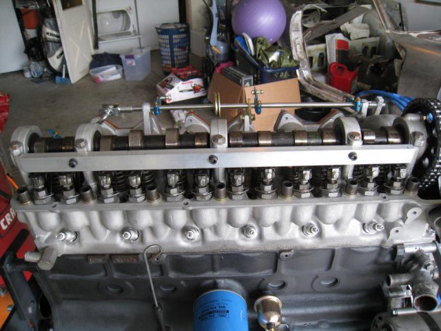

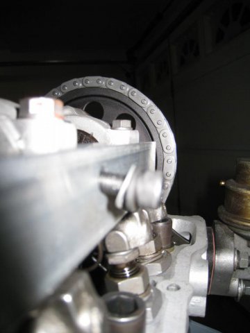

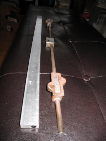

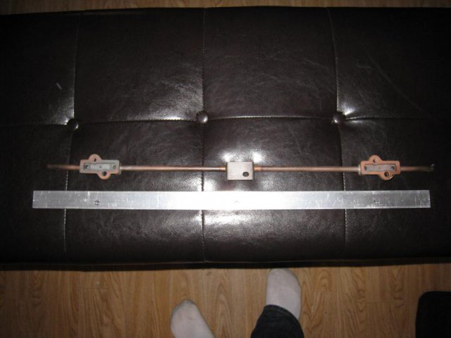

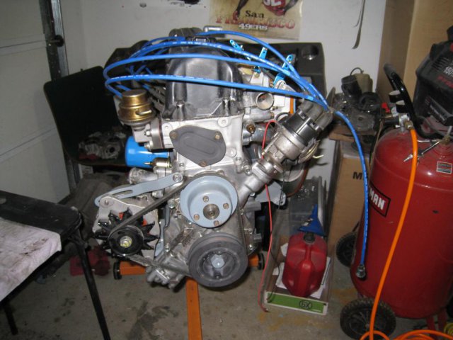

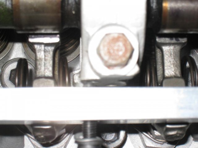

Ive been working on the motor, which is about done.  I was having some doubts after I bolted the head down to the block, some oil started leaking down the sides of the block.  The only oil used in the rebuild was the grease for the installation of the cam and the oiling of the head bolts.  The block was the only part not needing to be taken apart and rebuilt, it was perfect when I pulled the motor apart, the head was the issue.  My only guess as to where maybe any extra oil came from was the holes for the head bolts in the block...I had the block upside down for almost this whole build.
Attached File  20140617_232342_resized.jpg   88.86KB   0 downloadsAttached File  20140618_223831_resized.jpg   90.11KB   0 downloadsAttached File  20140617_232408_resized.jpg   97.24KB   0 downloadsAttached File  20140617_232350_resized.jpg   108.43KB   0 downloads

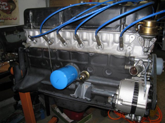

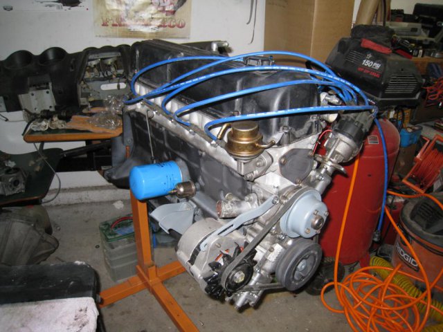

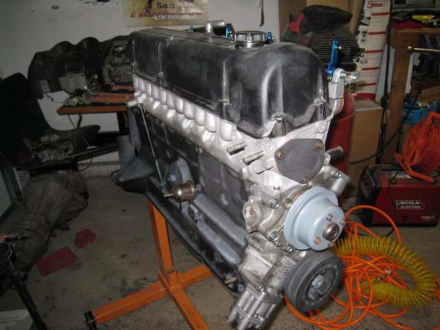

Here is the motor finally bolted down
Attached File  20140707_215713_resized.jpg   83.12KB   0 downloadsAttached File  20140707_215705_resized.jpg   96.93KB   0 downloadsAttached File  20140707_215705_resized.jpg   96.93KB   0 downloadsAttached File  20140804_205535_resized_1.jpg   98.69KB   0 downloadsAttached File  20140804_205501_resized_1.jpg   86.65KB   0 downloads

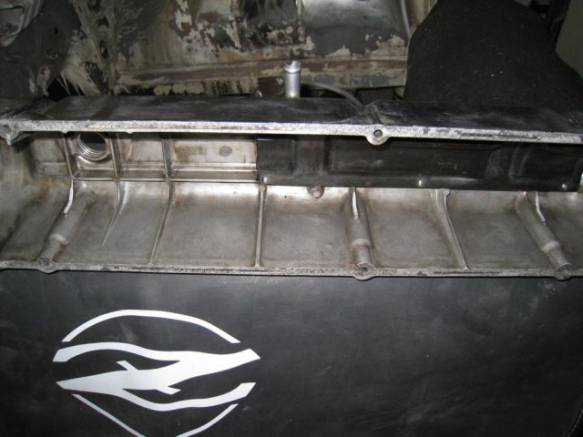

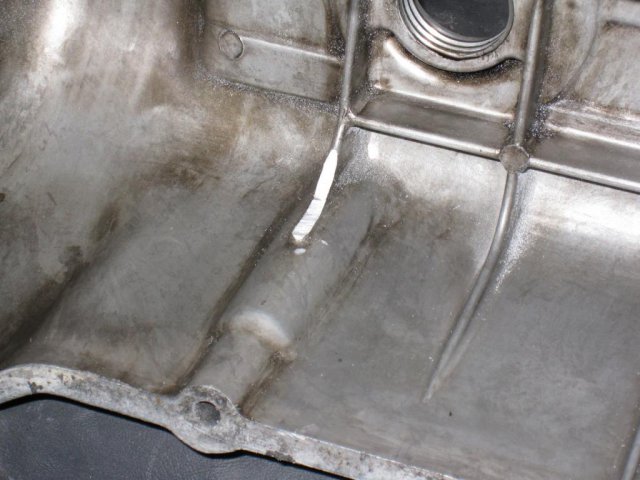

When I pulled the motor...actually when I got the car, i saw a pretty good oil leak on/all around the oil pump.  I cleaned all the oil off around the pump to try and find the source, everything looked good, until I checked the gasket in the middle of the pump, pretty old and needs a new gasket.  That is on order along with a new oil pressure sender and bulbs for my dash.
Attached File  20140815_150943_resized.jpg   65.47KB   0 downloads

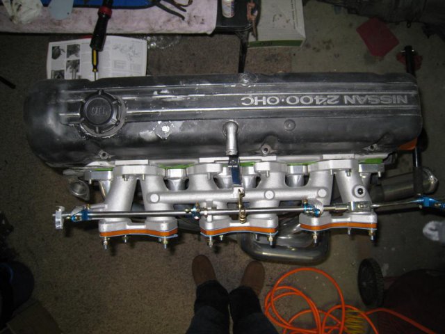

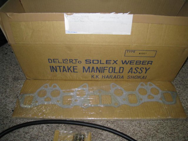

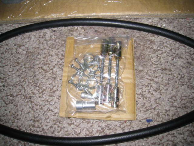

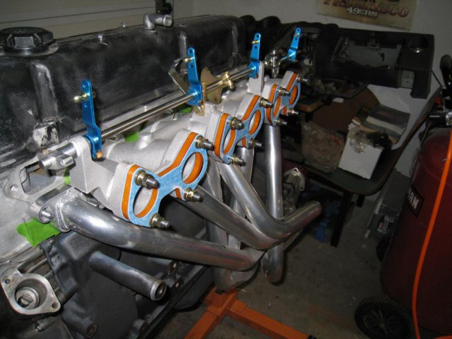

I got a new piece for the car  :D   I was going to purchase a kameari intake manifold, and I was going to have to shove out some dough, but after looking on a WTB thread and talking to Leon, I made a purchase of a brand new Harada intake that was on Ebay.  I was hesitant at first since I haven't bought anything over seas on ebay, but after reading reviews on the seller and sending a few emails, I went ahead and made the purchase.  Its looks good and just about mirror image to the old competition version.  Heres a few mocked up photos, Im using an messed up gasket thats all tape.
Attached File  IMG_1810.JPG   135.49KB   0 downloadsAttached File  IMG_1811.JPG   90.16KB   0 downloadsAttached File  IMG_1812.JPG   91.7KB   0 downloadsAttached File  IMG_1813.JPG   99.42KB   0 downloadsAttached File  IMG_1815.JPG   96.66KB   0 downloadsAttached File  IMG_1817.JPG   98.69KB   0 downloads

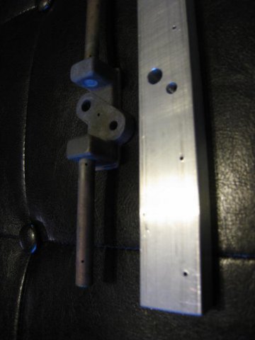

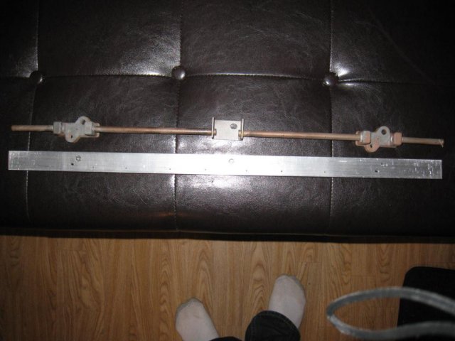

With my motor being basically done I am upgrading one part which I was hesitant to reuse, The oil spray bar.  I wanted to play it safe, so I ordered a spray bar from Larry and it will be here sometime in the next 2 weeks, pics to come when it gets here.Attached File  IMG_1830.JPG   117.92KB   0 downloadsAttached File  IMG_1831.JPG   101.01KB   0 downloadsAttached File  IMG_1832.JPG   95.72KB   0 downloadsAttached File  IMG_1835.JPG   70.1KB   0 downloads

Yup, because the spray bar is just pressed in fittings It will become loose and possibly end up somewhere else other then where it's supposed to be after age and higher RPMS.  Larry makes them by order out of aluminum and they come with mounting hardware.  I went with this application because Im keeping my car as close to original aside from squeezing some extra power out.  I would email larry and see if you can do an order if your interested in keeping it original, otherwise you can always upgrade to internally oiled cam and cam towers.  Larrys email is.. larryracer240z@gmail.com
I will post pics up when I get it in the mail and do the install.

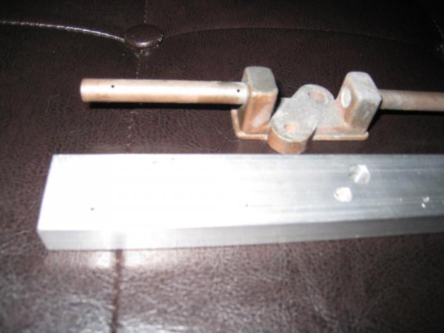

Its here!!! I finally received my new Oil spray bar today in the mail.  I must say the craftsmanship is awesome!  Here are a few shots I snapped before dinner for me and the baby tonight.  I'll do the install hopefully this week...depending on how the wife feels about that...
Attached File  IMG_1839.JPG   71.8KB   0 downloadsAttached File  IMG_1840.JPG   45.1KB   0 downloadsAttached File  IMG_1841.JPG   87.17KB   0 downloadsAttached File  IMG_1842.JPG   65.31KB   0 downloadsAttached File  IMG_1843.JPG   36.09KB   0 downloads

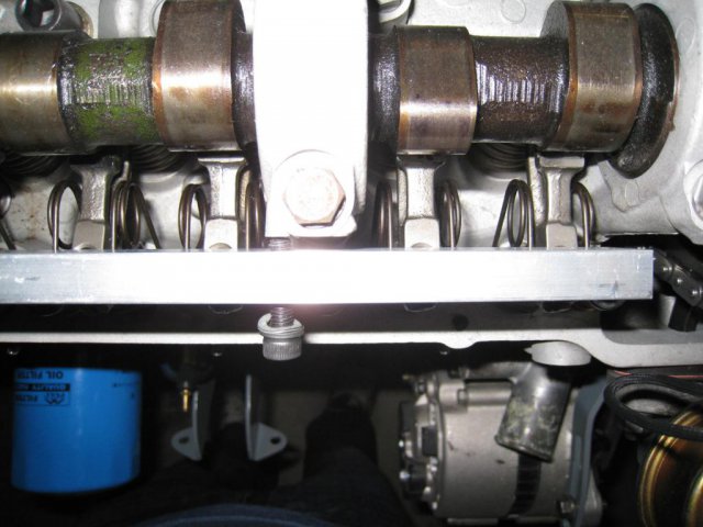

So I had the chance to put on my oil spray bar...to my amazement it did not fit.  I ended up emailing Larry and spoke to him about the bar not fitting.  He makes the bar to spec, however because our cars are taken apart time and time again, they aren't always going to match up to the bar because of the movement.  So I had to widen the mounting hole on one of the holes, I just had to be careful with the oil jacket.  After some massaging I was able to the get the bar on and bolted her down.  NICE!  I went ahead and grinded down the three spots under my valve cover so I could get this thing to close properly.  Attached File  IMG_1851.JPG   91.88KB   5 downloadsAttached File  IMG_1852.JPG   60.77KB   0 downloadsAttached File  IMG_1853.JPG   36.01KB   0 downloadsAttached File  IMG_1855.JPG   56.32KB   0 downloadsAttached File  IMG_1855.JPG   56.32KB   0 downloadsAttached File  IMG_1859.JPG   111.45KB   0 downloadsAttached File  IMG_1864.JPG   100.78KB   0 downloadsAttached File  IMG_1865.JPG   87.21KB   0 downloadsAttached File  IMG_1866.JPG   97.9KB   0 downloadsAttached File  IMG_1867.JPG   81.87KB   0 downloads
I found some polishing compound a friend gave me awhile back, I may try to use that in the next few days to see if I can get a nice shiny 2400 on the cover, then give a quick rattle can of the rest.  YAY!!! Progress!

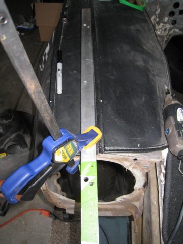

Video update on my build from a couple months back.  It shows how the seats look and I talk about making my seat brackets.  I was thinking originally of trying to get some Z seat rails to work.  turned out to be easier to fab up some brackets to make the recaro seat rails work.
#200 Perfect240z
