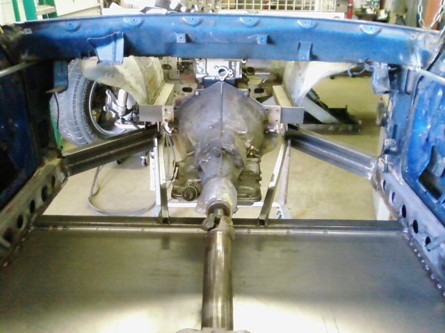

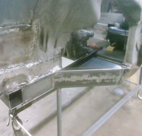

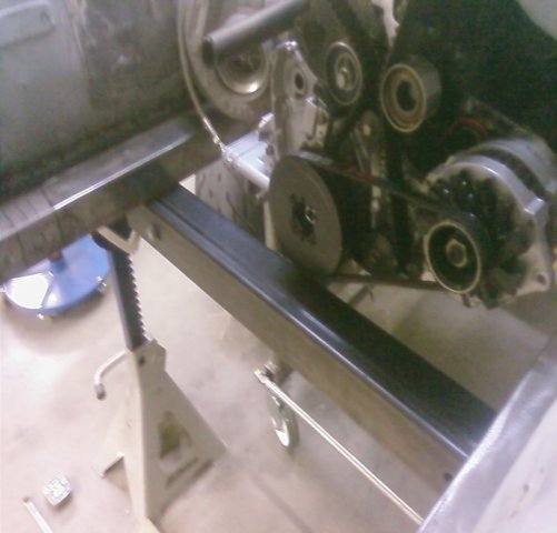

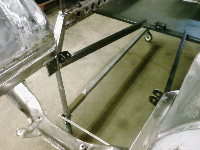

Here is a plan for improving the connections here, and gaining a lot of stiffness without a cage. In the front you can run a brace to the TC rod as Joe did, and one straight from the front corner of the rocker to the frame rail perpendicular to the center line. This attaches the frame rail to the TC rod to the rocker in a big triangle. In addition, run one to the upper frame rail outside of the strut (or punch a hole in the fender and run it right to the strut tower a la BRE). Now you have a vertical triangle from the rocker area and the stock vertical support to the front torque box and the upper frame rail/strut tower area.
There just isn't a similar simple way to tie the back end together because of the location of the wheels and the strut towers. I would run the tubing in the rockers and then I'd do the X in the back from the strut towers down to the frame rails that Cary, Steve Parmley and I have used. This X is a serious pain in the ass to weld to a cage, but I think it would be a lot easier to weld to the rocker without having to worry about a main hoop. To do this you would probably want to cut out the rear torque box. Probably good to check for seat clearance. I know I didn't lose any seat clearance, but mine attached to the hoop which is considerably higher than the rocker.
Then run a good set of strut tower bars front and back, and I think the car would be A LOT stiffer than stock. This is essentially what I did on my car, then I put the cage on top.
Some pics of Dave's car.
