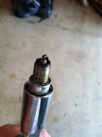

Been tweaking the webers. Got the idle around 900 and idle mixture screws adjusted. Need to sync the carbs. Running well at
12 degrees BTDC. Plug used to be a bit rich. Looks alot better now. Made about a 15 mile run.

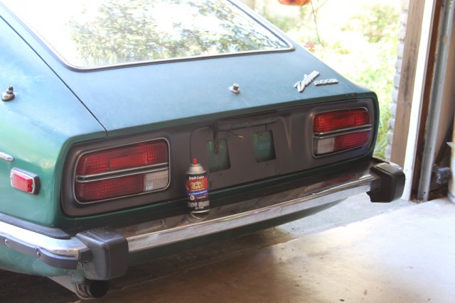

After searching for a decent price on 240z rear tails lights, I found a set, cleaned them up and installed.
Look great. Installing these on a 260 or 280 requires cutting some metal and getting new gaskets (or making your own which I did).
After looking at many different pictures to deterime the original color for the tail light housings I found "Dupli-Color" at Autozone.
The "Duplicates Original Honda colors" appears to match the original Datsun color right on or at least close enough for me.

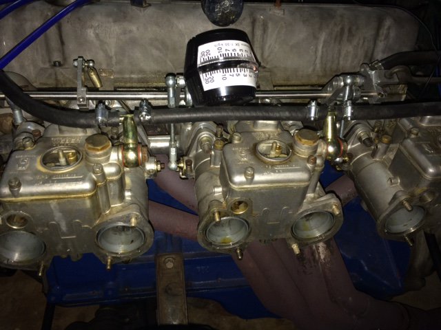

Wow.. What a learning curve on DCOE carbs. Huge thanks to Frank at Side Draft Central and the guys at http://forums.hybridz.org/topic/28318-weber-jetsall-who-live-for-their-triples-please-read-this/
Can't thank everyone enough.
So, setting the floats at 25mm and syncing the carbs with the SK tool. Installed a very nice O2 meter and making progress every weekend.
