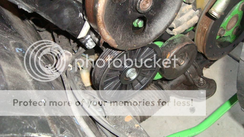

Say GOTHALOSISM, on your Z, did you cut your frame rails for that pulley? You used a smaller one and have a lot of clearance, what make and part number the pulley you're using?
If I do return this pulley, I just dont want to make another mistake of getting the wrong kind again.

Maybe I bought the wrong kind of pulley... Was it the one that has the big pulley or the one looks like it has a smaller pulley. I got the one that has the smaller pulley, because I thought it was smaller than the other one since the pulley on that one look massive.
This the pulley I got. Luckily the seller was kind enough to accept refund.

Should I be getting this kind (DORMAN Part # 34209 from rockauto.com)
Which pulley you lt1 Z guys are running? Part number would be greatly appreciated.
Looks to me like you have the right pulley. I don't know what the part number I have for the pulley, got it off Ebay and it has the small pulley. I have about an inch of clearance. Are you sure you are putting it on right? That red emblem should be on the outside of the engine block toward the frame.

That's really weird, I tried many different ways to fit it on there. Thanks goth for sending those pictures. I heard you could switch pulley to a 2.5" pulley with the 6 groove So you don't have to cut anything. I was going to do that, but I decided to modify my pulley since I get very impatient. Paying shipping, for return, and buying another hoping it fit, get a different pulley, and all. So I modify the one I have. I cut the one end off, flip it on the side I have more than one inch of clearance from the frame and clears the belts. One thing I worry about it's strength, I made it strong as possible. The alternator shouldn't take much drag to bend and twist the pulley, right?
I just remembered, I shortened and backed out the Datsun original mount towers and used the thinnest 350 motor mount, so the lt1 really sits really low and back on the Z. Maybe that why I had fitment issues. I did this because I want the lowest center of gravity as possible, and have enough room for a big turbo or super charger on top of the motor while keeping the hood stock appearance.
Here's some pics.

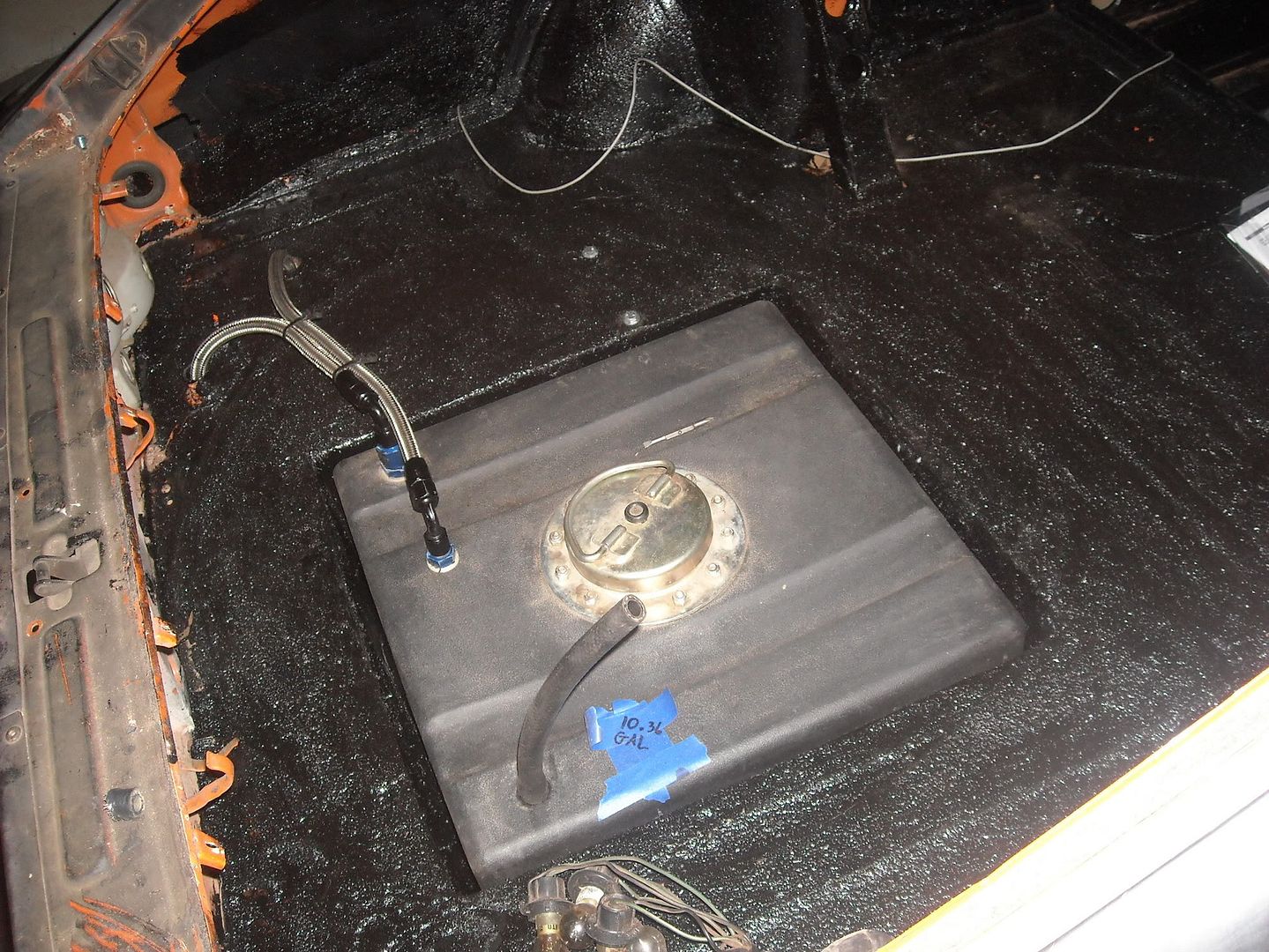

For the fuel system, on the LT1LS1 forums, they say I should have some kind of venting on my fuel cell. I have an open hole out of a hose on top. It would create vacuum and causing all my fuel to rush back into the cell. They said the LT-1 original fuel system is almost sealed.
I fear of sealing up my fuel cell because I don't want the thing to balloon up, that would be an scary image when I look at the rear view mirror. Is there any sort of venting I should look for? I seen a 8AN fitting fuel venting with a roll over valve, have it coil out of the cell with few loops and out of the car so gas dont leak out completely.
