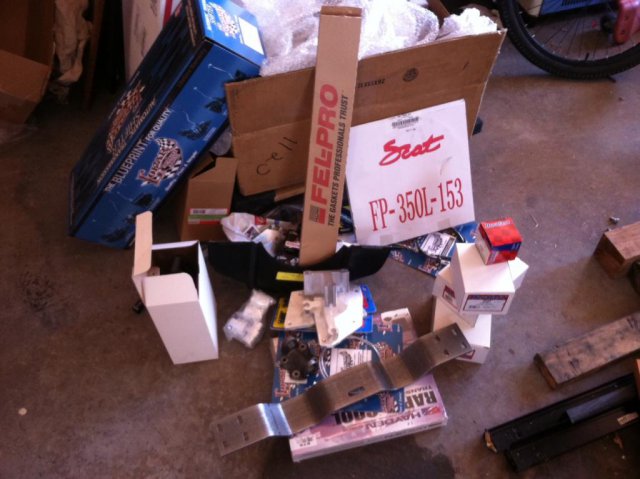

The parts fairy came.
I'm still waiting on:
Headers
Knock sensor relocation kit
New tailhousing (I'll explain..)
Radiator
As I was putting on my new Lokar tail shifter, I noticed that it didn't seem to be fitting properly on the tailhousing. Come to find out that the corvette tailhousing is much different than an F-Body one, so I've already ordered the correct tailhousing. I got the new intake manifold gasket on, EGR blockoffs put on as well.
Today the engine and tranny should go in. I also found someone local with the DZ push start kit. This thing is nice! I kind of buggered up widening the hole for the new switch, but you can't really tell. I'm thinking about filling it with some rubber or something to clean it up.
Also, I wanted to rant a little about the JTR manual. Everyone recommends it and it was the first thing the person on the phone mentioned when I called JTR to check if they had the parts in stock before I ordered.
It doesn't mention bolt sizes, nor does it actually show you what your mounts should look like assembled. It feels like it skips so many steps in it, while giving you needless information. In fact, it really didn't give me any information that Hybridz hadn't. As far as measurements and bolt sizes go, once I am done I will post what sizes I used so others doing this swap don't have to scourge the internet or keep test fitting, etc.
