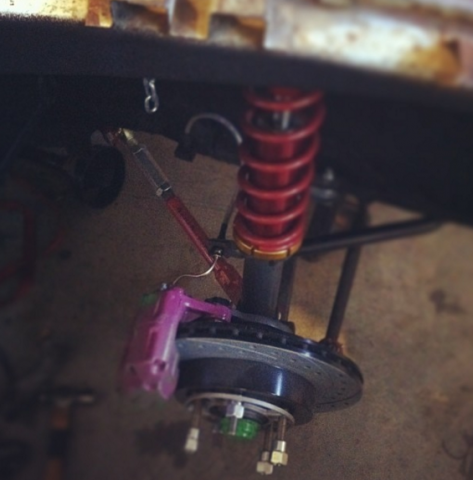

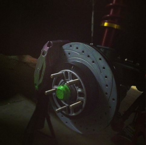

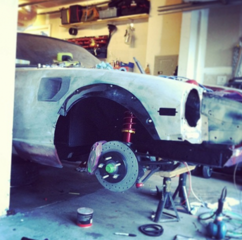

i have finally machined up brackets to fit Mitsu Evo Brembos front and back onto my 280zx which had a s14 front and rear member conversion.
1980 280zx with a RB30DET heart daily driver. :redface:
