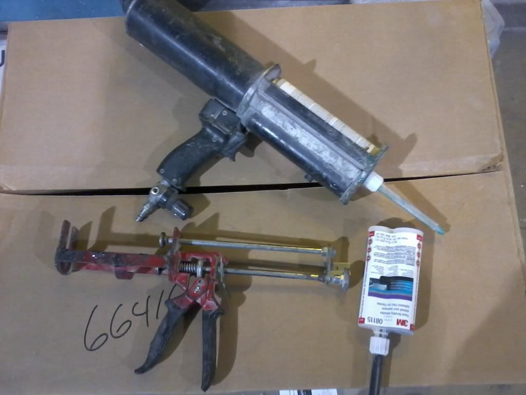

I use 08115 panel bond. 08274, Its used to bond fiberglass to metal by motor manufactures, and other uses. Its basicly the same thing as panel bond, but small differences that dont really matter much. Both of them are much better than Fusor that used to be commonplace 10 years ago. For making the transition from fiberglass to steel, panel bond would be a great added step to the bonding process. There are other 2 part products that are handy too. There is a plastic repair material with work time as fast as 50 seconds, 3 minute, that comes in handy for repairing ABS type plastics. Bumper covers, plastic trim. Clear epoxies. You can use denatured alcohol to wipe around edges and it wont interfere with the curing of the epoxy. Another tip on cleaning up is to allow it to wait untill it starts to kick to clean it up. Wait for the stage when its like wax, and trim excess with a razor, pulling it off. Any residue on a surface is easily cleaned up right after trimming. You can treat edges like caulking to give a clean look. Mask off the lines, smooth it down and then pull off the tape.

I would use 08274 because the cartridge fits into my pneumatic glue gun. I could empty that cartridge in less than a minute. The 08115 is made to fit a smaller gun and the small one I have is hand powered. It would take much longer to get all around the the car with manual cartridge panel bond. The difference between the 2 is the lable, quantity and cartridge style. The goo inside is the same.

If you dont want to spend a bunch of money on a pneumatic gun, the 08115 is the way to go. If you do this a lot, get 08274 and the pneumatic gun. I will get a current price for the larger gun and report back.

The rep for our supplier says the air powered guns are about 200 dollars. The one in my picture is a Swiss made gun by Mixpac. Type DP 400-85. Its been used for over 8 years and will go several more. It will likely be operating the day its phased out. Yes its been dropped a lot. Had cartridges explode in it. Its so robust I havent seen or payed attention to another brand or model. Sorry about the confusing posts. My concentration is not good. Spent a day out in a drizzle rain chasing a ghost on an 83 turbo and got sick.
