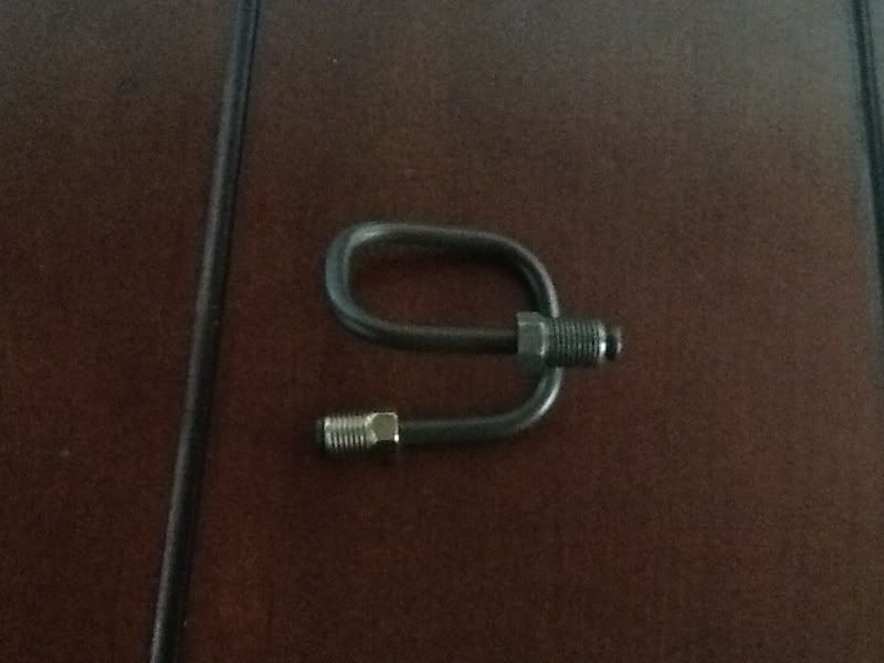

You can also buy conversion lines and splices from the autoparts store. My Master had been replaced with aftermarket leaving me without the proper flares. The lines cost about $4.00 and just had to be twisted into shape. You can also reflare the lines but I wanted to leave the option to go back if i didn't like the cylinder. If you go this route pull your own part numbers and go get the parts yourself from behind the counter. My local Advance sold me the wrong splices twice before I went back and pulled them off the rack myself.

I went and looked up the P/N for the conversion lines.The lines are3/8-24 inverted to M10x1.0 inverted. Poly-Armour PAA-0310 @ Advance Auto . The unions are M10x1.0 inverted to M10x1.0 inverted. I used these from AGS. They were a bit better quality then the Dorman unions and just as cheap. You need 2 lines and 2 unions.
Just twist them up(use a tubing bender) like so:
Attach your new adapters to the M/C hook up your unions and install normally. Everything will fit behind the stock heat shield.
