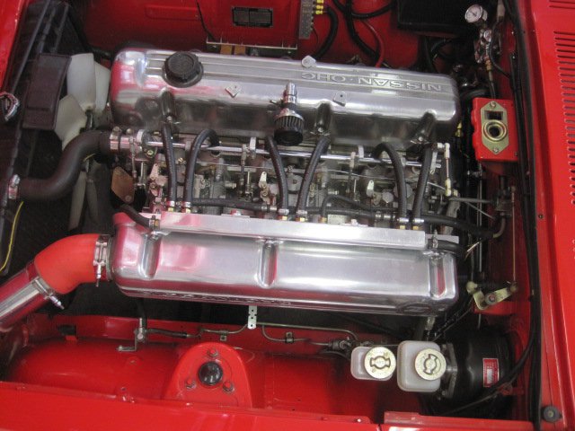

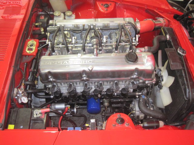

What has worked pretty well is the balance tube for a signal to my MAP sensor. I have read that with a ITB set-up the signal is too jumpy to tune with, but my signal seems very stable. It's really cool to watch it in real time on the laptop! I would really like to change the mounting set-up for the tube though. I want to clean up all the hoses running everywhere and get the balance tube right down on the intake. I have been searching for pneumatic quick disconnects to direct mount the tube to the intake. Being able to quickly disconnect the tube would facilitate quicker tunes. I have a 'clamp' that pinches all the runner hoses for when I am balancing the carbs, but it is a bit cumbersome.
It would probably be a bitch to try and quick disconnect 6 runners at the same time though-LOL
It will be interesting how the tune goes now that I have full control of ignition. I have looked at Lazeums ignition table and know that I can go way more on the advance at cruise. I have thrown in numbers for now and the engine runs pretty damn good so far. I will be curious how much I can lean out things now that I can advance the timing with so much control. My only concern is that the MAP sensor loading scale is narrow. It seems that other then very light cruise, loading shows in a very narrow band of 80-100%, which is going to make tuning a challenge. Since I haven't done this type of tuning, not sure if this is normal or a symptom of my Mikuni's and the balance tube. Will repositioning of the balance tube closer to the intake make any difference in the signal?

That narrow loading is a function of ITB's. That's why Alpha-N gets used for fueling with ITB's, because you normally don't get enough vaccum signal to have a clean running car at part throttle.
Normally, you'd like to see at most 60kpA of vacuum at idle, with 35kpA being stockish...you say you see 80kpA or so minimum...this points to either a large cam profile with a late intake valve opening, or the classic profile of an ITB car...both of which can sometimes use Alpha-N better than speed-density fueling.
You're doing ignition timing, so it doesn't make a LOT of difference for that here, being naturally aspirated.
Hate to speculate whether the changes are big -especially the butt dyno. I haven't done enough tuning, but I am amazed how well it runs-PERIOD! I spent very little time with the numbers and it accelerates and cruise better then ever. Not a glitch-hope I didn't just jinx myself-LOL
I believe I do see about 60 kpa at idle. OTHER then idle it seems a narrow range and as you said it will be a struggle with the ITB syndrome. BUT, the balance tube is doing it's job especially as far as giving me a stable signal. I need to hook up my datalog wire to a switch so I can start datalogging.
The other thing that's really stable is my rpm signal-so my flywheel sensor is doing it's job!

As for quick disconnect tubing---look up LEGRIS fittings. There are generic and chinese crap out there now---connecting them with the rigid HDPE or High Temp Plastic Tubing stubs, it's a press and pull proposition to disconnect them. Simply pushing a similar diameter solid plug, or cap in the hole plugs it for tuning. They also make small ball-valves that you can put in the lines...but that might get spendy for something you aren't doing all that often.
A carb jet in the MAP line, or even a small engine fuel filter can give some capacitance to dampen the pulsations to a more realistic 'average' MAP signal without degrading the MAP higher up in the rpm range where you want high resolution.
Alpha-N is nice on ITB's for Idle. And that's about it, going with the TEC2 PAFZZ Blend program, on the Bonneville Car, it was like night and day. Alpha N at closed throttle and a graduated Alpha-N/MAP based phase in based on rpm or MAP (forget which, may have been both) as the rpms rise and the cam comes on to give a good steady signal.
