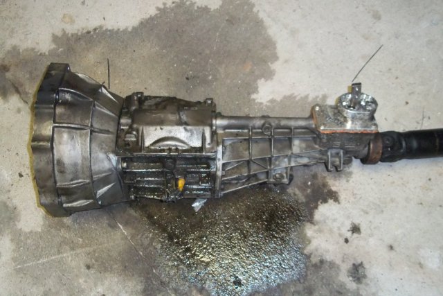

Got that mainshaft out today...centerplate is broken between the bearing bores. I have plans on how to fix it, but the gear WAS literally brazed onto the shaft. Found where all the brass came from...2nd gear synchro looks great on the outside but is completely missing on the inside.

Gets worse...Pulled the mainshaft gearset down...I found where all the brass came from. 2nd gear synchro cone/engagement teeth has a section broken out of it, that's what ate the synchro cones up. Also has a missing lock ball, 2nd gear was not locked onto the mainshaft.
Sorry bud, we're gonna have to go trans hunting again. What are you doing tomarrow?

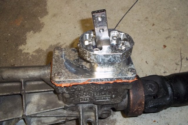

NEWS!! The trans is in the car and man this thing is big and fat. using the hoke adapter the shifter location is about 4" back from the t5 which required trimming of the tunnel shifter hole. also the tailshaft end of the trans so big i had to trim a ear off the trans crossmember factory mounts on the bottom of the tunnel to clear the case. JTR said the center of the tailshaft should be 4" from the top of the tunnel my shifter is HARD on the bottom of the tunnel and tail shaft is 4 1/8 so should be ok with some hammer time. the reverse and saftey switch on the passenger side are on the tunnel. the stock trans mount fits on the z32 box but the crossmember needs moved back behind the mounting ears in the tunnel and im going to slot the trans mout and weld on washers to relocate the holes some to move mount reaward to match the crossmember. the drive shaft looks to be 2.5" longer than the t5 was although the r30a looks longer its not! I still need to put the new diff flange on in case its thicker and measure again and i will post length for sure with pics.

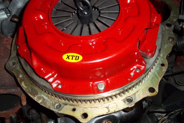

well nothing bad in the trans fluid light syncro shimmer and some steel stuck to the mag on the drain plug. refilled trans noise still there started thinking pressure plate bolts? so scopeed in the bell housing and all bolts are in and all trans front cover bolts are in but still noise even out of gear reving. so removing trans AGAIN!!!! to see if clutch disc has came apart there are marks on the pressure plate like a bolt has hit it but all in random spot like something has been bouncing around in there but i cant find anything thoughts guys???

Well noise fixxed me and xnke ripped the box out and found a thin gear shaped steel part behind the reverse gear that was missing a c clip and was flopping around on the shaft lol. It had rounded off all its teeth and was sawing its way through the tailshaft housing sooo we removed it because we could not see a need for it other than possibly noise or vibration damping. This is where all the steel on the magnet drain plug came from. Im going to knock my clutch and flywheel off tomorrow and replace my rear main seal for it is seeping into the bell some. then she goes back together and some gopro footage per xnke!!!!
