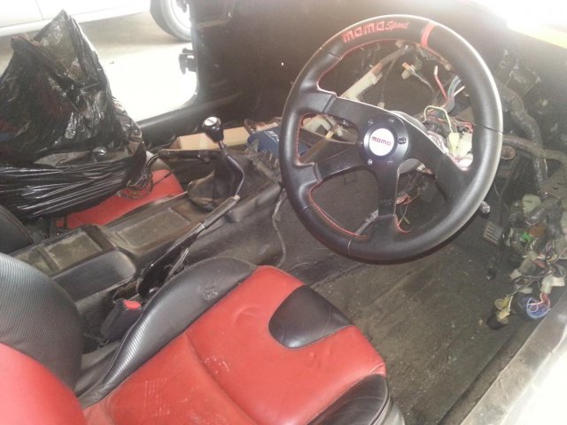

Hah, didn't know I wasn't the only one that installed these. They barely fit in the 280zx...I'll probably have to modify the rocker trim (scuff plate?) to fit because of the electronic seat controls. IF they had manual leather seats, I would jump all over those, but I didn't have any luck finding them so just had to play the cards I was dealt. Anyways, the passenger (manual) seat fit like a glove, the driver (electric) took some finess, but was able to get it to work. And yes it was extremely easy wiring up the switches...just 2 powers and a ground, or vice versa. Sorry, I installed these a while back and can't remember the color coding, but I believe they were the only thicker wires in the harness (16 gauge maybe...versus the other 20-22 gauge wires). And yes, I think they compliment the interior very nicely. Keep in mind the car is still being pieced back together so I'm missing trims / panels / etc. Just figured I'd take some pics to show these seats will work, since the topic came up.

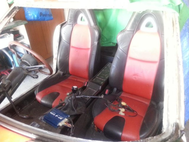

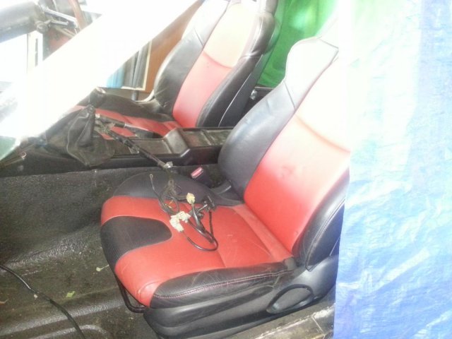

Hi guys sorry for the delay..only just stumbled back on this thread..seems i didnt have notifications set.
Anyway here are some pics. Sorry about the quality/angles etc its what i already had on my phone.
They are fitted into a 1973 240z. I believe i was the 1st in Australia to get it done and have since given the idea to a friend who has also fitted them to his 1971 240z with no problems with minimal effort..no swapping rails or anything just grind/cut off all the factory rx8 mounting tabs so that you are left with just the flat sliders and then bolt 2x 1" wide 5 mm thick flat steel bars to the factory rx8 sliders then drill holes in the steel bars to line up with floor and bolt down. As simple as that.
Share this post
Forgot to mention mine are 2004 model seats but i believe 2003-2008 are the same..well in Australia at least. Also if using stock seatbelts you will need to modify stock seatbelt buckle by slotting out the hole to accomodate the rx8 bolt which mounts the buckle to the seat.
Share this post

Don't think mine had the hump nor does my friends 71. If they did it doesnt pose a problem for how we mounted it. Most guys just use a peice of wood and a sledge hammer to flatten the hump as seen in a friends 260z with s2000 seats. No pics as its as easy as i explained. Just a peice of flat steel strip bolted to the sliders (once all tabs/brackets have been cut drilled out) and then holes drilled into the flat steel strip that correspond to the floor holes.
My edge of the seat bottom (thigh area) sits about 1/2 inch from tunnel.

No i didnt cut the floor at all. Mounted to all original floor mounts. Only the seat rail is modded. Im 5'9 and sits fine for me, its actually a little lower than a stock 240z seat just the backrest is larger and taller.
Would be good to mount it to the floor, but one problem i can think off is the handbrake positioning might hit your hip aswell as the trans tunnel being abit wider as you go lower.
