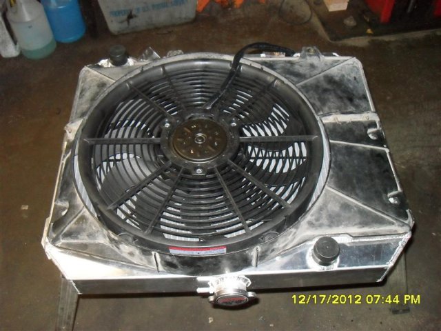

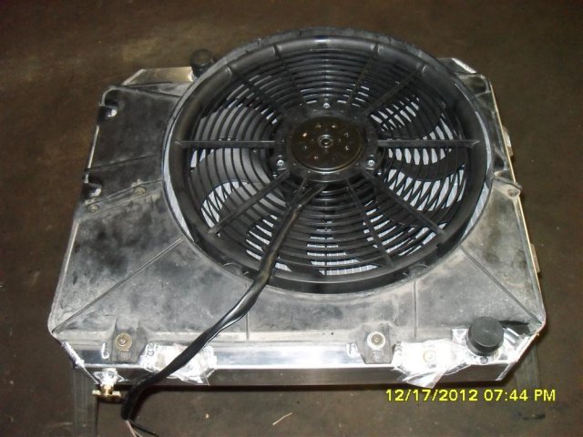

Just thought Id show you all my fan setup and how I assembled it. Keith (RebekahsZ) is using this same setup. He also gave me some pointers on assembly. (Thanks buddy!!) So here it is:
Champion 3 core all tig welded aluminum radiator. No plastic tanks! Its also a direct fit into the S30.
Heres the polished aluminum shroud and the twin 12" fans. I already drilled hole for the fans. Also there is protective wrapping on the shroud.
First you need to assemble the brackets that hold the fan to the shroud. these are the brackets.
Then insert them into the fan in the littel slots.
Congrats! Take a week off work after that mission. Next just lay the fans on the shroud. Dont remove the protective lining yet.
Once you do the line up the fans the best you can for max flow.
Mark the holes and try not to move the fans at all.
Then center punch and drill out your holes. I chose to use bolts to mount the fans as Keith reccomended. So i drilled for 5/16 inch bolts.
Now its time to be careful. Remove the protective liner. Lay down the fans and put the bolts in from the back. As to make enough clearance.
Next bolt the shroud to the radiator. Once you do that your done with assembly!
Thats all I managed today haha. Tomorrow I plan on installing the radiator and finising up some wiring. More to come!
