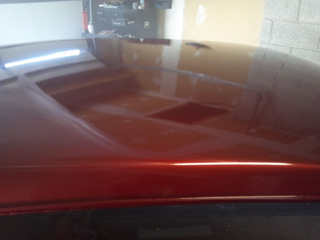

Ok, Time for a small but good update.
My 1978 280z 2+2 is now Zeal Red.
The Zeal Red is a single stage pearl from Mazda. It is a bit on the pricey side. Due to the rules of the EPA, I had to use a low VOC base and clear. This was a bit odd to me as the inlet pressure for the HVLP on the base coat is 5 to 8 psi and is a 75% overlap as from the spec sheet.
I must admit, it took me a few tests shots on the wall to get it right, but the car came out great.
The clear flowed well on the flat.
Some color sand needed on the sides though.
