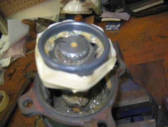

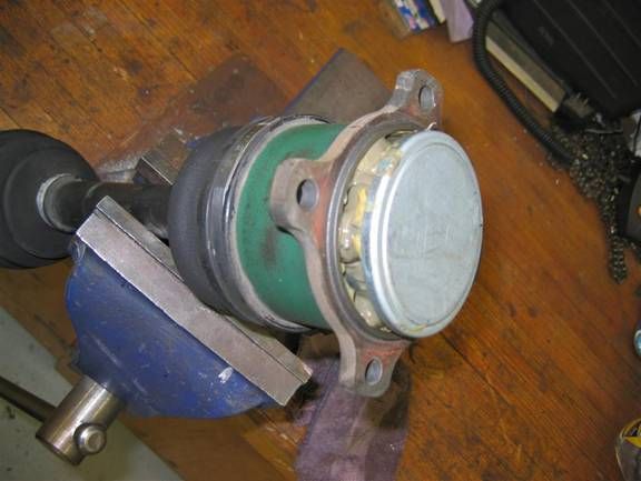

Before the CV axles can be installed, they must be shortened slightly. This is accomplished by tapping down on the flange on one end until the cover plate pops off:
Then remove the circlip, place some tape around the ball bearings so that they don’t fall out, reverse the ball assembly on the shaft, and finally reinstall the circlip:
The end cap then can be tapped back on, and the shafts are ready to install.
I dug this up on another website and was curious if this relevant to my issue. He shortened the half shaft  so could i lengthen them so they are not pulling out?

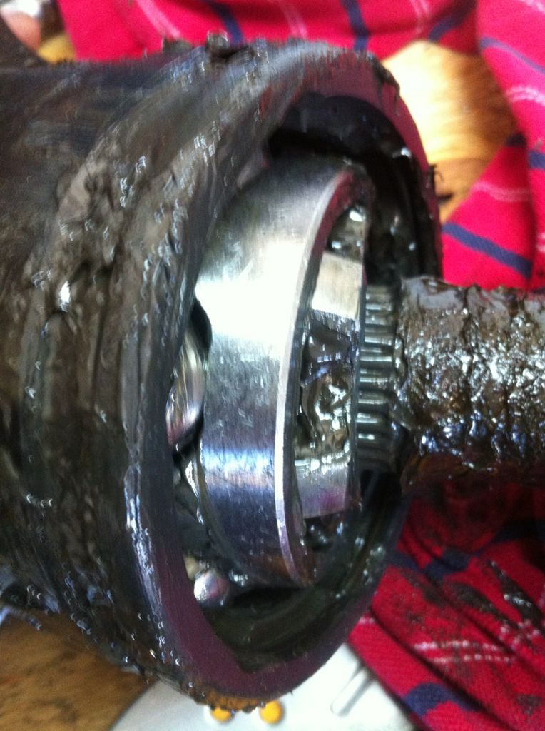

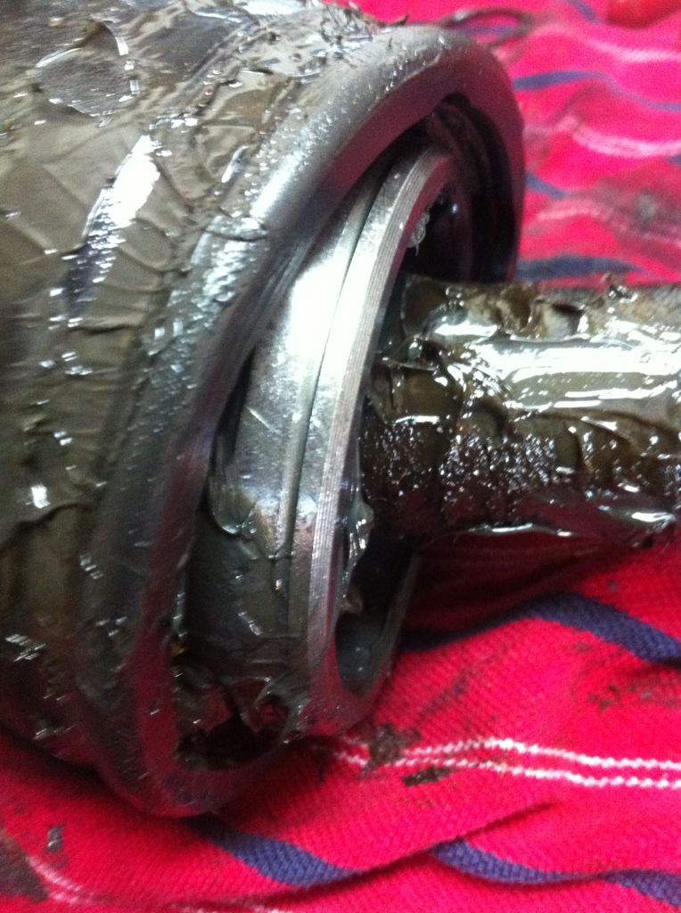

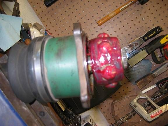

This is my question. The previous owner stated that he installed the "races backwards" does that mean that the snap ring groove on the "race" (im calling it) needs to be flopped around? this is how it is currently setup at the moment.

the second picture is the wheel side of the shaft. That side of the shaft is intact. The snap ring groove is on the outer most side closet to the wheelas you can see. Both of the races are setup in this configuration. Im wondering if they needed to be swapped from the get go? snap ring groove closer to the middle of the axle on both ends?
Edited by CrayZ
soooooooo basically which picture is the correct insatllion procedure?

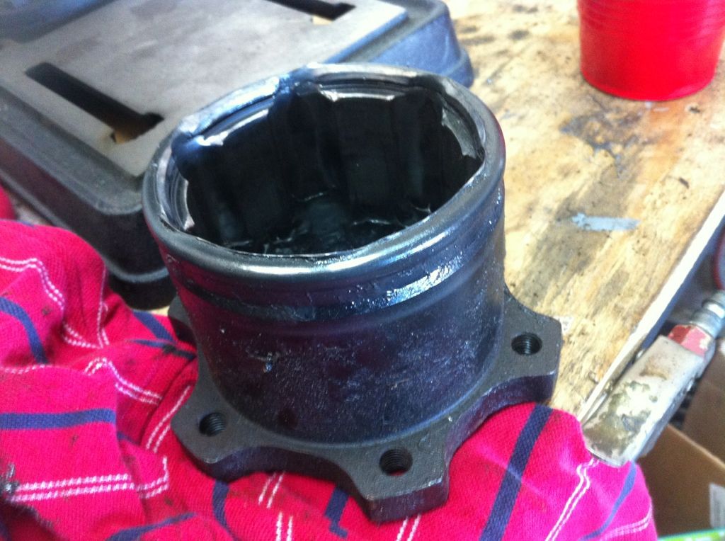

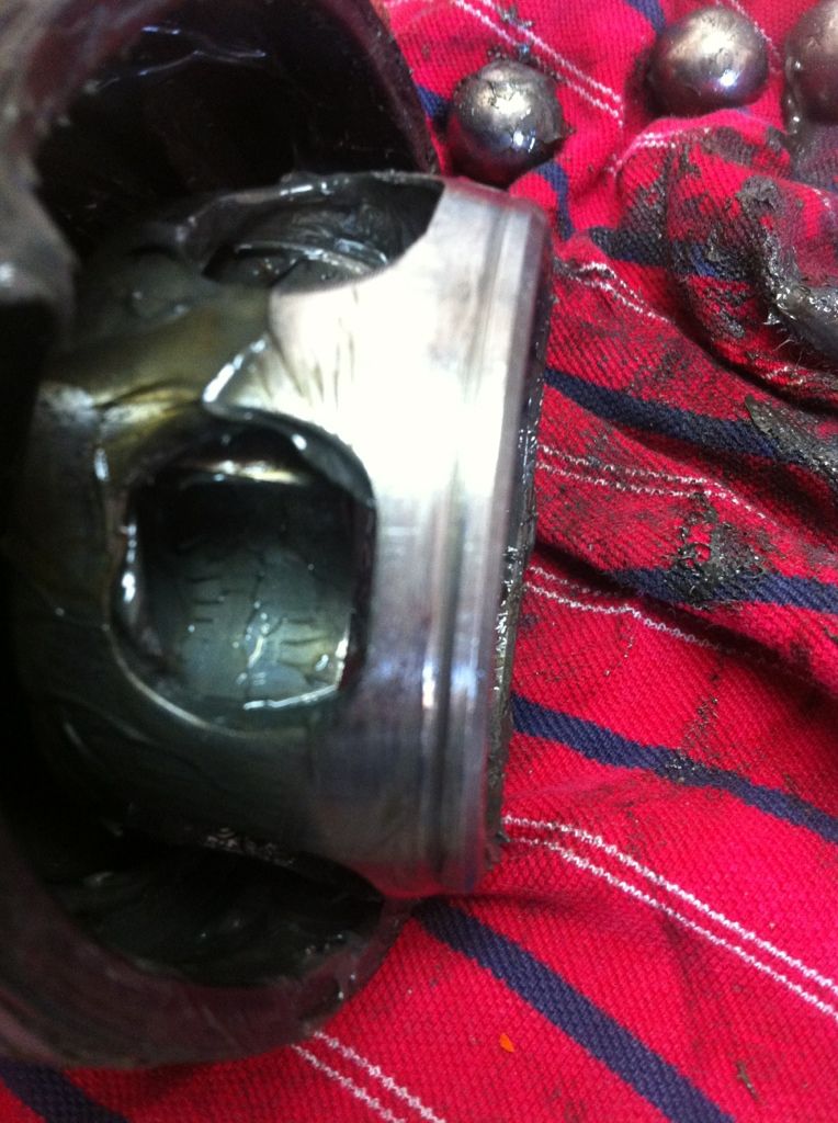

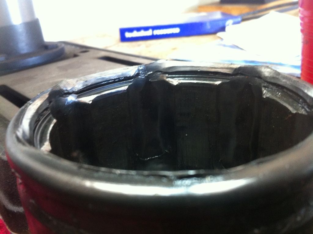

AND if it was wrong would it be the reason it looks like this?
000E4DC4-CF53-4C5D-B812-225060C2C240-211
I was not able to tell much a difference in legth from the two different ways i installed them. Thanks in advance guys.
I have this setup in my Zcar setup.  You do need to flip the cages to gain additional clearance.  My car is lowered with GCcoilovers and it's a real chore to get them in place.  Flipping the cages allows you the additional space.  If you have the MML setup you should have the "stops" endcaps that will allow the Axles to have less travel.  This would stop them from slamming into each end cap.

by flipping the cages you mean installing the cage with the embedded grove to the inside of the axle?

having some trouble with this setup tearing up the "cages" i think they are called. Im new to Z's and just bought this car, looking to get this squared away ASAP. thanks in advance.

Looks like the exact same problem I had when my axles were too short. It pulled out when I got on the gas real hard, and spun the balls and cage in the cup, just like your picture, and destroyed the cup.
My car is basically the exact same height as yours.
I'd bet you that axle length (too short) is where your problem lies. Check the clearance between the companion flange and the the CV cup where they mate, when your suspension is at full droop, and the axle is completely compressed.
Get that #, and report back.
Edited by SUNNY Z
how did you fix it? longer axles? i have already torn the axles out of the vehicle can i measure this with it out? The axle is right at 12" long by itself. And im sorry but my lingo with these suspension parts is non existent. can you give it to me in retard terms? *edit* when i suspend the assembled axle up and down making it as long as i could possibly be it measures 16" from one end of the cup to the other
