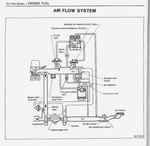

Im almost certain the AAC does affect idle AFR's.  I forgot to mention my EGR is blocked off (more specifically the pipe coming off the intake manifold has been welded shut).  at idle the 02 sensor is reading .3 V and i recently replaced it with a new one.
It might be a correlation, not a cause.  The attached diagram shows that the AAC only bypasses the throttle blade.

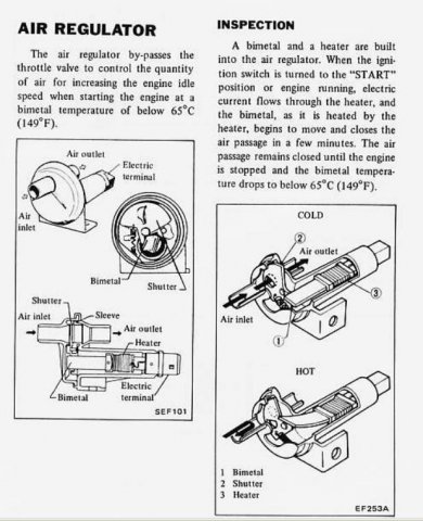

You are correct about the vcm controlling ecu through vacuum however the air regulator is what allows the air to get to the aac when vacuum is applied to it. The vcm only applies vacuum to te aac diaphragm, it doesnt supply bypass air
Directly
Oh, we're talking two different things.  The Air Regulator is a completely seperate device.  The A.A.C. does not get it's air supply from the Air Regulator.  The FSM describes the A.A.C and it's function in depth. The Air Reg. is supplied voltage by the fuel pump relay.  It has a bi-metal "arm" inside that moves a shutter.  It's wrapped with a coil, and when power is applied it heats the bi-metal which slowly bends.  As it bends, it moves the shutter.  As I recall, the shutter is open when the engine is cold to supply by-pass air and raise idle speed, then closes within a couple of minutes.  And, you're right, neither of these should be the cause of your overly Rich condition.

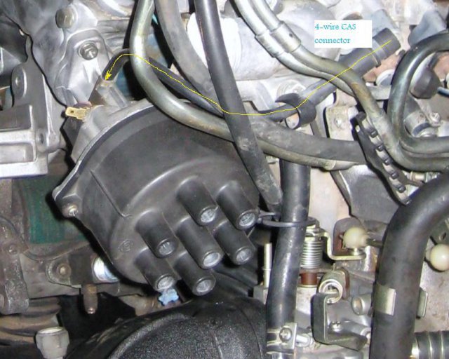

Also already asked this but can anyone confirm I have an 82-83 distributor? It has the 4 pin/prong connection on the underside of the distributor but nothing plugged in
Not the best picture, but this is what the '82-'83 Turbo Distributor looks like.  It has a 4-pin (spade) plug covered (normally) with a black rubber weather seal, and a bracket which is bolted to the dist. to hold it in place.  The wire is 10 to 12 inches long and connects to the ECCS harness just behind the thermostat - same connector that the external CAS uses...
If you unscrew the distributor cap and remove the rotor, you should see a metal plate covering the stainless steel optical wheel and the electronics that make it all work.
If you actually have a turbo dizzy, you need to get that thing hooked up!  You'll need the connector though.  If you don't have it, it may be tough to find another...

Not the best picture, but this is what the Turbo Distributor looks like.  It has a 4-pin (spade) plug covered (normally) with a black rubber weather seal, and a bracket which is bolted to the dist. to hold it in place.  The wire is 10 to 12 inches long and connects to the ECCS harness just behind the thermostat - same connector that the external CAS uses...
If you unscrew the cap and remove the rotor, you should see a metal plate covering the stainless steel optical wheel and the electronics that make it all work.
it appears I do have one. Although is the end of the black thing with the yellow line the end of the connector that actually plugs into the distributor?  And is that plugged in?  Im missing that but do have that little prong coming off the dist. as well as the 4 pin connection underneath
