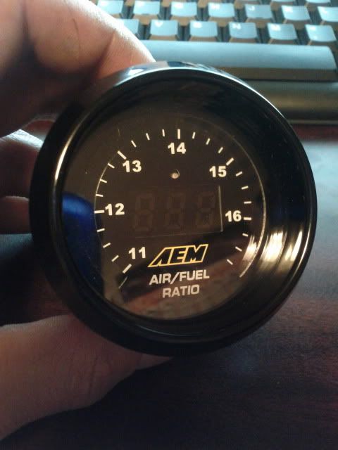

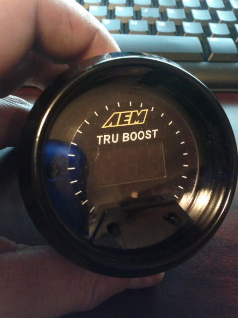

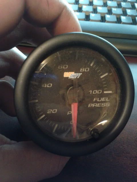

Got some gauges:

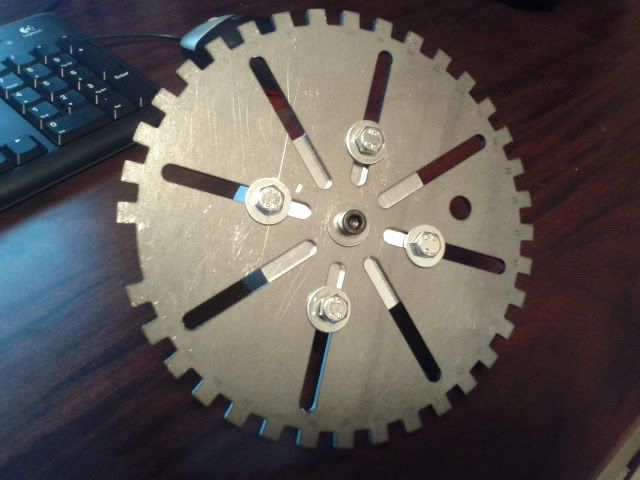

And made up a mount for my hall sensor trigger wheel:
Also been doing lots of wiring so the harness is almost done! Then i'll be trying to hook up all the other small wiring for gauges, ignition and some other relays etc.
