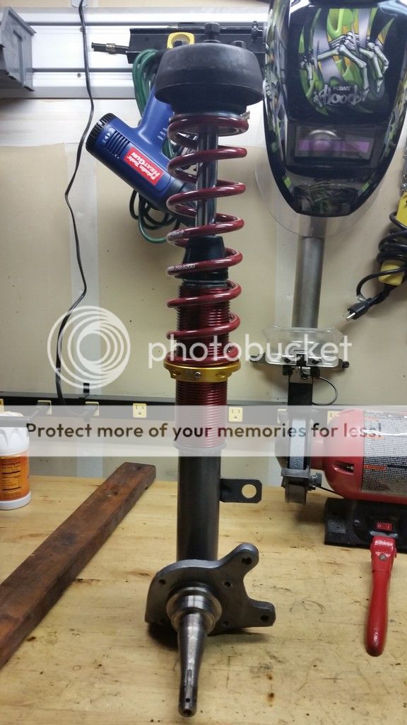

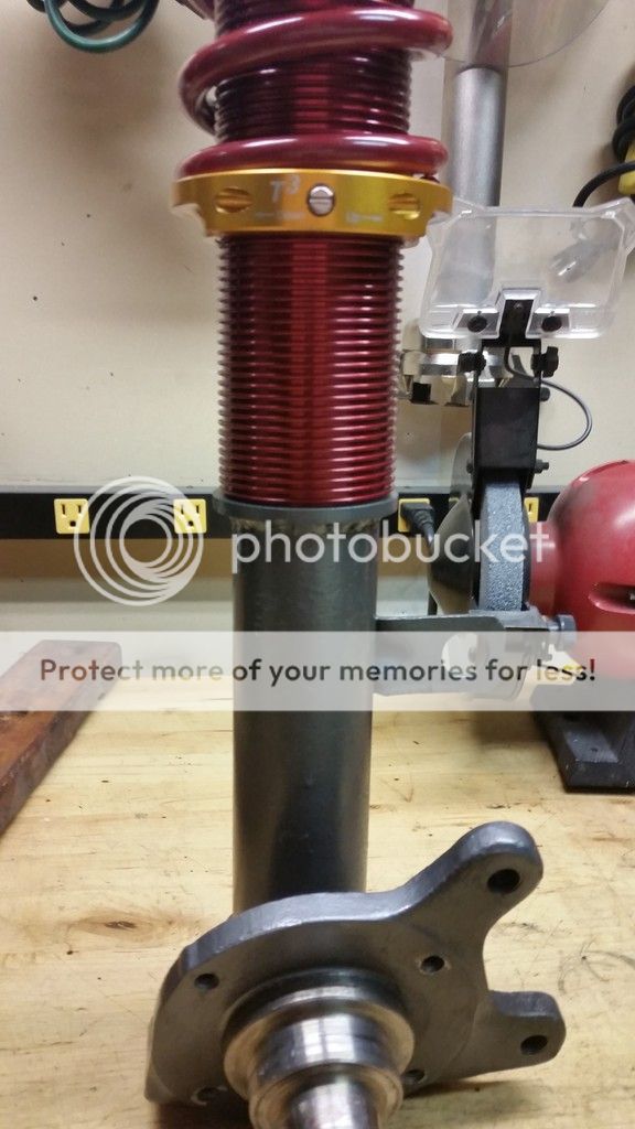

Sectioning is complete! Will sandblast and paint the struts as soon as time allows.
Once they're painted, I'll reassemble with fresh bearings and finally install the rear disk brake kit I've had lying around for about 4 years now. Really looking forward to actually having some bump travel!

The struts are ready to go in! Laid down some paint and pressed in the bearings and Nissan Quest wheel studs.
