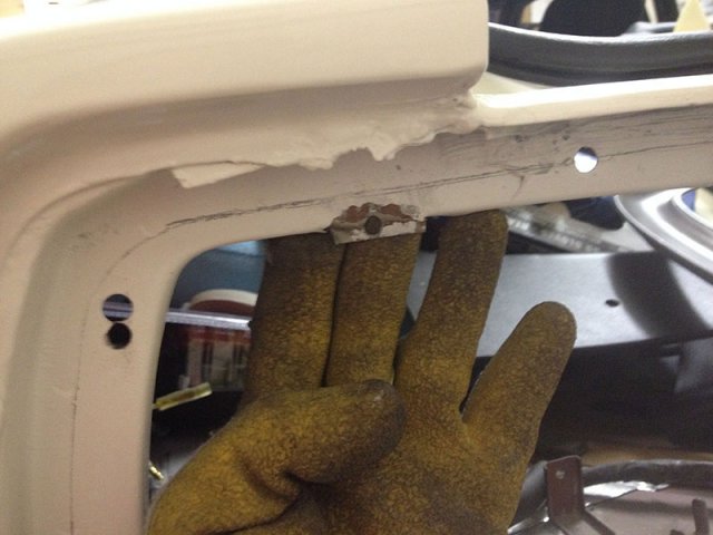

Working on the Lancer Evo8 seat swap.
There is one bold I could not remove for long time.
Finally, I decided to weld it and take it off!
Purchased 5mm thick flat bar at HomeDepot to cut to make a frame.
5a398d6cd8726_Photo17-12-1770950PM.jpg.835d9c9dd693367264aecb31a6339638.jpg5a398d6dbeda3_Photo17-12-1771301PM.jpg.21e4142a667a6420cf18a35262e9f996.jpg
And drilled M8 size hole.
Installed the flat bar.
In order to mount original '75 280z seat rail, I need to drill a hole on itself to adjust.
Share this post

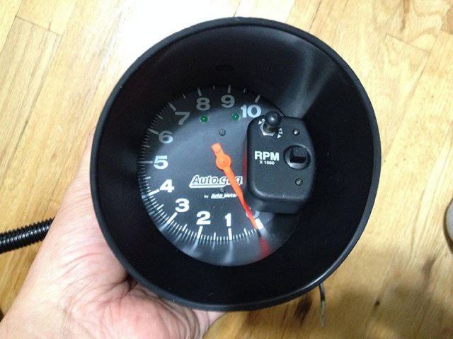

Electric Mod is done.
  • Install Moded Autometer Tachometer with shift change light
