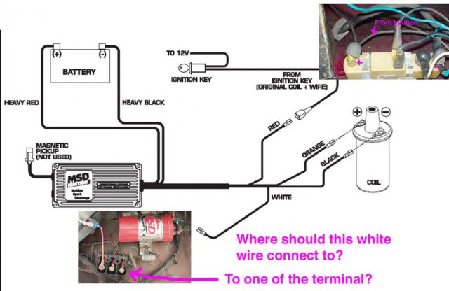

So, I connect MSD 6AL.
Attached File  MSD6AL_wiring_diagram_280z_11.jpg   90.71KB   0 downloads
Still not get spark.
I wonder where I should connect white wire? Should I connect to terminal?

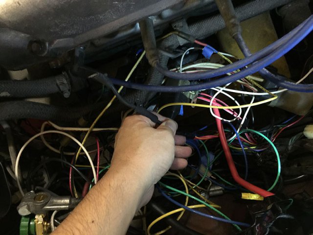

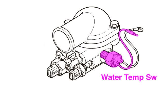

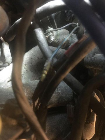

After search root causes....
I fount Water Temp Sw cable was broken.
Attached File  thermostathousing.jpg   37.87KB   0 downloads
Attached File  IMG_3560.jpg   43.7KB   0 downloads
I thought both connector was connected to ground somehow I soldering it.
and replacement parts is not available.
But it's not MUST Have parts. So, I disconnected them.
http://www.classiczc...rums-for-hours/

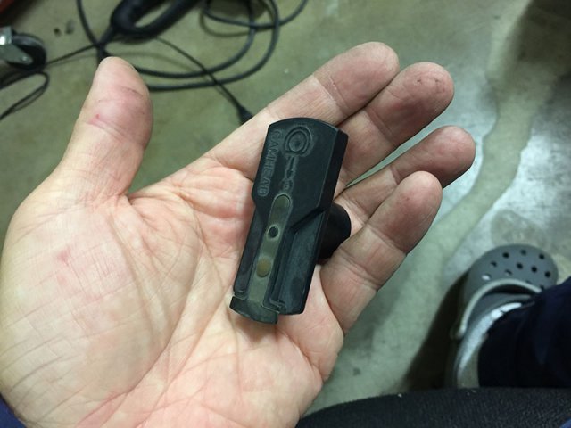

The root cause was simple. but it was hidden ... mistake....
Attached File  IMG_3564.jpg   76.71KB   0 downloads
I just forgot to put dizzy rotor.. Woops!
https://youtu.be/omjroLNtqNk
Finally engine runs!

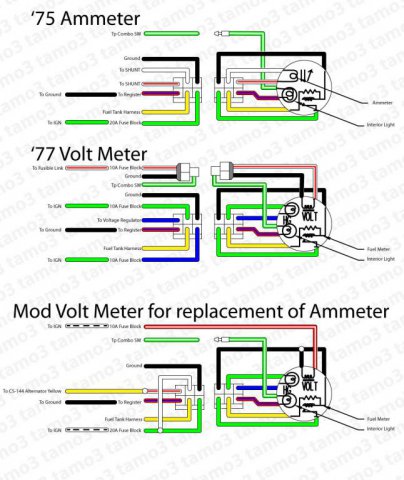

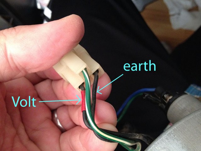

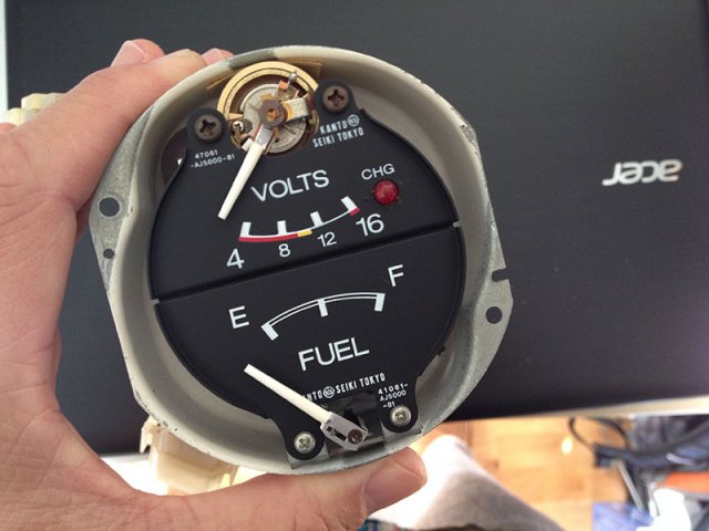

Working on Ammeter Voltmeter swap.
Attached File  IMG_7028.jpg   81.21KB   0 downloads
Attached File  IMG_7038.jpg   59.31KB   0 downloads

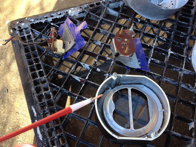

Rip the case and clean up.
Attached File  IMG_7043.jpg   185.86KB   0 downloads
painted inside chrome silver.

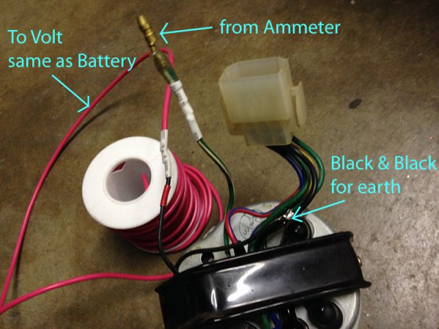

Attached File  Ammeter_Voltmeter_wiring.jpg   84.13KB   0 downloads
'75 Ammeter and '7? Voltmeter swap diagram.
Attached File  IMG_7035.jpg   78.06KB   0 downloads
Attached File  IMG_7117.jpg   107.16KB   0 downloads

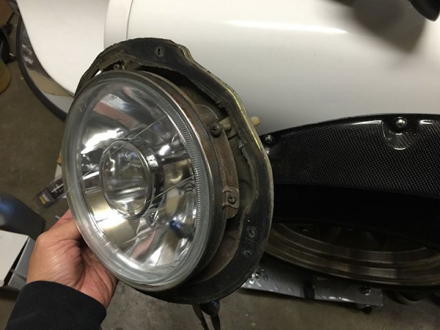

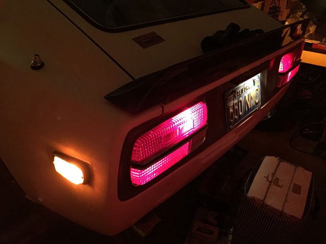

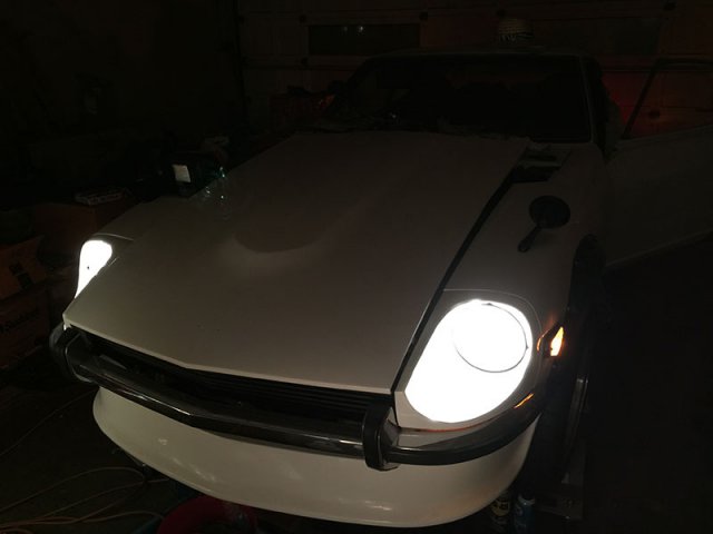

Brake light can be turn on, bur somehow headlight never turned on after headlight relay installed.
Attached File  IMG_3437.jpg   69.08KB   0 downloads
I opened up headlight mount again to check whether light bulb issue or not. It's painful to access to headlight bulb.
I need to remove side light.
Attached File  IMG_3425.jpg   71.08KB   0 downloads
Attached File  IMG_3426.jpg   78.82KB   0 downloads
But light bulb is not the problem.
Attached File  IMG_3434.jpg   102.08KB   0 downloads
I forgot to connect ground....
After that, headlight works!
Attached File  IMG_3435.jpg   36.86KB   0 downloads
Attached File  IMG_3438.jpg   65.51KB   0 downloads
But I can turn on headlight without key....

Most cars even modern ones have the headlight circuit active without the keys. You can disable it by making the trigger pin on your relay ignition dependent.
I've had to use the feature once when I was younger and phones were not ubiquitous, dark night no street lights (grass lawn used for parking at the firework show), went to go grab something from my parents car, dropped the key on my way back before I hit the door lock on the remote. Went back to the car and flipped the headlights on to find the keys, then turned off the light and locked the door with the remote.

Thank for your comment. Actually, I was afraid of I made mistake for wiring. Friend of mine told me this is expected behavior of Z :-}
