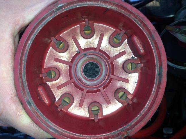

Here is a pic of inside the distributor cap.. I'm pretty sure its not supposed to look like this. It looks broken in the middle and i think i can see the little copper button down inside the distributor.

Yup, the center pin in that cap is toast. Just go to your local parts store and get a new cap & rotor. Put everything back together & see if it works. If not then pull the center wire off hold it 1/2" away from the block and have someone else crank the motor whiel you check for spark. If no spark it could be bad coil or worn points (if you have them). No matter what you will need cap & rotor.

I was thinking the same thing, but the cap looks bad and is broken anyways... Im not sure if it is possible to have 2 failures at the same time, but I need to get a new cap anyways.

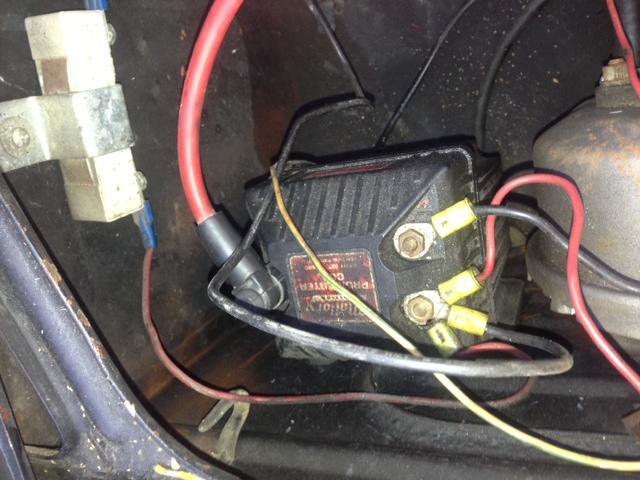

Here is a pic of my coil.. It is a Mallory Promaster.  I need to check the part number to be able to tell you what kind it is. Is an HEI distributor better in any way?

Before you waste a lot of time and money,  you need to methodically go through the primary and secondary ignition system components. Do you have a Chevy Haynes manual that covers the SBC  engine? You will need one if you want to properly diagnose problems and maintain the engine. Any Chevy manual for the year of the engine you have will work.
In addition to the cap, have you checked for voltage at the coil?  If you have a spare coil you can swap it in to see if it improves anything.
Yes the HEI is an improvement, but make sure that you just don't have a points, loose wire or power problem after checking the coil and replacing the cap. Note that the HEI may require more space so check your firewall clearence and your stock Tach will not work with the HEI distributor.
