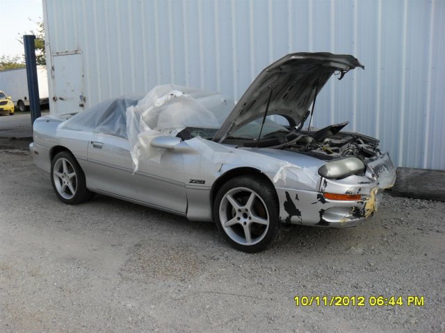

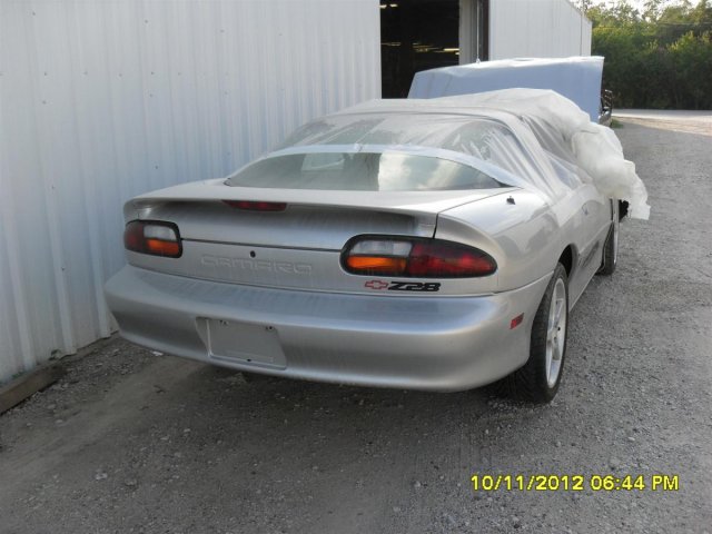

   I have been buying/building wrecks for years and let me say that you won't "steal" a donor car for your drive train!!! at Crashed LS cars bring a war pension everywhere. I feel like I did pretty good on my donor @ $2400- a 2002 Z28 6 speed with 67,233 actual miles. With sale fees and fuel to pick up I had $2900 in the car sitting in my yard.

My project is very similar to yours . Fortunately , the Z28 i bought not as bad as yours . I use full Z28 driveshaft with JTR adapter , shortened and balanced costed me $85 ) . Here's the Z28 i got for $1900 ( 60k miles ) , after taxes , fees = $2500 . Sold the car for $725 and still have wheels , tires , and a set of full length ceramic coated headers ( haven't sold them yet ) . I reworked the OE harness with Ebay ECM ( $125 ) .
