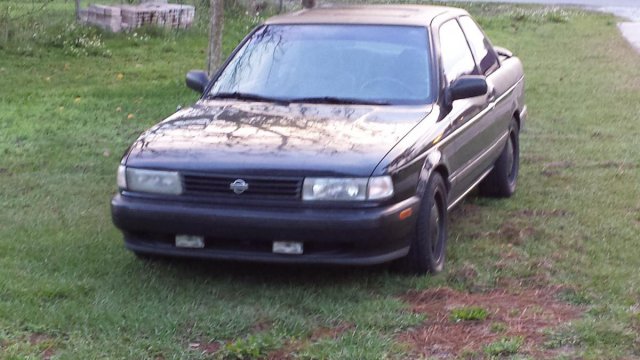

So we finished the turbo install, new blow off valve, new fuel system(fuel cell, fuel pump, fuel filter, fuel rail, fuel regulator) new intake(cold air in front of the radiator), new Odyssey pc860 battery relocated in storage bin behind passenger seat and replaced the 96 pass oil cooler with a 10 pass smaller one. Yahoo!
We flushed the fuel system to get the possible junk out of the lines and proceeded to check pressure of the fuel system. Dang plug in the fuel regulator leaked. So had to find one -6 fitting. Found one at Pep Boys believe it or not.
So time permitting fire her up this week, I want to rally cross race it Saturday in Macon Ga.
Hoping for 300+ hp and better driverability.
