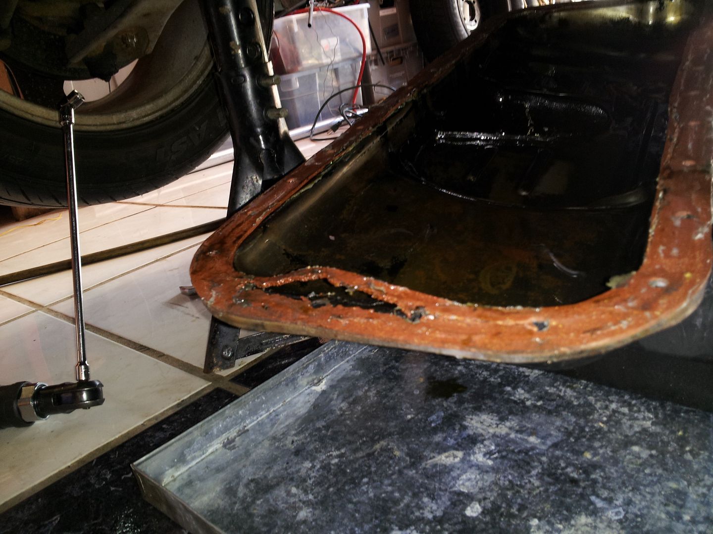

While I am waiting for the AFM, I am pulling the oil pan to redo the turbo drain pipe(was leaking anyways at the front 2 bolts under the oil pump) Have a -6 and going to go with a  -10 (3/4 ") inner diameter. Should be overkill but dont want to do it again.

Also can't tell, but did you use rtv on your oil pan? It helps a ton when you tighten it down.
Did you already weld the -10 fitting on? You're probably going to need a 45* off it and then hope you don't get any binding. Ideally you should have run the -10 in the same spot (or close) as the -6 and run a 45* right off it straight up to the turbo drain.
No rtv, my dad has always used clear 100% silicone (fish tank stuff) He says that the thermo range is like from -80 to 550 F. He uses it on all his VW air cooled stuff. Always jokes the they VW bugs always mark there spot with a leak. He seals the engine case halves together valve gaskets, tranny cases. Everthing except exhaust stuff. Looks cleaner and is easier to clean up. I just overtightened the gasket, it only leaked at the front where the 3 stud holes ripped the gasket apart. The rear was as bad but did not leak there.
Yeah pilfering through my dads assortment of fittings, I have 2 90's, 2 45's.
