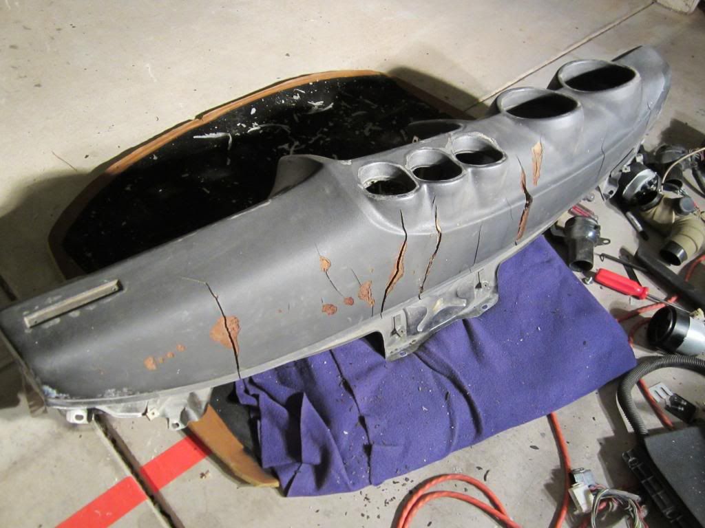

Peeled of the dash cap to see what was underneath.  I almost gave up immediately -
I started picking at the rotten foam -
Using a Dremel I beveled out all the cracks flush.  This is the most important step.  Some of them I had to bevel out several inches.  Any crack I could pick material out of I dremeled out.  At the end of all the small cracks I drilled a circle so they wouldnt spread. Stupidly I didnt get any pictures of the beveling.

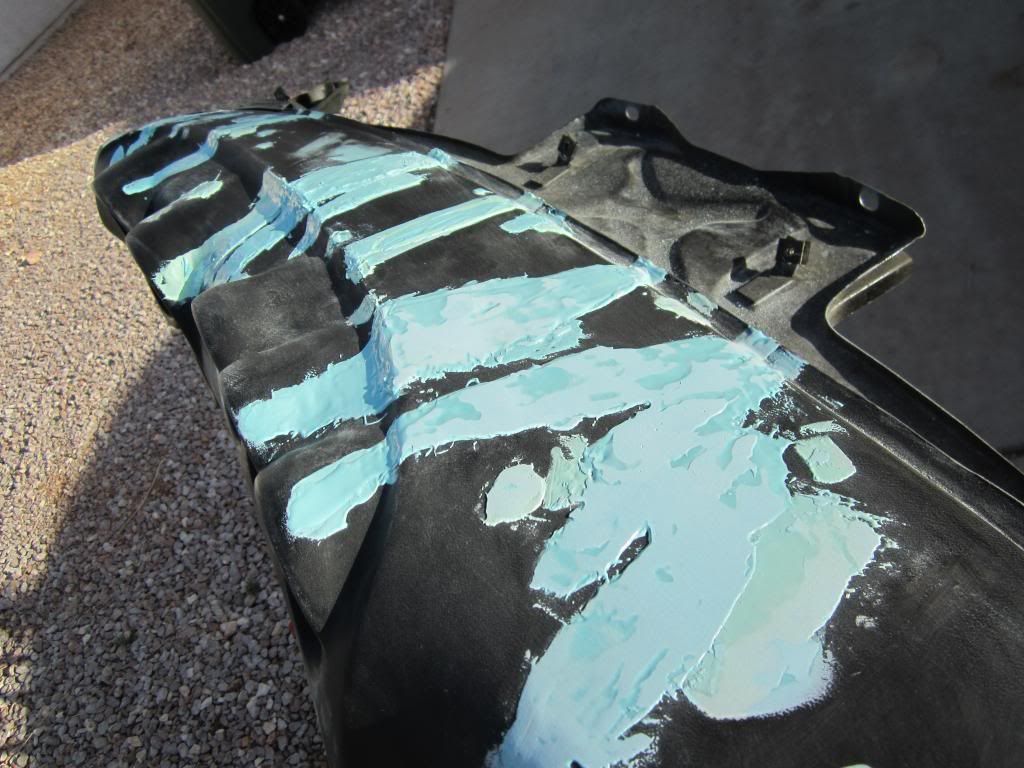

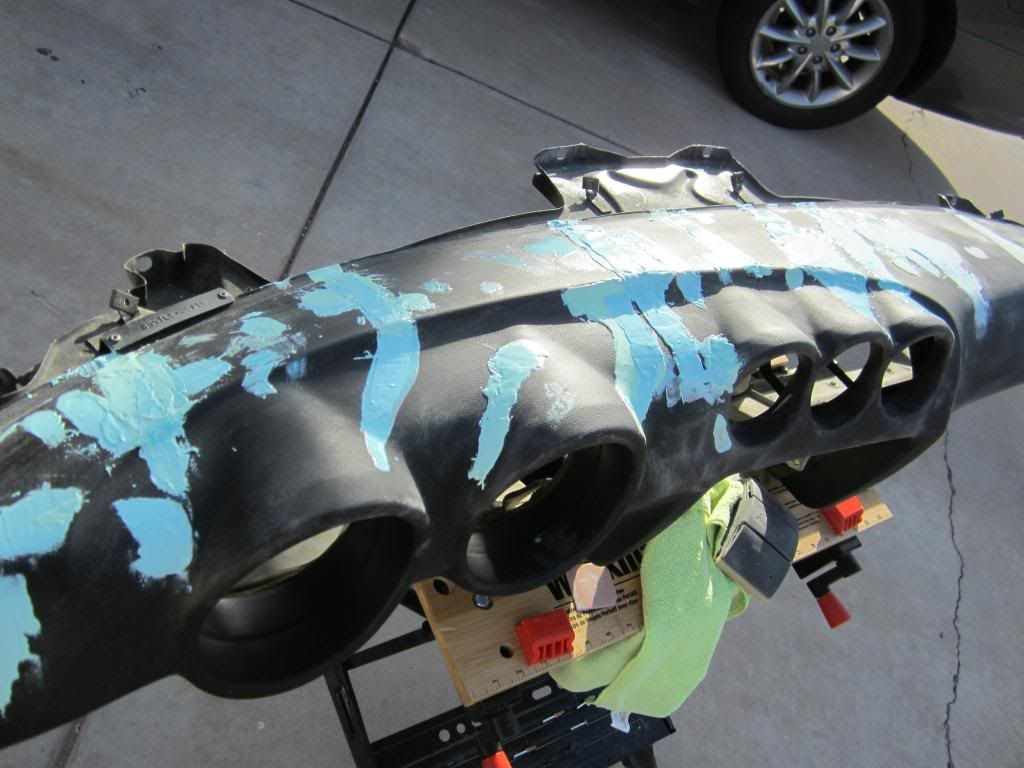

I then had to fill the cracks. First I tried the expanding plumbing foam but it sucked so I dug it back out.  Then I tried this NAPA bumper repair kit.  NAPA doesnt make this anymore but theres a guy on ebay selling it.  I ordered two kits but only used a little of the second one.  It says its flexible but it dried very hard -

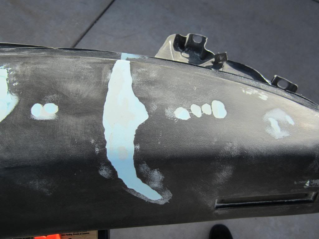

This is what it starts to look like after sanding on it -
I had to sand it down and feather it using a sanding block and my fingers.  It was a pain to sand and took me several days.  I used 80 grit to knock it down then 100 for most of it shaping the lines and contours.  After I finally had it contoured and sanded smooth I left it in the 90 degree sun for a couple days to see if the material would change shape but it didnt budge.  So then I sanded the entire dash with 200 grit, wiped it down with wax and grease remover and then taped it off.

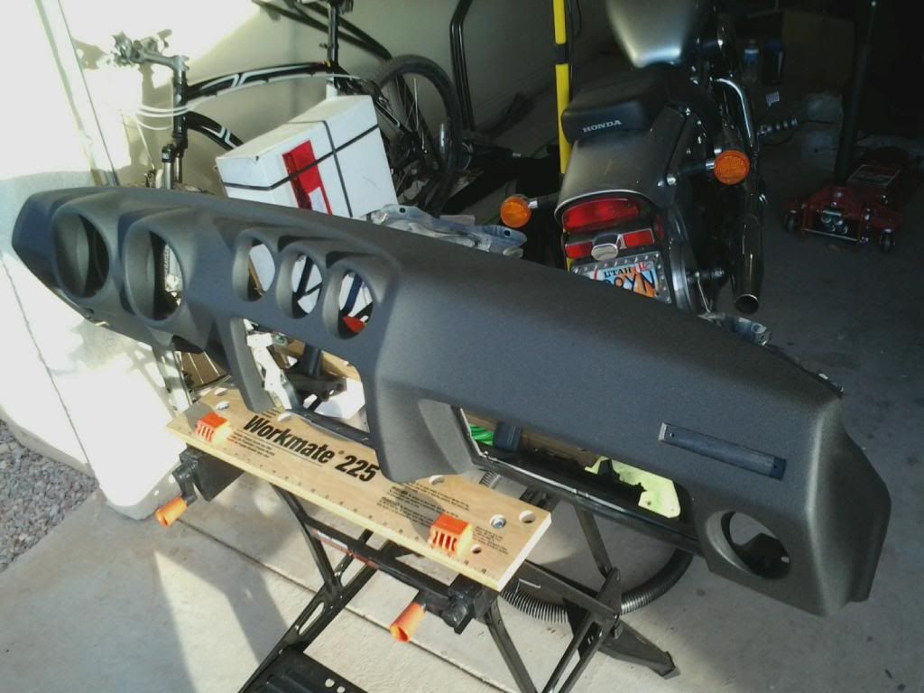

I used Duplicolor truck bed armor from Autozone for the coating.  It dried tough and has a nice pebble texture to it.  I first bought Rustoleum truck bed coating from Walmart but didnt like the way it sprayed out on a test panel.  I used a full can of the Duplicolor, 4 coats -
Final -

Yes bevel everycrack down and out so its a little lower than the good areas around it, so when you fill it and sand it down its all even.  Mine looked like Vs but curved way out at the tops. I took out bad foam but it didnt go very deep until the foam changed color into good foam.
If there are any pinholes left in the bumper repair after you sand it down, fill them again or else they will show up when you spray the bed liner on.  The bed liner wont fill them.
