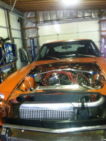

This was a CX racing intercooler, it keeps temps about 10 degrees above ambient temp.  Its a little larger than i like but posted it more to show how we installed it.  We used an intercooler with the inlet outlet on the same end and went into the core support through existing holes so I didn't cut the body of the car at all. Also, the way its mounted I used exhaust hangers and bent/welded them so the intercooler actually is suspended on the rubber mounts of the hangers. I haven't had any issues with boots ripping or stretching and its been on there a few thousand miles.  I will end up using a smaller intercooler later on, this one is way too big for what i'm doing.
