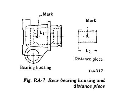

 Anyone have more details on where to find the mark on the upright?
I located the letter on the top side (as it sits on the car) of the bearing housing, right about where the spacer fits inside. They were hard to see until I put a wire wheel to use, cleaning paint/road grime off...

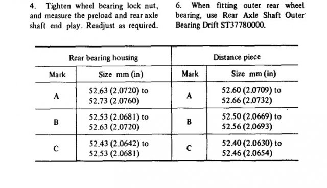

So, while measuring the spacers and the housings (both marked B, I found that spacer is right in the middle of the allowable specification (2.068) and the housing is near the maximum tolerance (2.072).  I plan to assemble everything today with  bearings and see what kind of axial play I end up with.  If I still am unsatisfied with the result, I plan to have some new spacers made at my local machine shop.  From measuring the existing spacer, I found that the OD is 1.782" and the ID is 1.310" .  Available 4130 tubing comes in the following sizes from aircraftspruce:

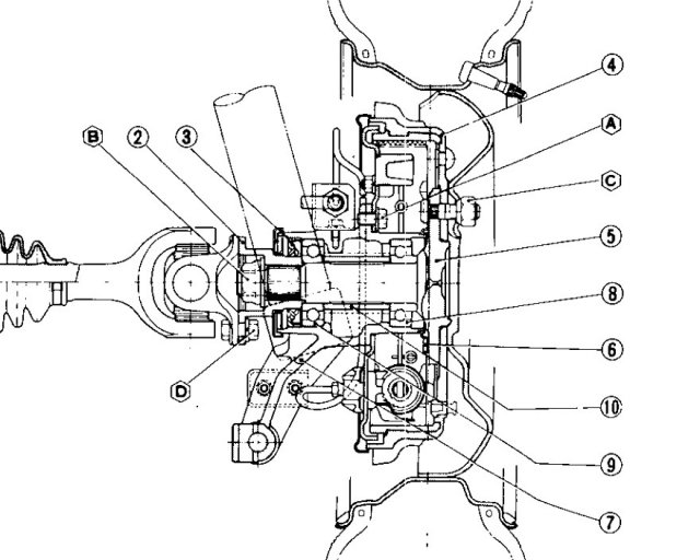

If you look at the attached drawing you'll see that the seating area for the outer races is in line with the inner races.  I think that the distance spacer is meant to match that outer racing seat distance, to center the balls in the races when everything is assembled.  You wouldn't want the balls riding on the sides of the races since the loads on them shift from side to side and up and down.  If I was starting from scratch or "blueprinting" my struts I would measure that area, from outer race seat to outer race seat, on each strut and make the "distance piece" match it.

Thanks for correcting me.  With that in mind, and a little more digging in the FSM, you'll find that all of the information needed is in the Rear Axle chapter.  L1 and L2 in the drawing, numbers in the chart.  With the measurement tool of your choice you don't need the letters anymore.
Not to argue, but it looks like with tolerances there's a lot of overlap, but the goal (blueprint) might be to have the strut housing ~.010 - .020" bigger than the distance piece.  Just looking at the numbers.  Really though, they look pretty sloppy and essentially just centered.  Maybe those are just starting points and the "adjustment" procedure that Nissan never describes, to get preload and end play, is what sets the final distance.  If adjustment is nut torque then there's some compression of the distance piece,  If they mean disassembly and adjusting piece distance then there's more labor involved.

My starting condition was that both rear wheel had excessive play, so I replaced all four bearings.  While in the process of replacing the bearings I re-measured the spacers and the housings.  Here is what I had for both sides:
                    Left Side                Right Side
Spacer          2.066                    2.068
Housing        2.068                    2.072
