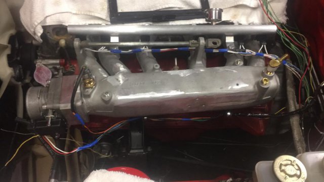

Okay guys-finally moving on to the fuel part of this install. Going with a N42 , 240sx TB and Bosch 26lb High impedance injectors. Just wiring up everything right now , no fuel pump hooked up yet. So my first question in this part of the install is settings in engine and sequential.  Trying to get the required fuel number correct but the injector staging choices confuse me. I am NOT sequential (yet), but it doesn't really ask you that. So am I alternating with 2 squirts per engine cycle?
My goal is to test my injectors to see if I wired them correctly. Might need help figuring what MS to put in for testing.

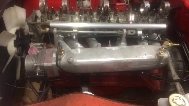

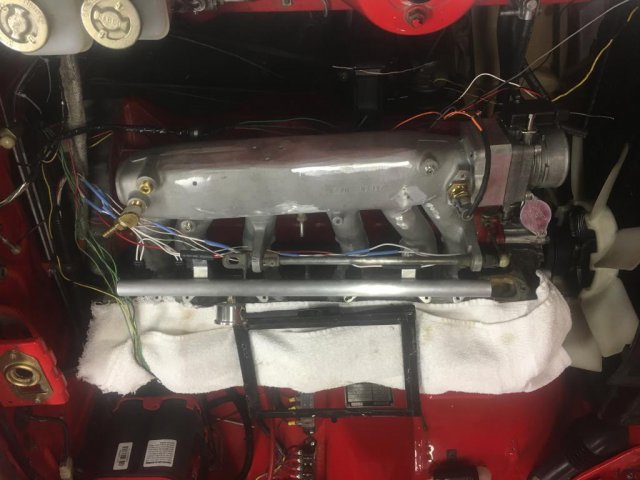

Got most everything wired up and in place. Most items are working but still need to place thermistor for the coolant. My coil brackets in the way of the OEM CHT. Thinking about drilling and tapping out coolant passage between 5&6. Its already marked for me on the mn47 head . Need to get connector for my cam sensor so I can get it installed. Probably run batch fire first to get engine running.
I replaced one of the sensor on the bottom of the thermostat housing for coolant temp sensor. If you're out of space there, you could get a spacer in the upper radiator hose that has a bung.
For an IAT sensor I welded a bung into the center of the bottom of the intake (between the #3 and #4 runners) and it seemed to work pretty well!
EDIT: Looking at where you've got it located, I imagine you'll be all set. It might not react to the manifold heat soaking as quickly, but it should be ok!
Edited by Ben280
For your CLT, it sounds like you are describing how the P90 CHTS are. If I remember right it is a cavity that does not touch coolant. (I have only been around a MN47 once when it was stripped down)
A few things, having the temp location will show hotter there at the back of the head vs the front of the block near the thermostat, so keep that in mind. I have mine hooked up in the thermostat housing, you can use the stock 280z housing if you have access to one, it has three sensors, and you can easily use the stock sensor and update the therm values or the GM one using a 3/8 pipe tap.
Your IAT is fine, I personally like it right in-front of the throttle body. I have ran it in both places, no noticeable signs of heat soak to the point of hot starts behind though.

I have one of those bigger thermostats somewhere , but was trying to avoid using it with all its plumbing, but I might reconsider. I thought at the back of the head might be more accurate . I have a spare mn47 that I am cutting up so I might experiment with drilling it . Curious to see any possible casting issues in that spot as noted in other threads.
Were you planning on running a cylinder head temp sensor versus a coolant temperature sensor (P90 CHT in head vs thermostat mounted?).
I asked this question previously, the outcome was that they will both do the job, but the cylinder head sensor gives a slower read out on temperature changed.
