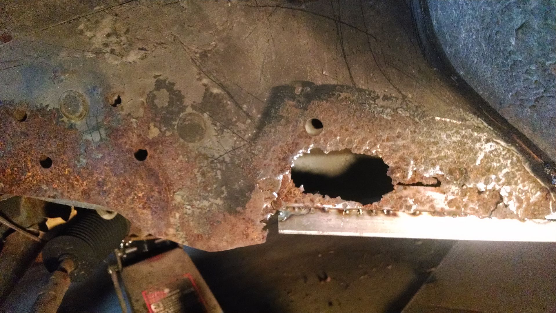

Thanks, yeah, this one is pretty rusty. Luckily I've got nothing better to do in my spare time during the winter. I'm excited to daily drive the car in the spring. It should scratch my itch to drive a Z, as it's been a couple years since I've had one going on the road now.
Thanks again for the encouragement. I appreciate it.
Today I went out to buy...
"Seam sealer"  :lol:
3.50 a tube. I bought two. Have used one. $7.00

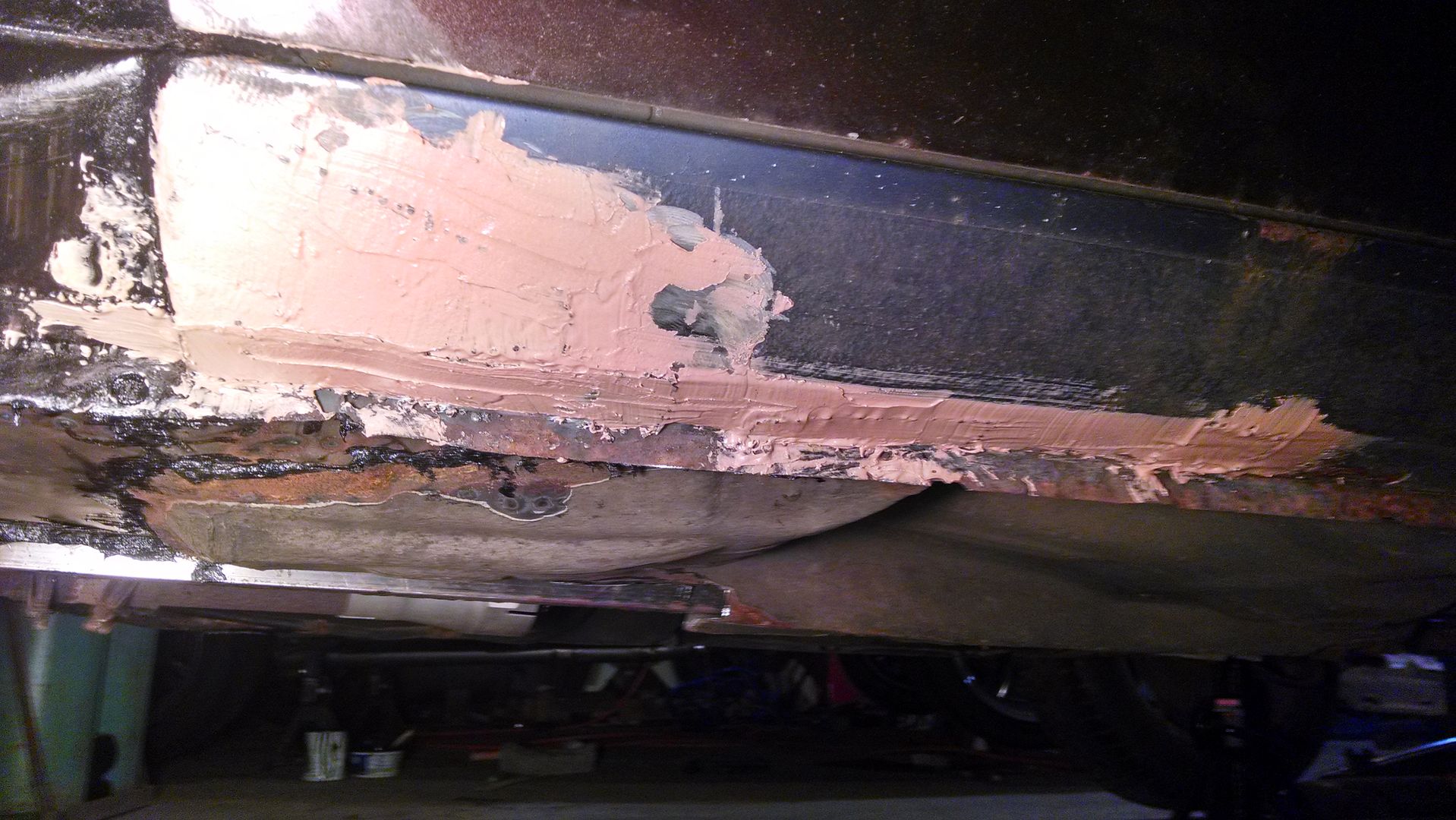

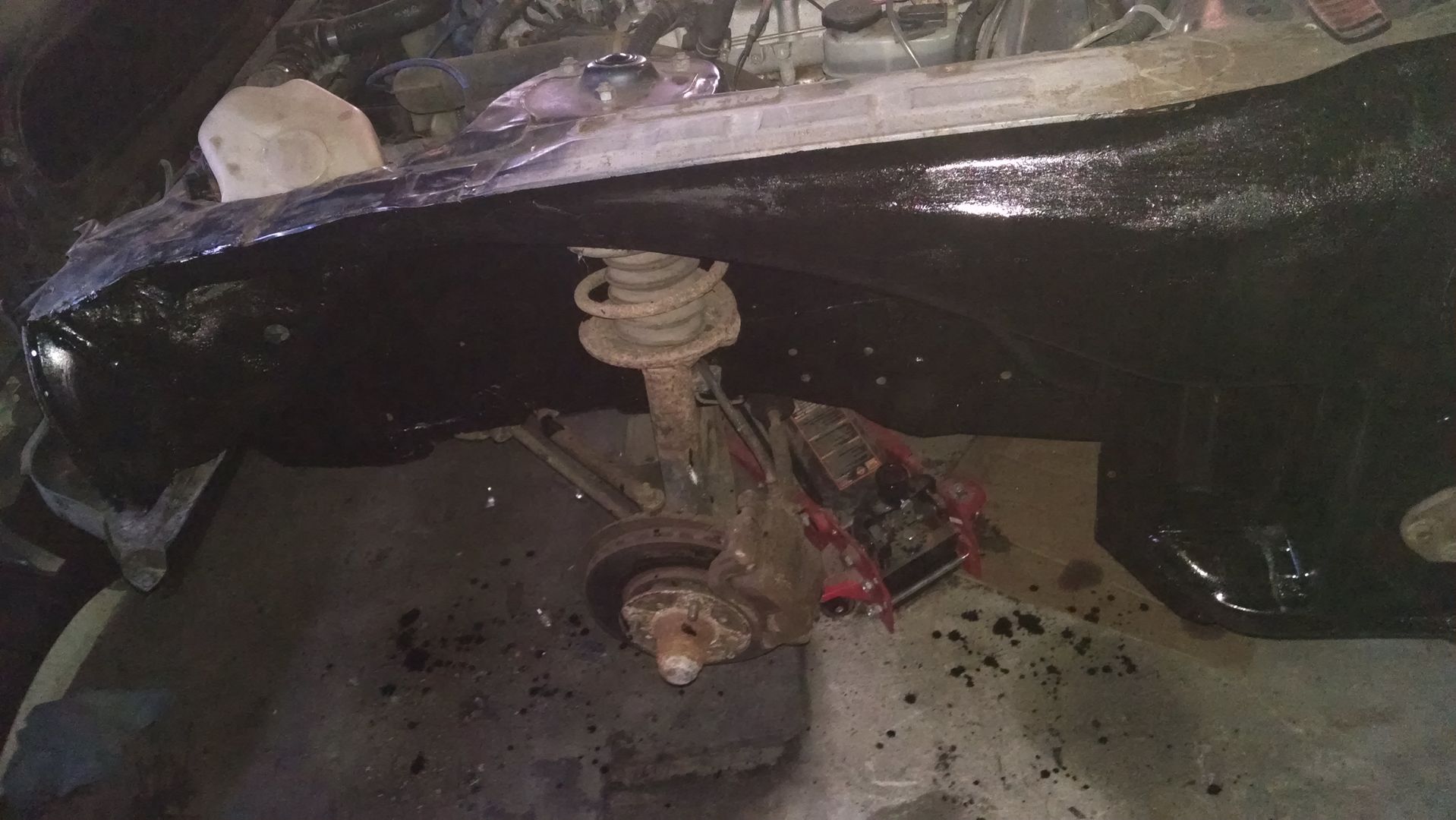

Here's some pictures of today's patch o rama. Using up every last bit of scrap I can manage. It's kinda funny.
IMG_20140316_132642347_HDR_zpsrj0knwbx.j
Then after a little seam sealer was applied and allowed to do it's thing. I got to put together the passenger interior, sans door jam trim pieces.

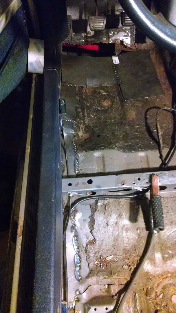

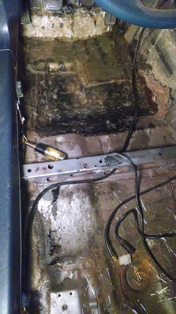

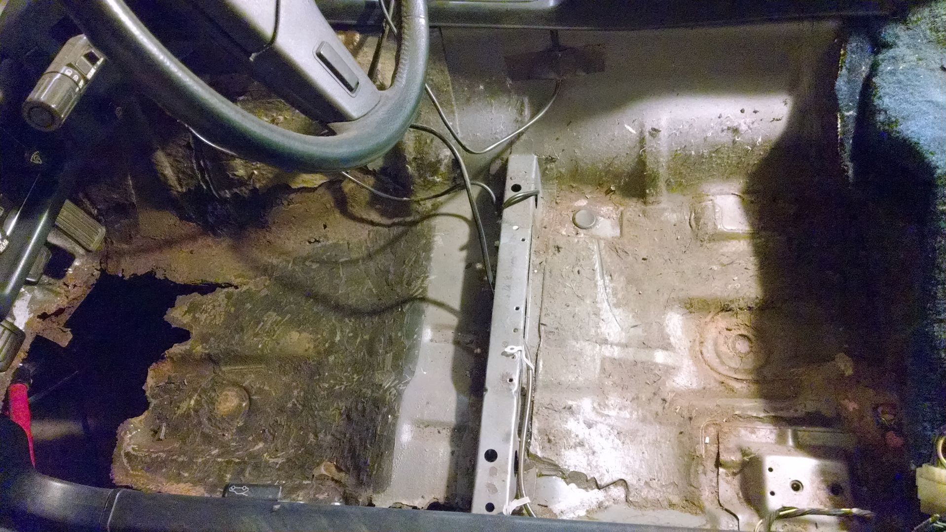

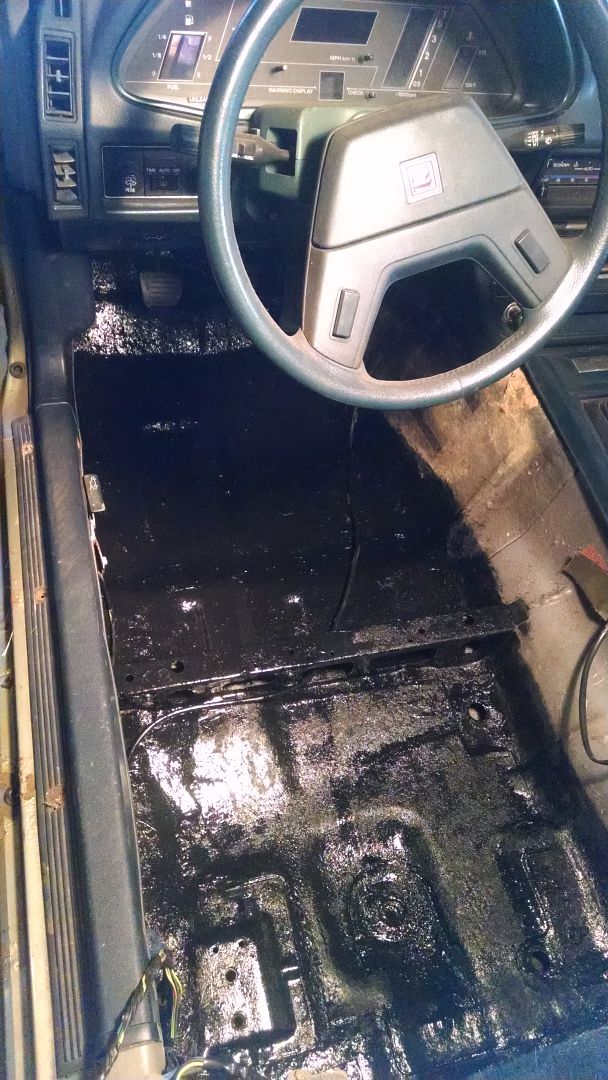

Tonight I was tired, but I managed to strip some of the drivers floor sound deadening. The driver's floor, as to be expected, was a little more worse for wear than the passenger's. However the driver's rocker panel is in tact, so I don't have to fix that at least.
PM me for any composites related inquiries.

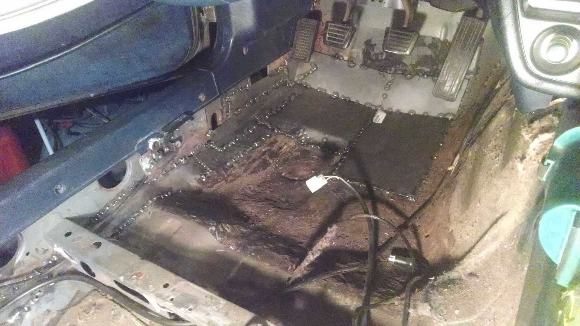

After work today. Got to a good stopping point. Lots of work left to do.
I'm tired. I'll try to finish it up tomorrow evening. Goodnight.

A little more tweaking this evening after work.
Pretty much there.
Ugh..The end is in sight!

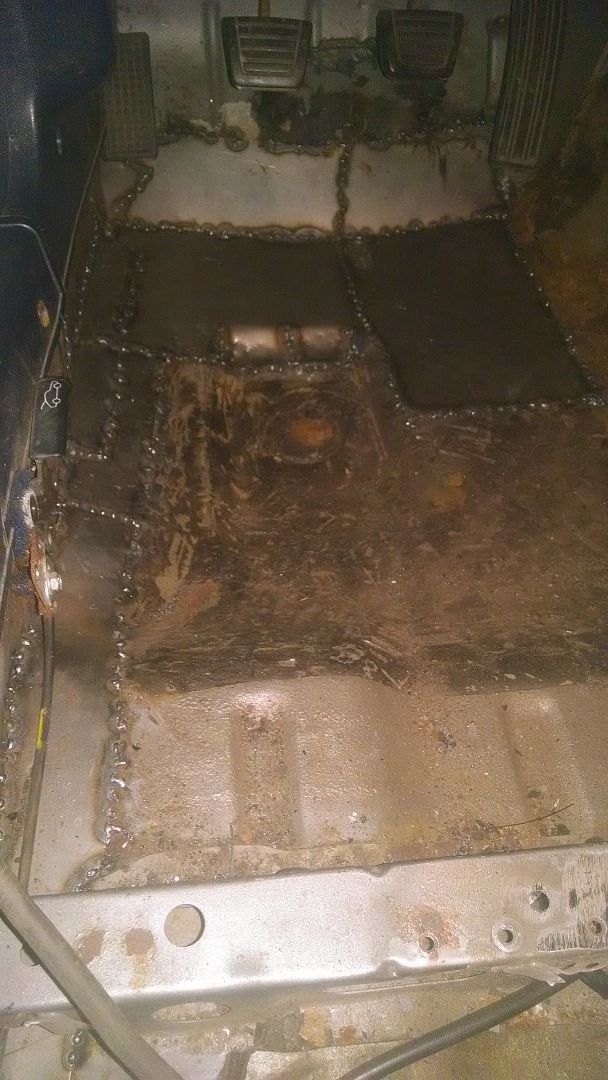

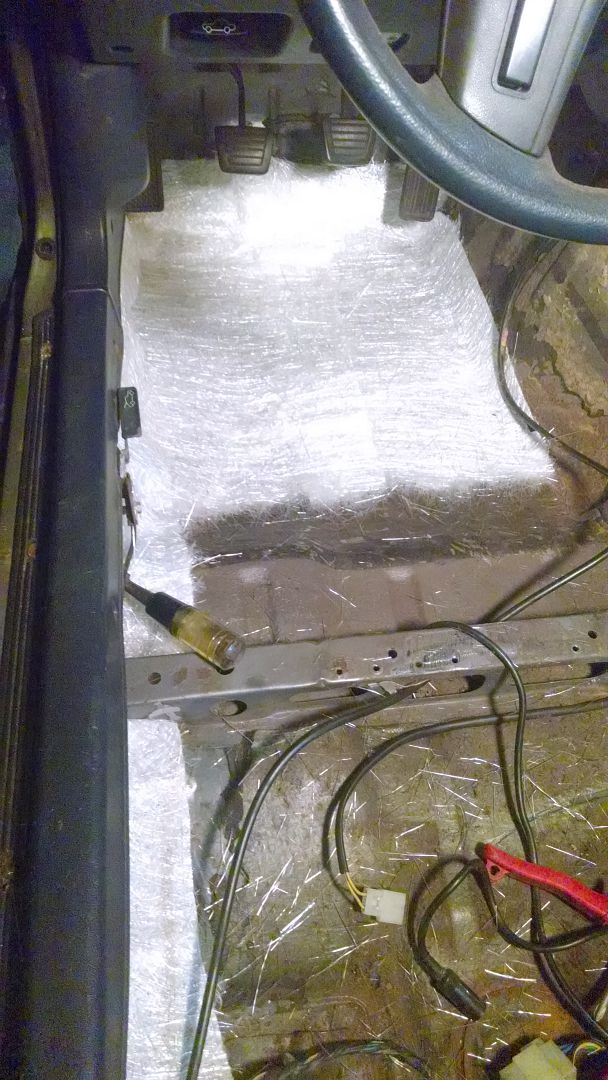

Laying in the chopped strand mat, confirming size.
And some polyester resin later...Somewhere mid laminating. Tons of air. Again, we're talkin' quality here :P
Tomorrow I paint the floor and continue with the last few remaining spots left to patch up.
I feel the hard stuff is now behind me.

May I ask, why the fiberglass? I thought fiber was a cheap way to make the floors hold shape when they are rusted through, and you put in so much effort repairing them.
#29 OldAndyAndTheSea
OldAndyAndTheSea
    Can Charge Rent
  • Members
  • PipPipPipPipPip
  • 759 posts
  • LocationHenderson Harbor, NY
Posted 21 March 2014 - 03:01 PM
A couple reasons.
First being, I had the resin, and polyester resin is ALWAYS in a state of curing, so I needed to use it.
Second being an attempt to seal out the moisture from the top down. Seam sealer on the underside will do the same for the reciprocal.
Plus I figured it couldn't hurt.
It's defintiely not for strength. That's in the repair. This is mainly to keep the water from my shoes off the metal below.

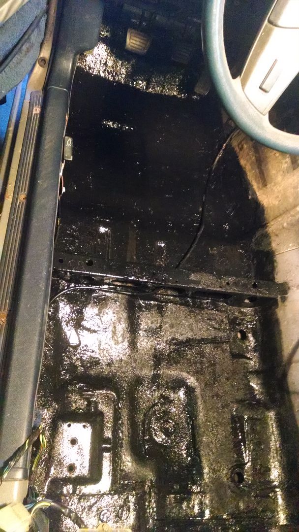

So far today..
Got home from work. Went out, prepped, and painted the floor. Bottom is sealed.
Grabbing a bite to eat, then heading back out.
It's the weekend. It's car time!

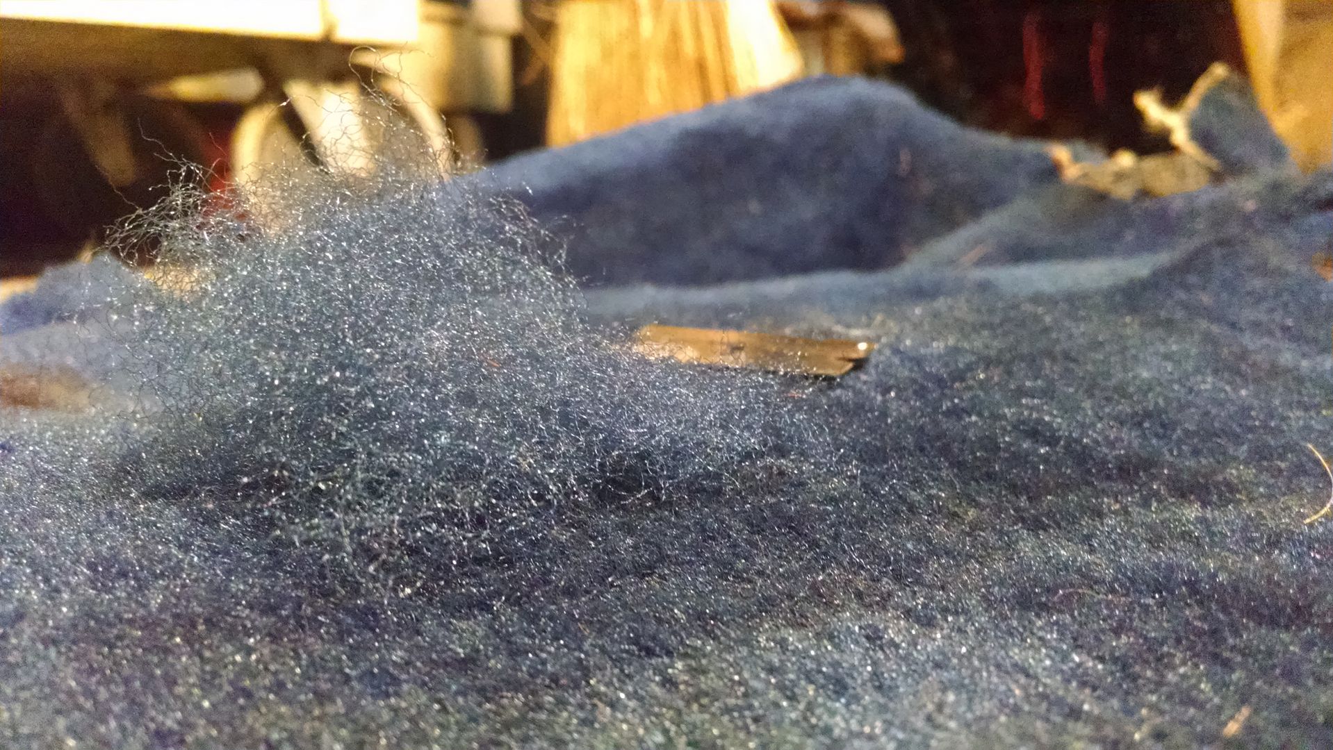

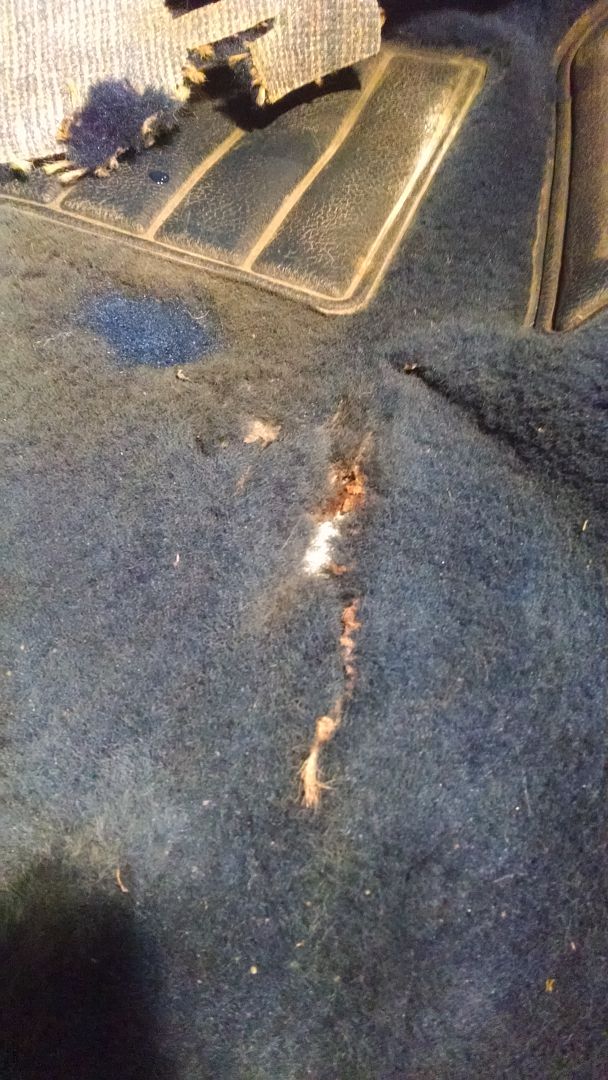

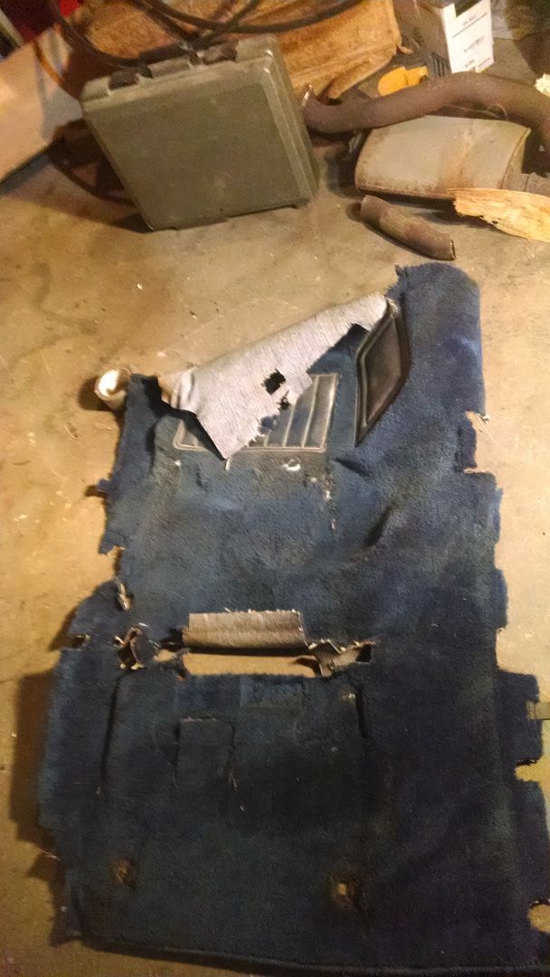

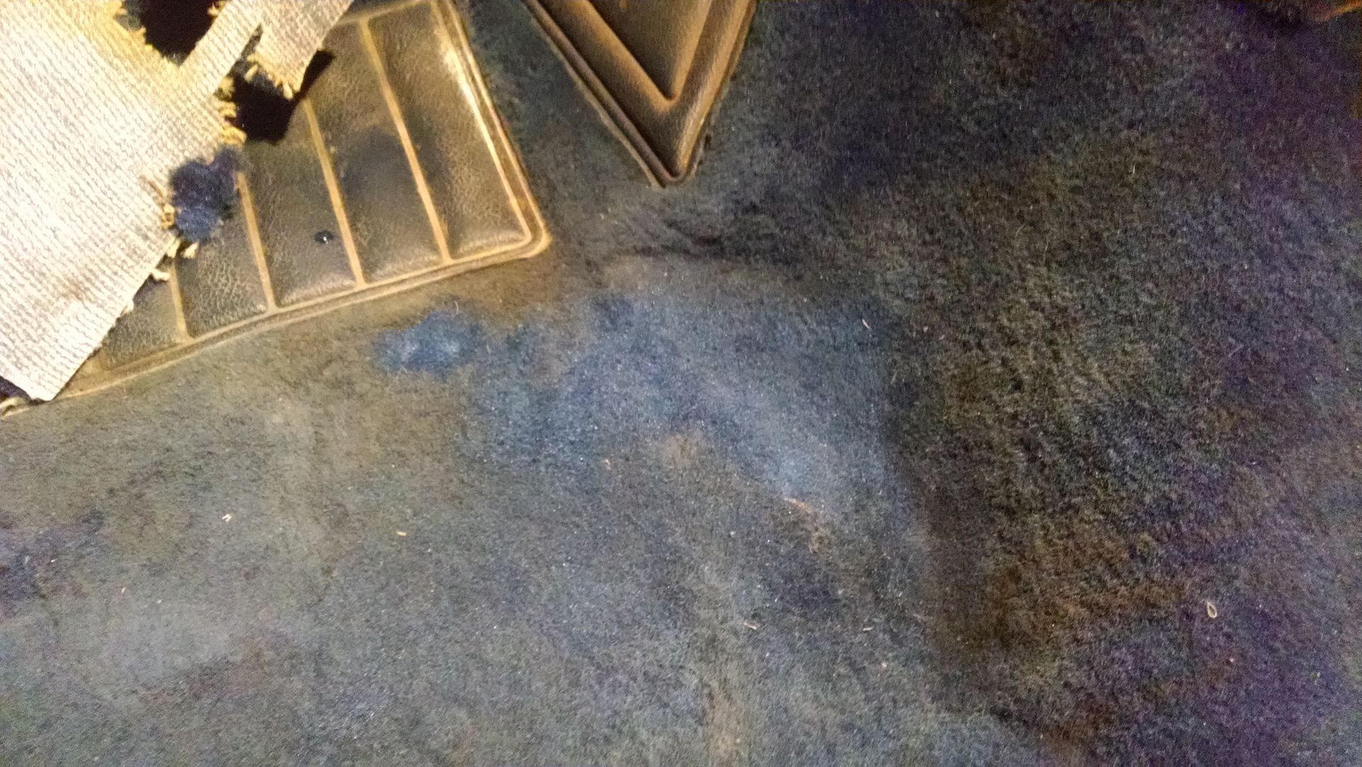

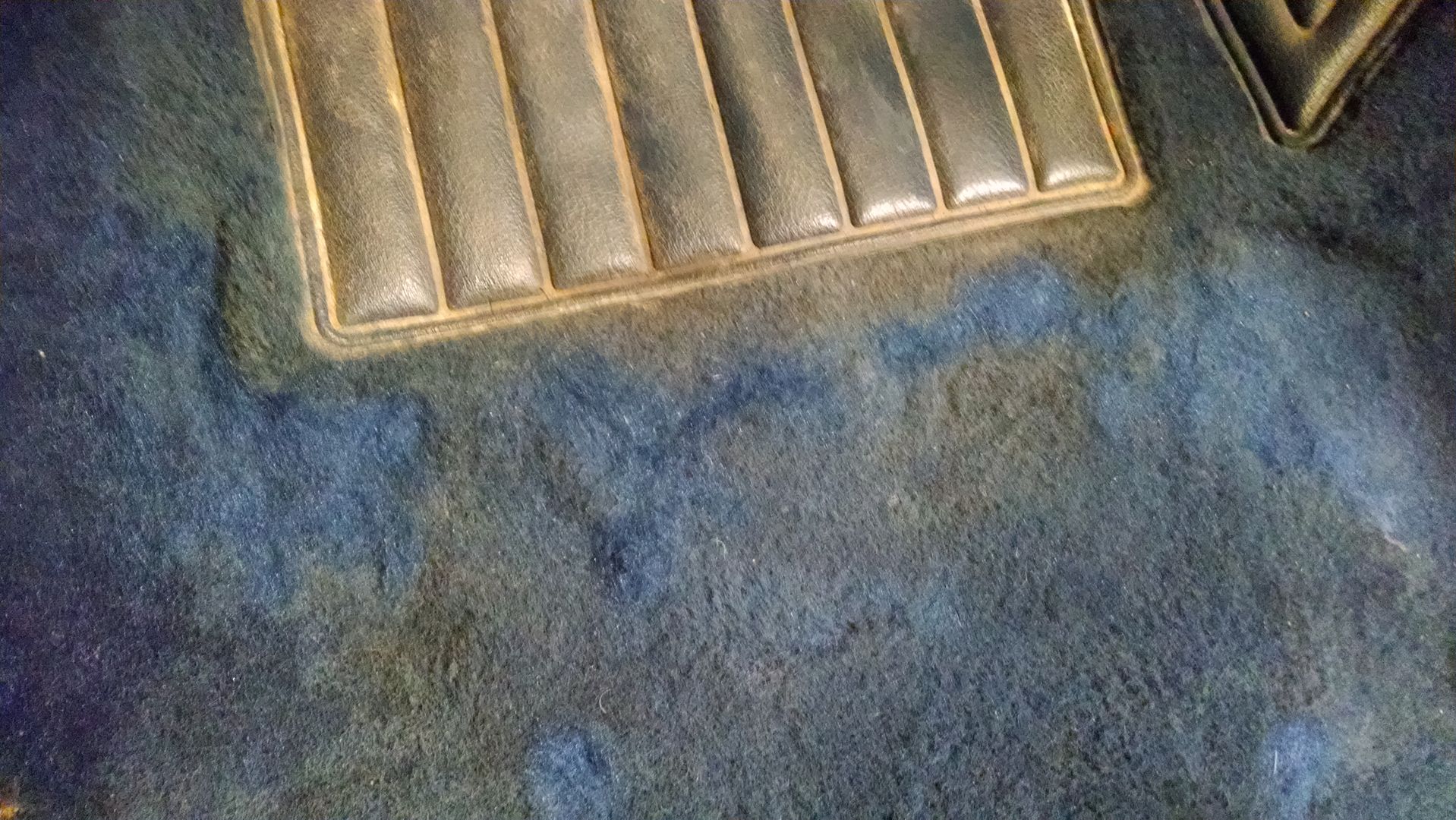

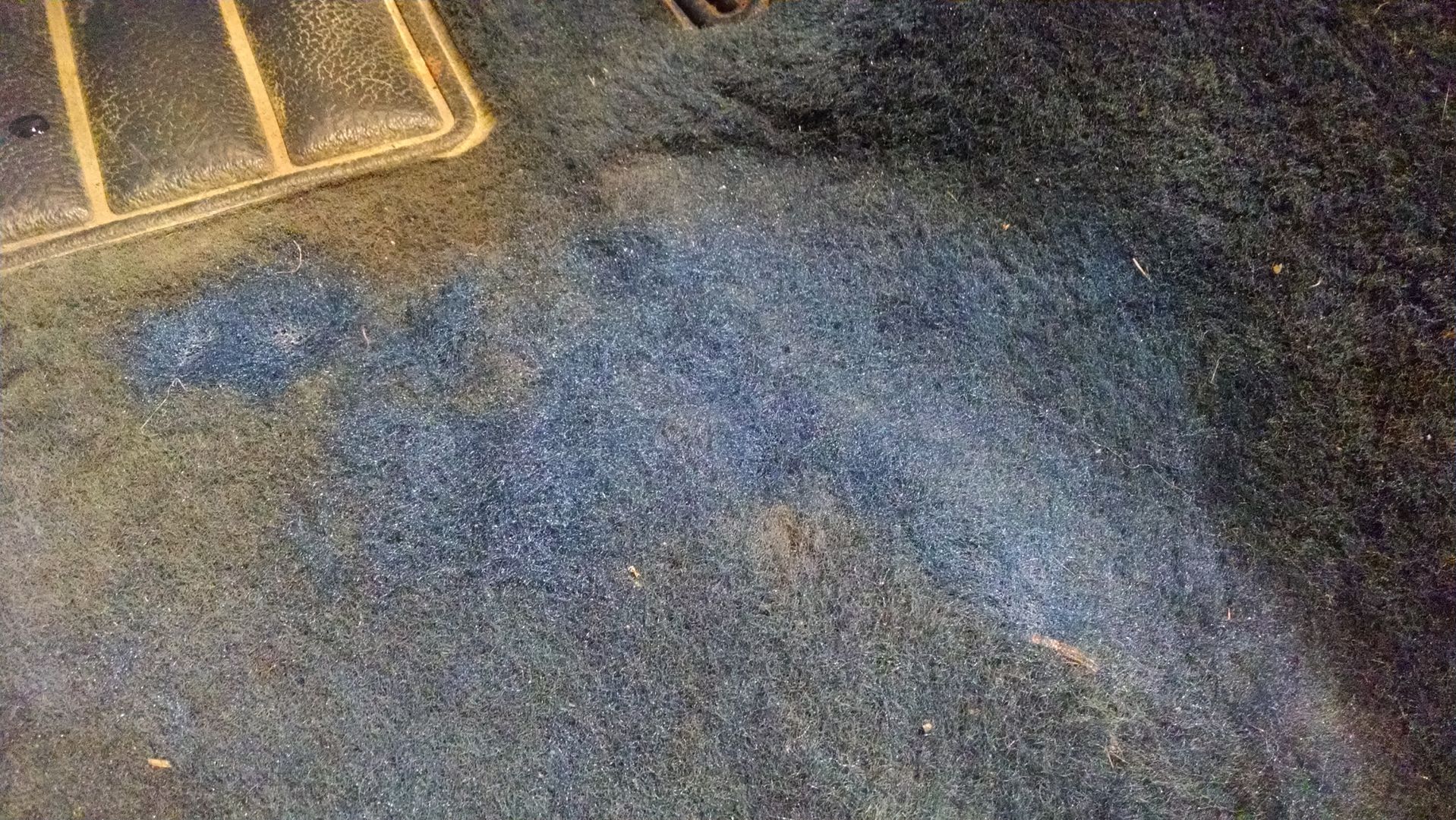

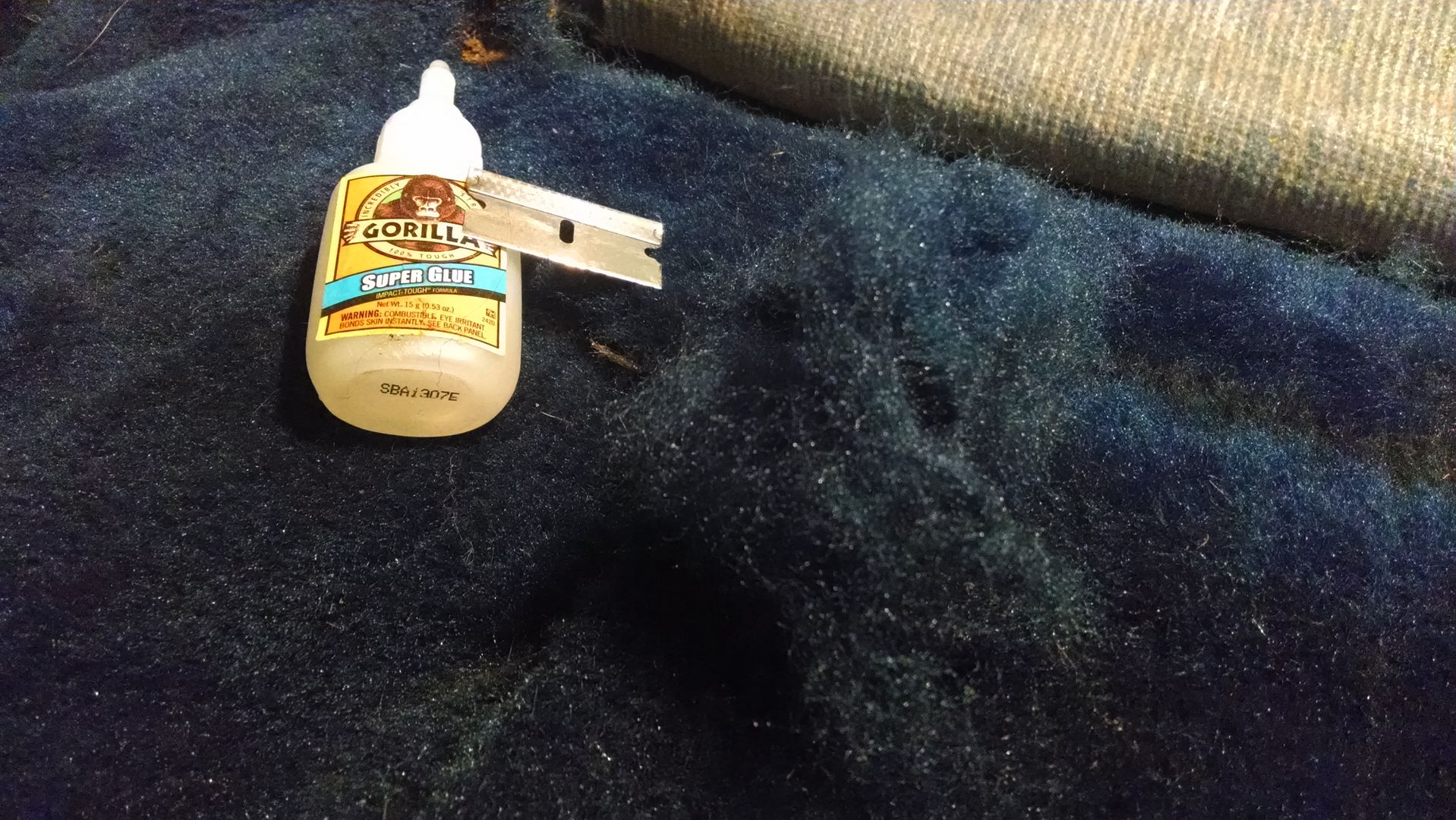

Tonight I worked on the driver's carpet a little bit.
I fixed most of the holes, obviously the color doesn't match, but it's at least nice so you can see what areas needed to be repaired. I'll decide whether or not I paint the carpet afterwards.
The process:
-Back patch the areas with fabric tape (Gorilla tape, and even duct tape work well enough)
-Using a razor blade, shave matching colored carpet from a healthy area of the car.
-Dab of super glue into the repair area. Shortly followed with application of the razor blade carpet shavings. Applied by tapping.
It's fun.
Here are the pictures.
Before:
As you can see, if the carpet you're patching isn't all stained and junk, you can make some pretty gnarly tears virtually disappear.
We'll see if I can get it to clean up. Either way. No holes trumps holes any day of the week. Progress!

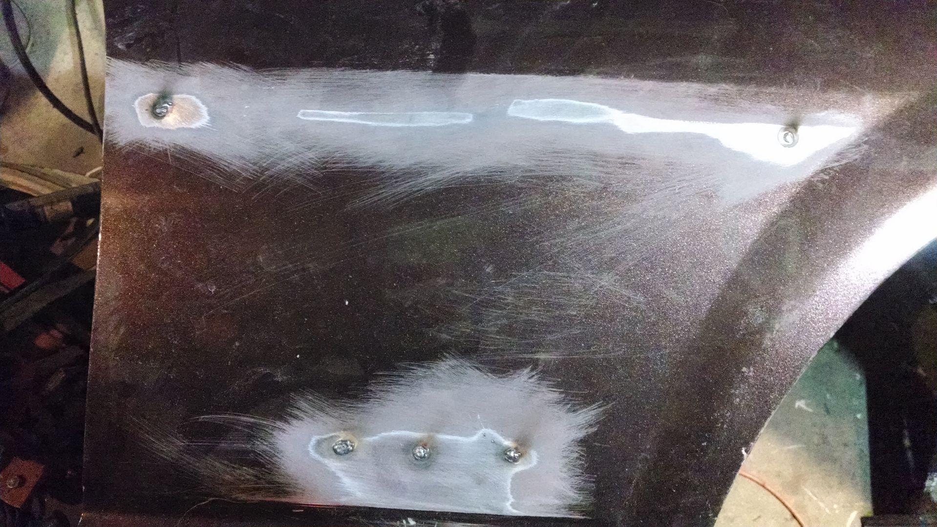

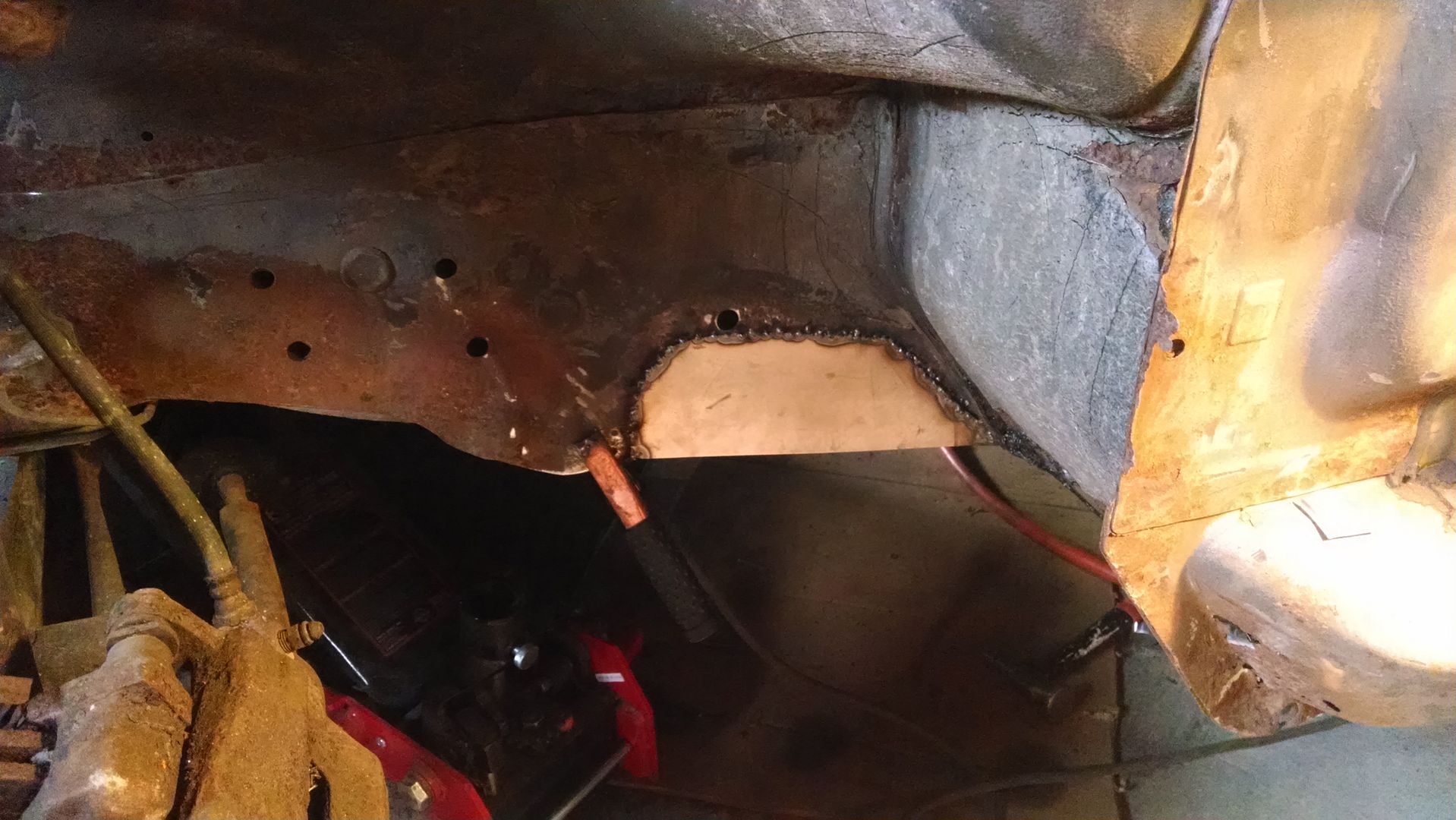

Patch-Fest 2014 has officially come to an end!
The car is as closed up, and strong, as I care to make it.

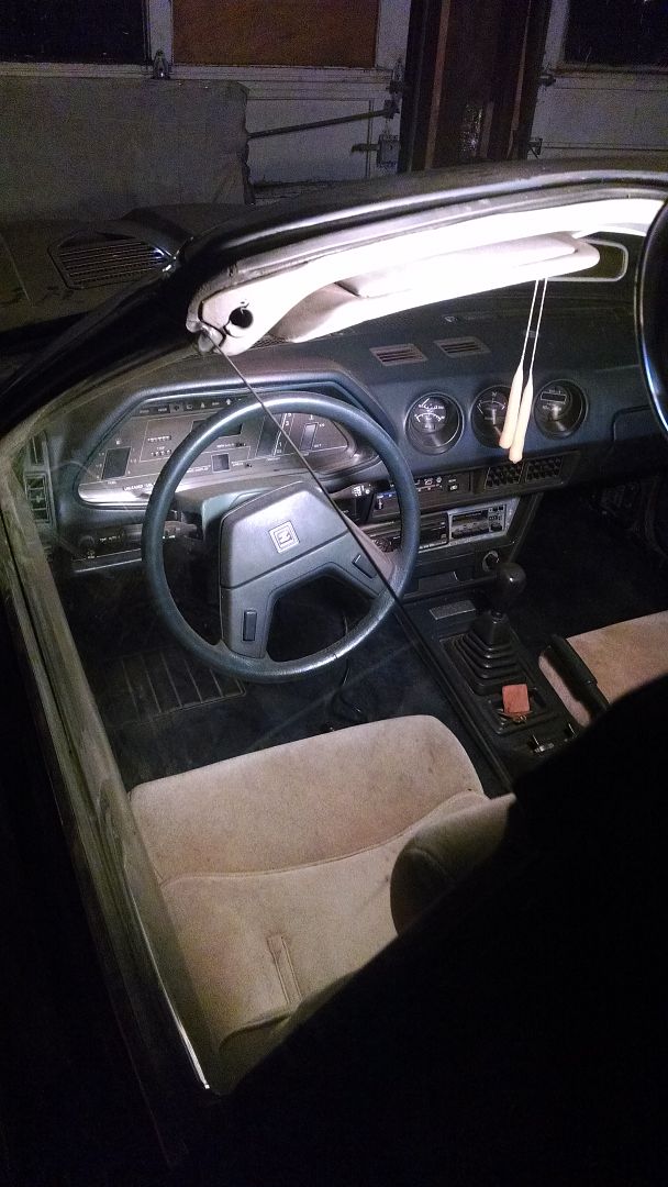

Here's what I got done today:
-Finished welding, painted, and seam sealed the driver's wheel well.
-Some more random body work
-Driver's interior mocked back in place (mainly so I could just sit in it, play with my new floors a bit, haha)
-Fender placed back on the car. Some teaser shots for myself. And the car now. Same angle as always.

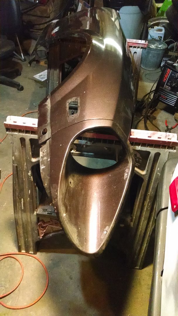

IMG_20140322_214120343_HDR_zpsxqkkdzvf.j

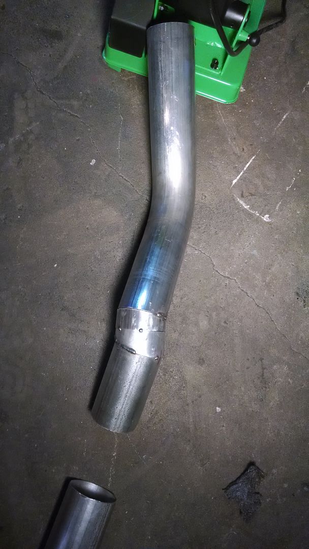

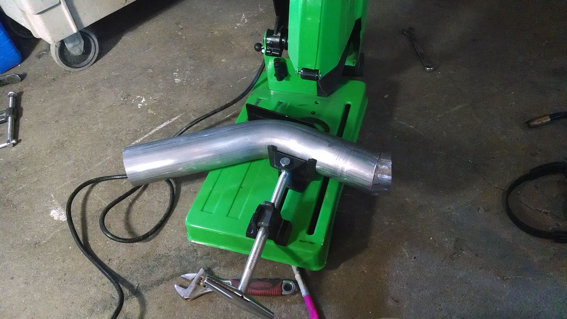

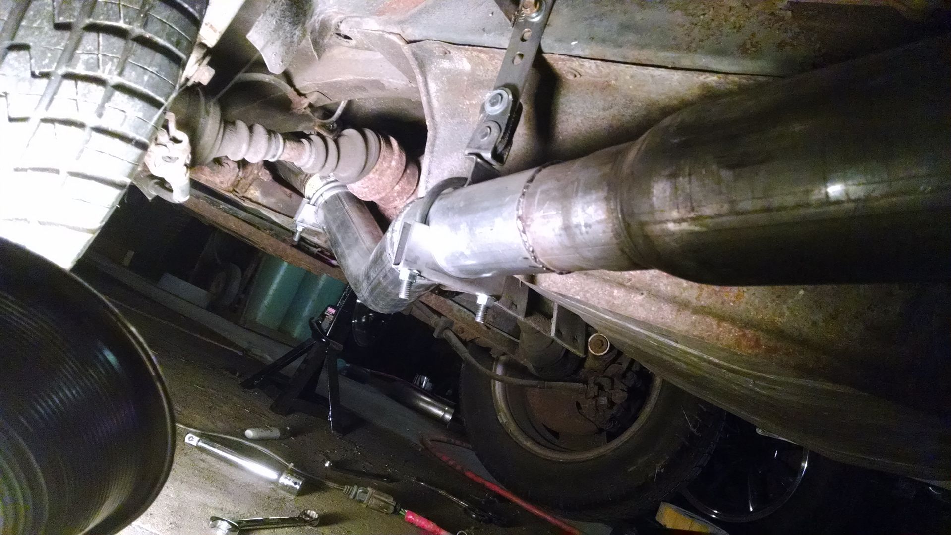

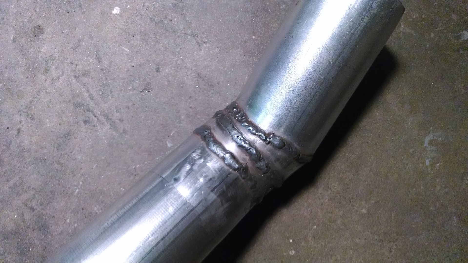

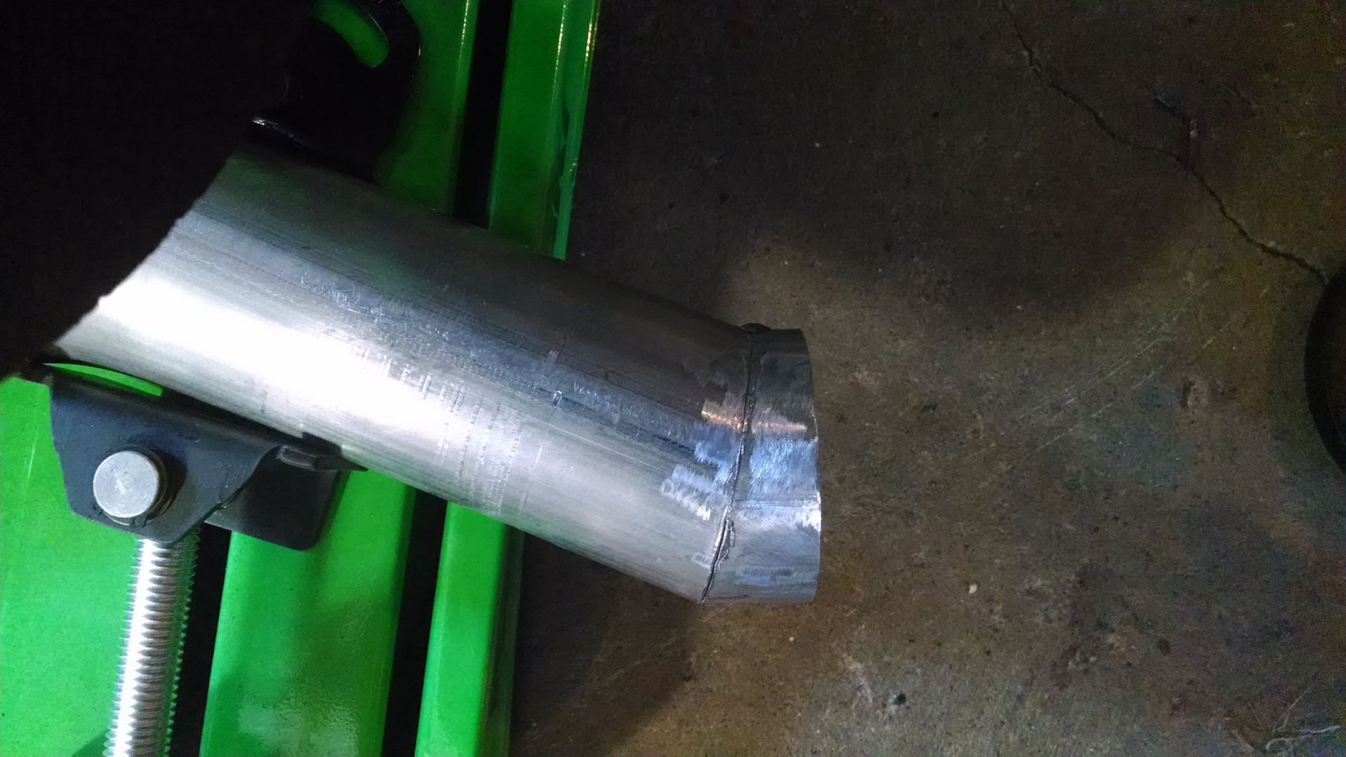

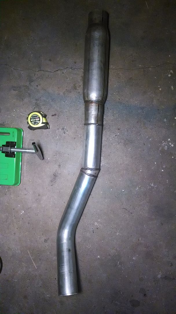

Exhaust!!!!
Okay so here's the layout.
Downpipe ---> 2.5"-3" adapter ---> 3" pipe --> Dynomax straight through muffler

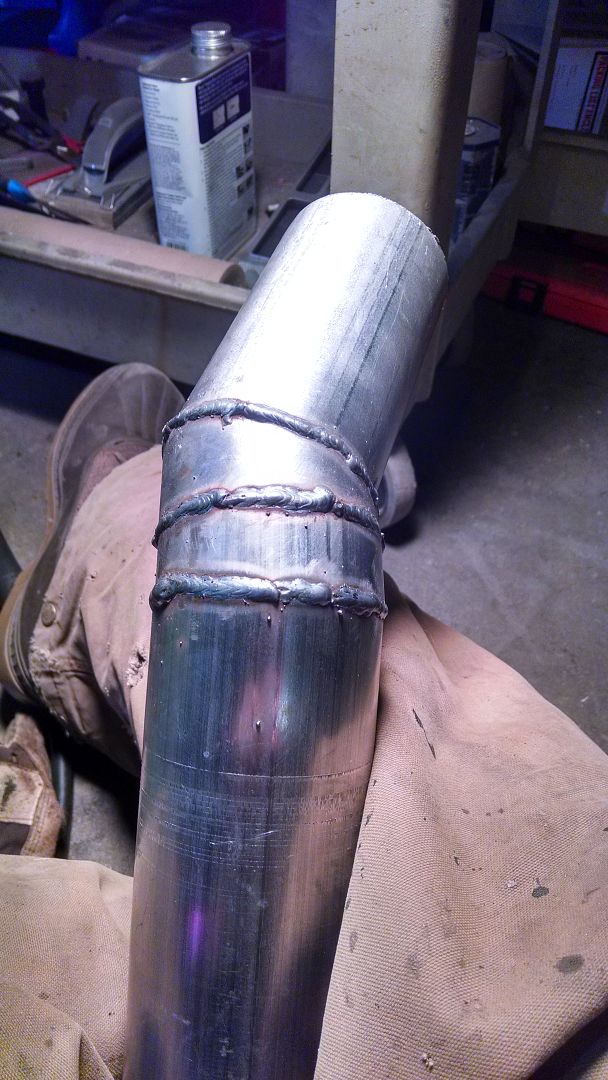

The geometry of the bends is actually pretty complex. So that's where I started. The pipe not only bends, but also twists as it has to be routed over top of the rear end, and subsequent cross members. Hopefully the pictures do better explaining.
I will also have to make this a 2 or a 3 piece exhaust due to those bends. So I'll have to either make, or source out some 3"-3" ID couplers.
I'll say this though......It's really nice doing some clean fabrication work. Such a relaxing change from rusty garbage repair. I'm having a ton of fun building this.

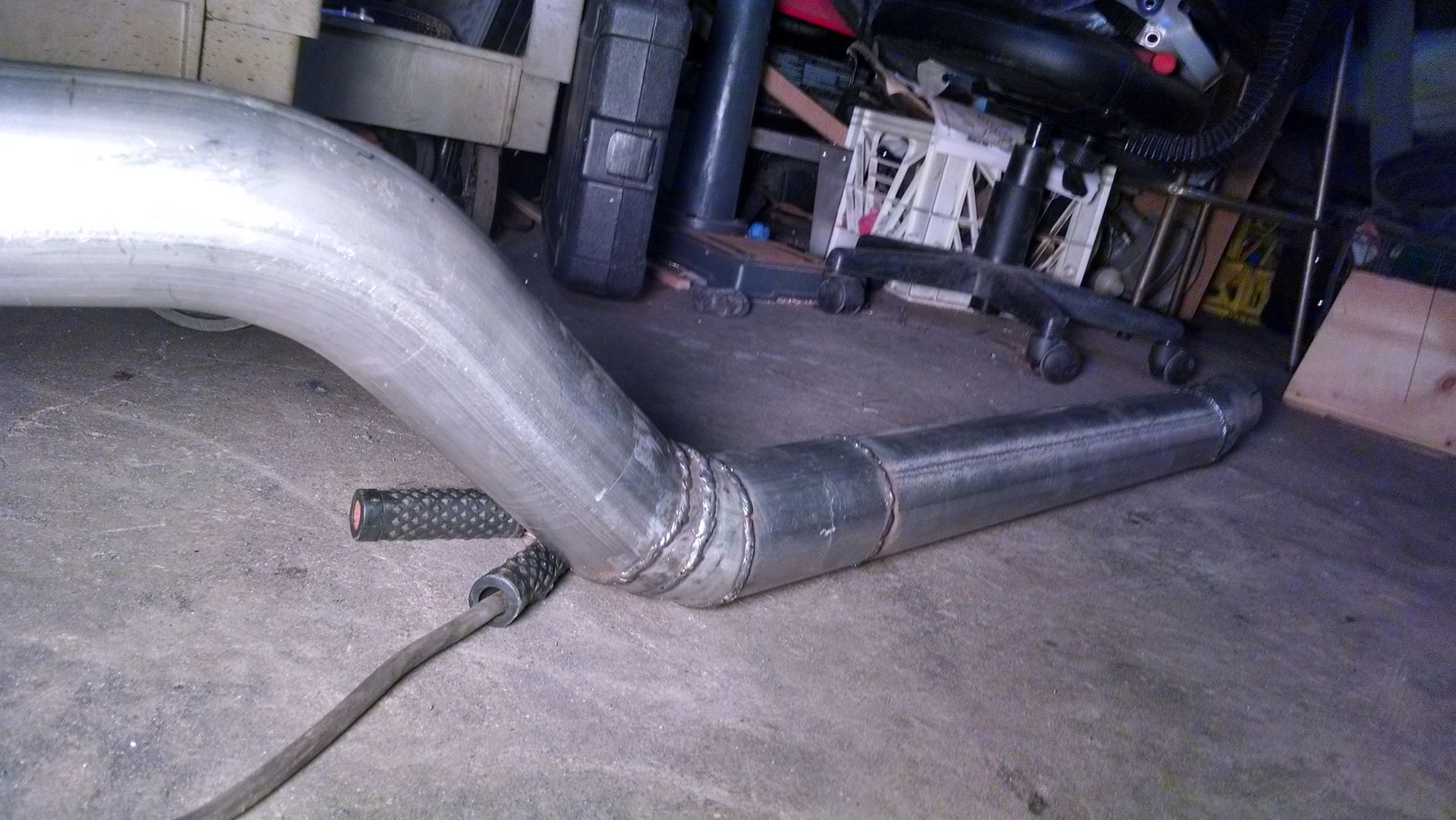

Here's what I've accomplished so far.
IMG_20140323_184947186_HDR_zpsnrlpgmrd.j
IMG_20140323_184939049_HDR_zpsvo7a2h2u.j
First section.
Coupler will go here.
All bendy twisty over rear end suspension stuff.
I'm all fueled up with some potato leek soup.
It's time for round two. More tonight...

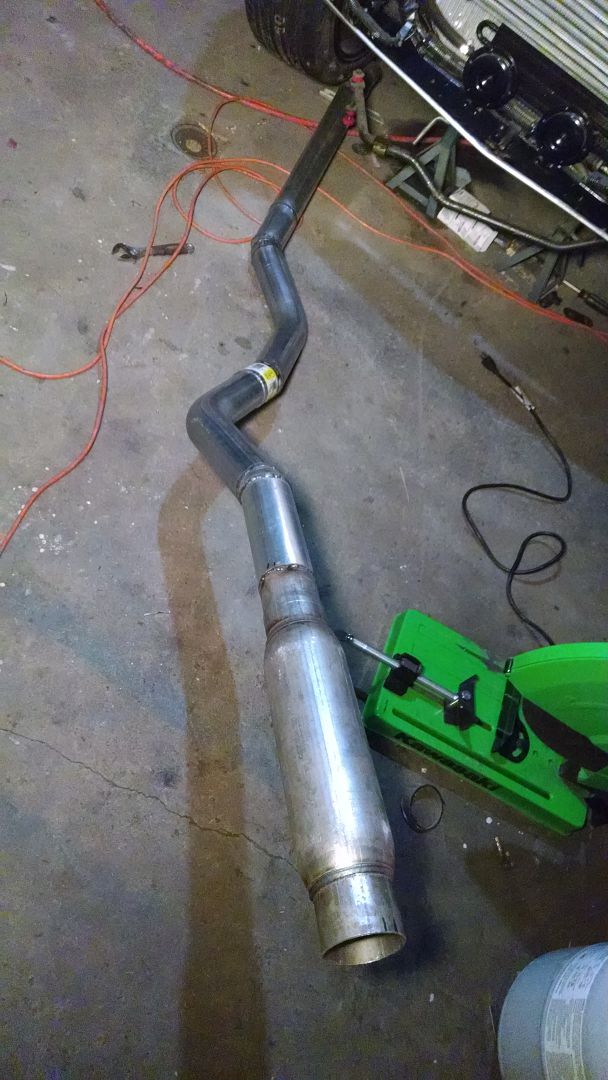

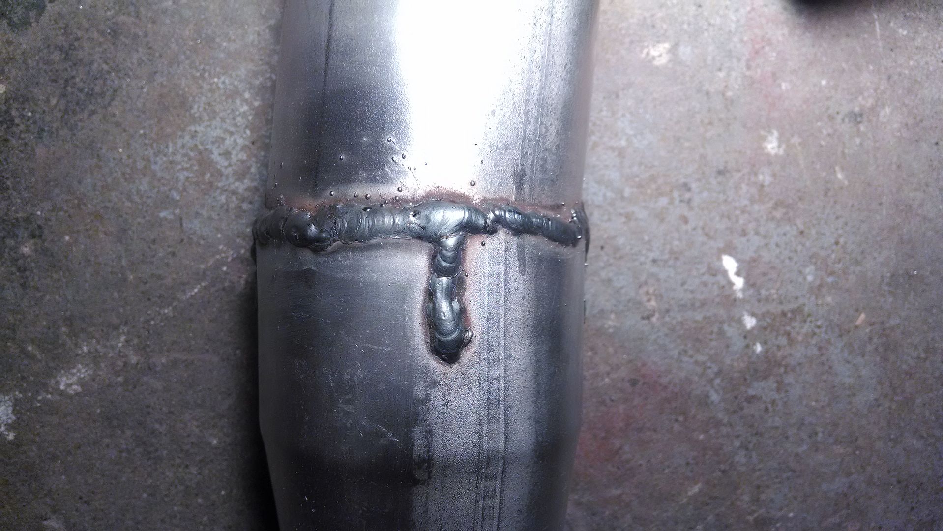

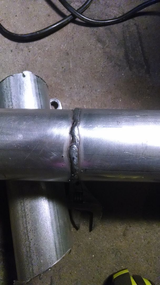

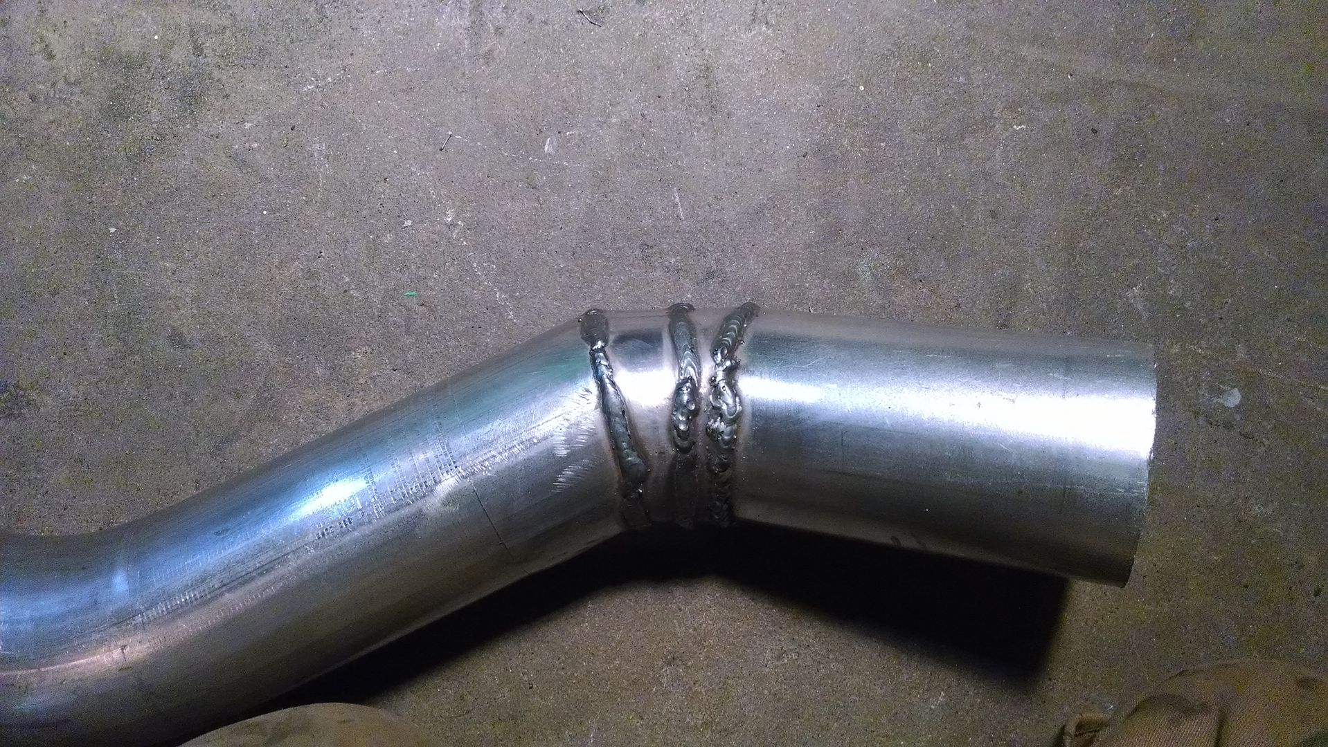

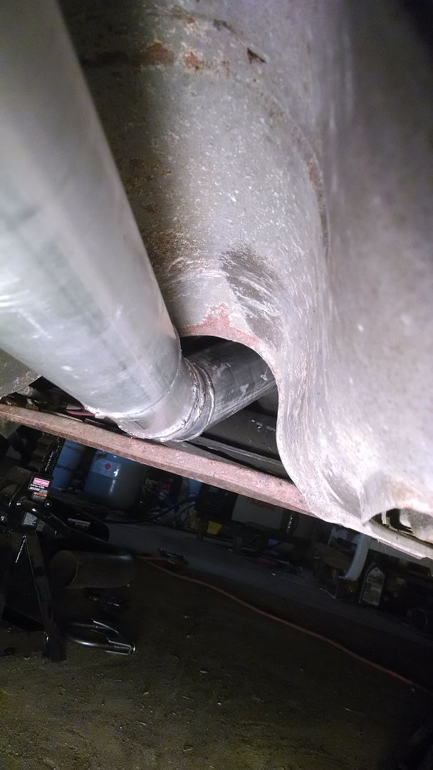

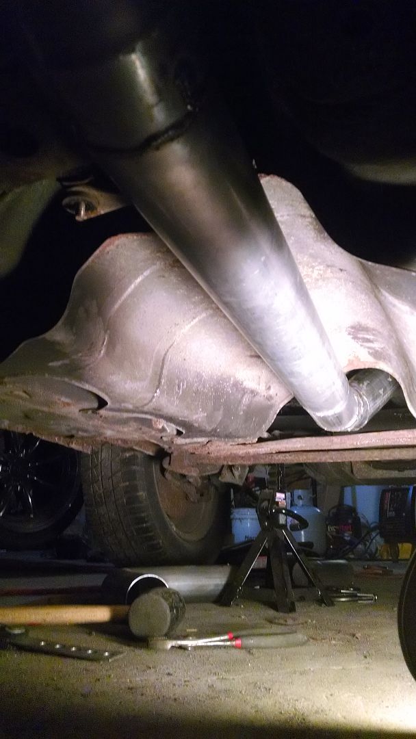

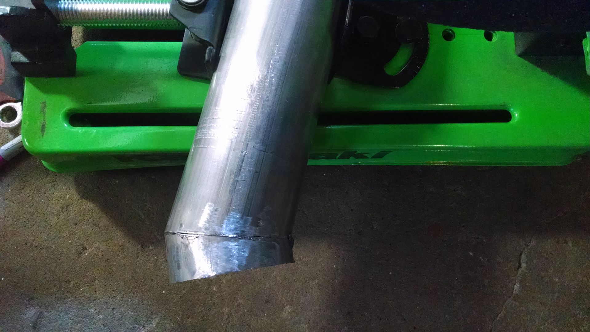

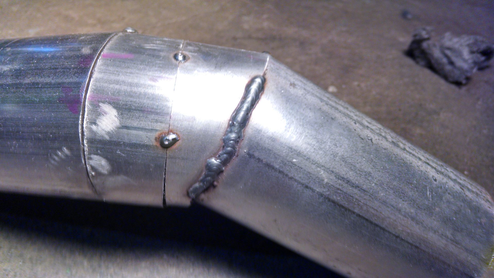

I have pretty much finished the first half of the exhaust. Tomorrow I start the second half.
Luckily I am able to make the exhaust a 2 piece, instead of my original 3 piece thinking. So instead of a coupler, where I mentioned before, I was able to butt them together instead. Much easier to manage now.
I'm happy with the fitment at this point. The welds are a little scraggly, but they aren't bad. Overall, pretty satisfied. A fun way to spend a Sunday afternoon, I certainly enjoyed myself.
Hopefully the pictures show that.
IMG_20140323_205914128_HDR_zpsxiegotxb.j
IMG_20140323_213721759_HDR_zpsxq2eurxy.j
Finally you can start to see how I am routing the piping in the car. And the required bends needed to do so.
Welcome to the underside of the car. My Hell.
IMG_20140323_214203632_HDR_zpsni6irfrb.j
I have a couple bends left. Then it's exhaust hanger time. I'll hopefully be 90% done by the end of the day tomorrow.

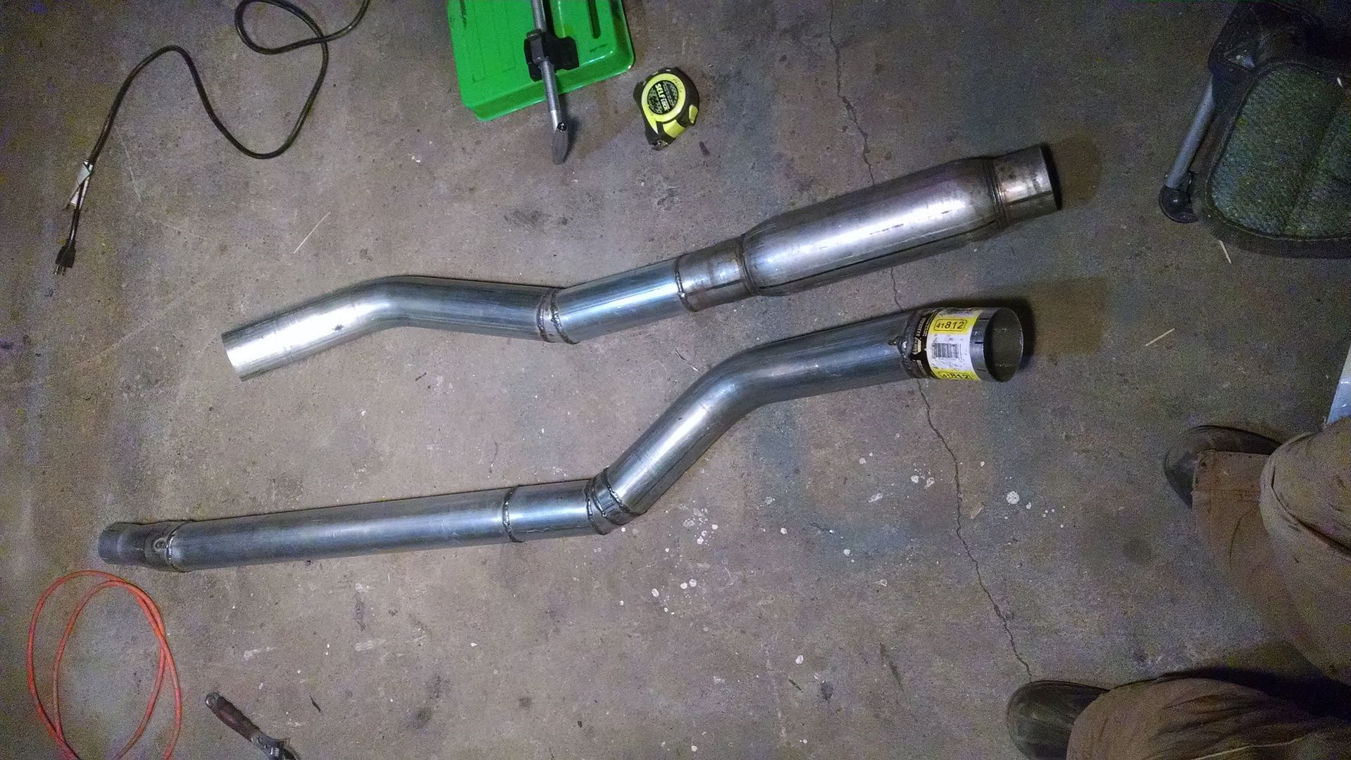

Posted 24 March 2014 - 10:06 PM
I spent more money on the car today..Fifteen all mighty dollars.

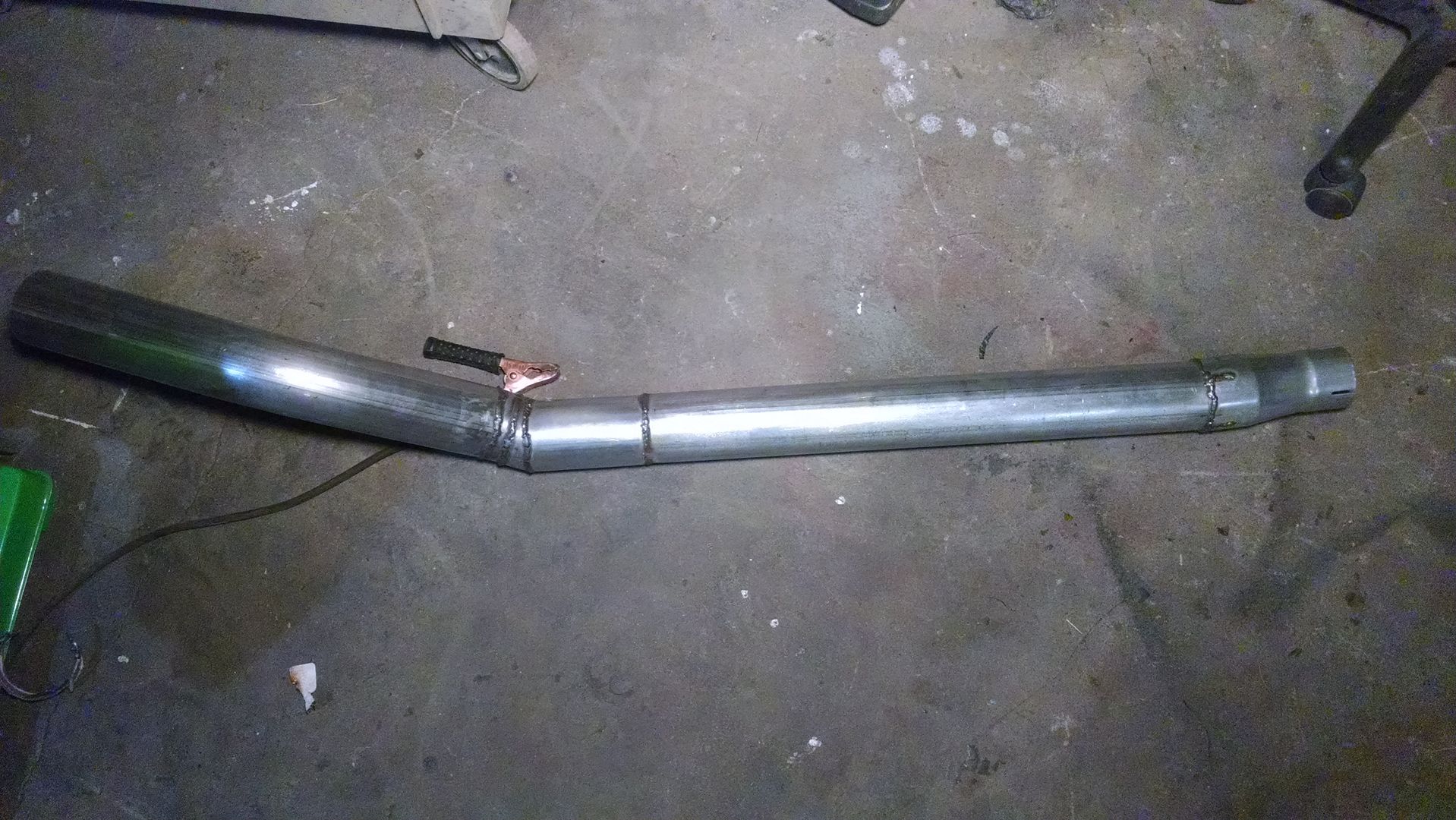

Bought a 2.5" exhaust clamp, for where the adapter meets the existing downpipe midpipe, and one 3"-3" ID coupler to accommodate removal.
Here are the assorted pictures of the rear section fabrication, fitment, and random geometry angles.

-Fenders, hood, doors and hatch will be sprayed off the car, most likely 2 pieces at a time a day, at work, after hours.
-I'll then spray the jams, and unibody in my garage.
-This process will most likely take the better part of a week. Once desired body work is achieved. Add in the variable of temperature in my garage for the unibody spray, and it may prove to be a challenge.
Tomorrow I start to make it straight and make it smooth. And with any luck I'll have some paint to swirl around and take pictures of.

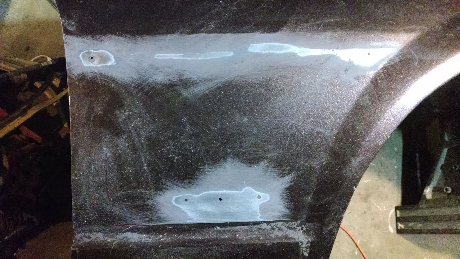

Tonight, I did a little prep, so it's just a couple less things I have to do tomorrow.
Like welding the side molding trim holes, and the fender emblem holes.

Great job on the exhaust! Are you still using the stock downpipe?
#40 OldAndyAndTheSea
OldAndyAndTheSea
    Can Charge Rent
  • Members
  • PipPipPipPipPip
  • 759 posts
Posted 27 March 2014 - 06:14 AM
Thanks, I'm pleased, it's really nice for what it is.
And yeah, the downpipe, and midpipe are the OEM versions.
I didn't want to take the engine apart, so I chopped the old midpipe at a straight section, and I tossed an extra 2.5"-3" ID adapter to run the 3"
Luckily, at least from what I can tell, there were no, to minimal, exhaust leaks upstream of the new piping. If that changes, I have an extra manifold gasket.
Here's one of the pictures when I was first working on the car, pre patch fest.
I cut it right where you see the break in the pipe.
Edited by OldAndyAndTheSea, 27 March 2014 - 06:20 AM.
