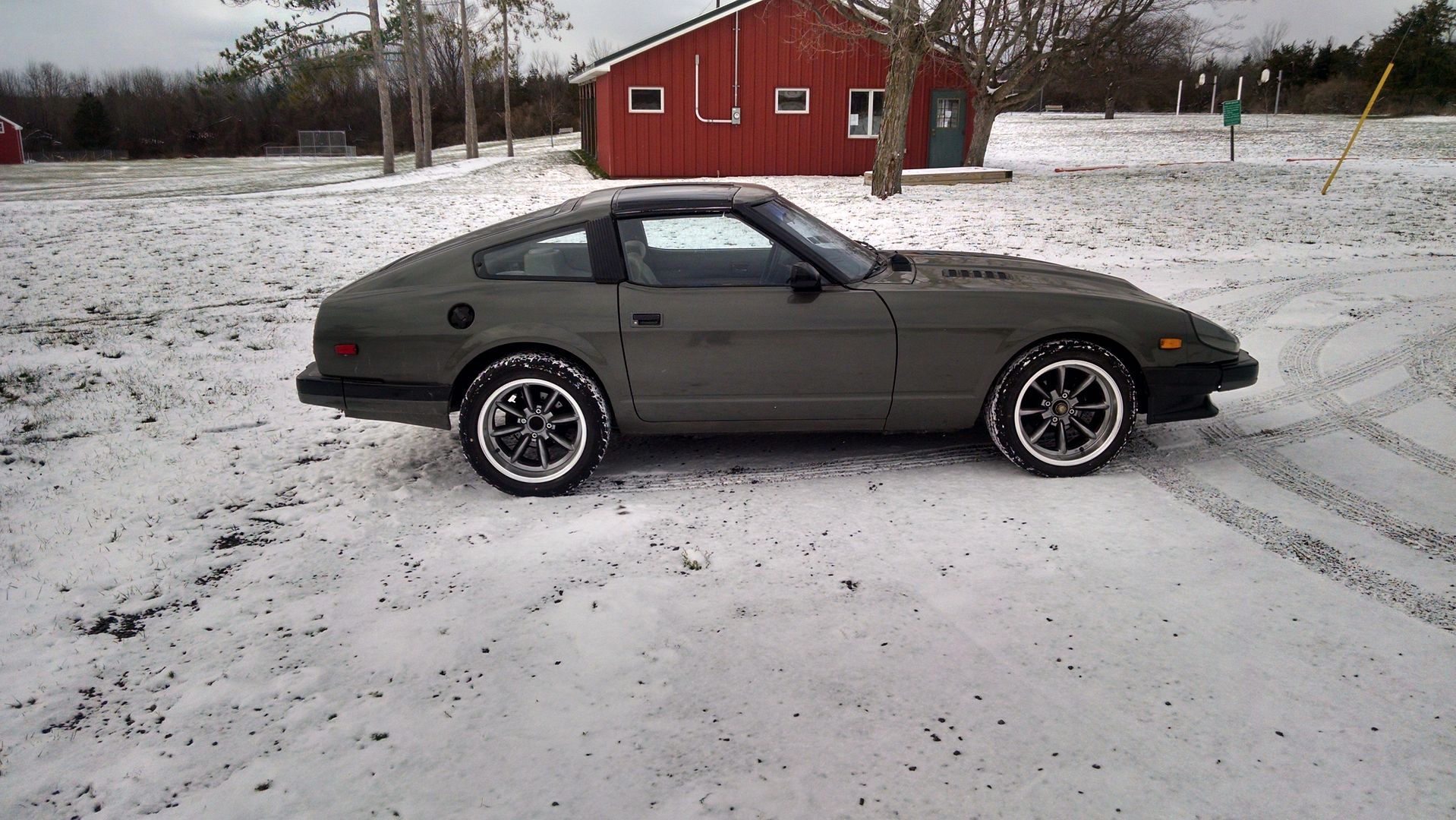

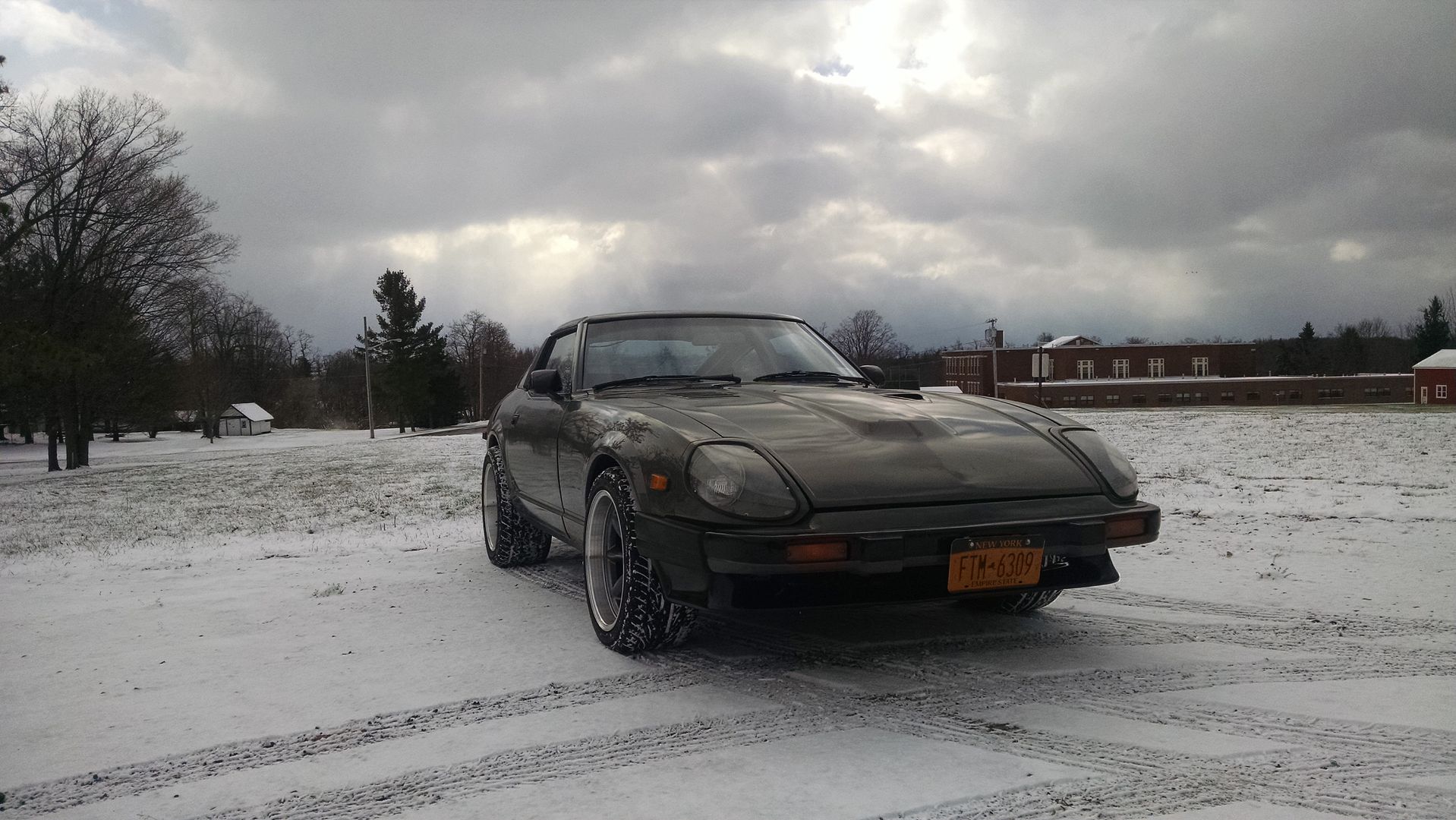

Last shots of the car outside for the season.
IMG_20141128_111836696_HDR_zpsje7nyxz6.j

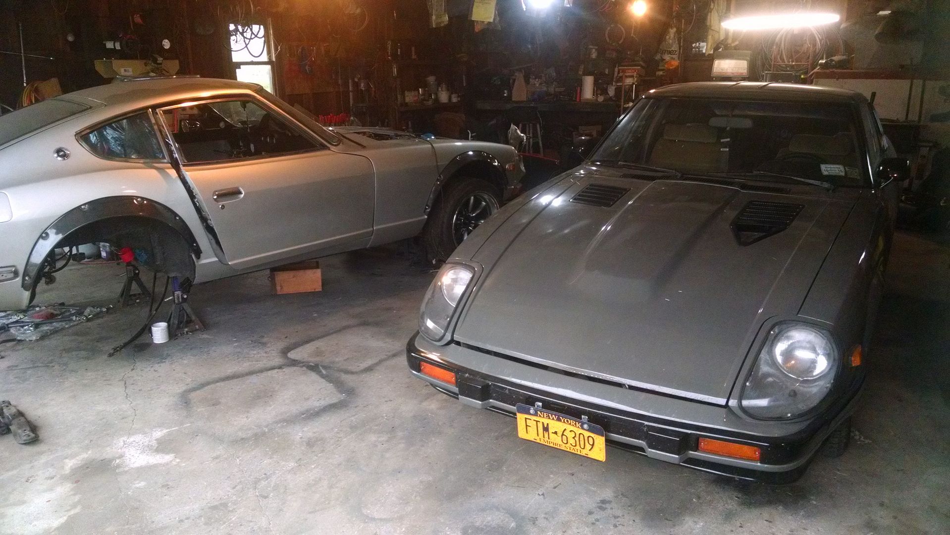

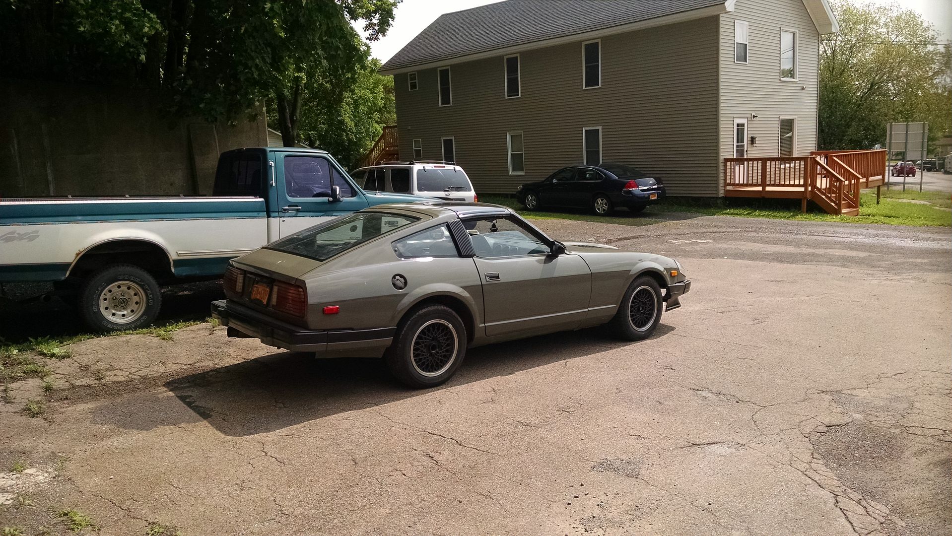

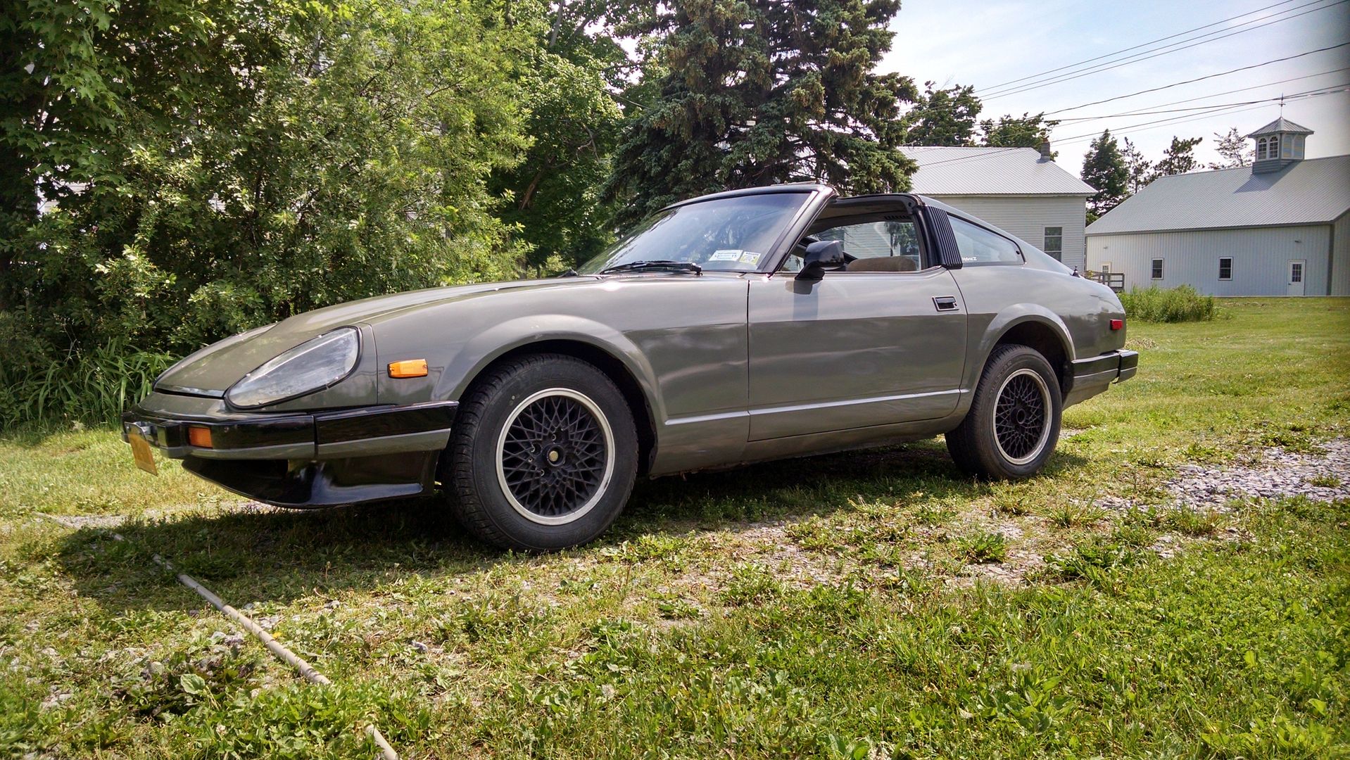

Some 280 progress. What a great little car this has been. :D
Swapped back to the mesh wheels, as my 240 will be needing the big wheels soon :)
I destroyed the first pair of Fuzion HRIs while honing my alignment "skills"..... So I bought two more 205-55r-15. (+$110)
Didn't pick them out. I asked for the cheapest they had. They're  Milestar Touring SEs...Bwhahaha. :P
Rears don't match the front; See if this guy cares.

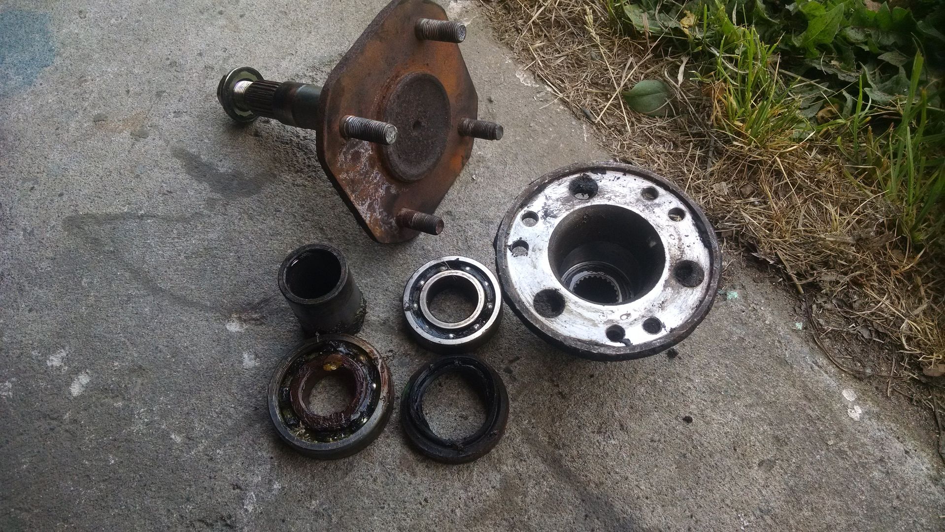

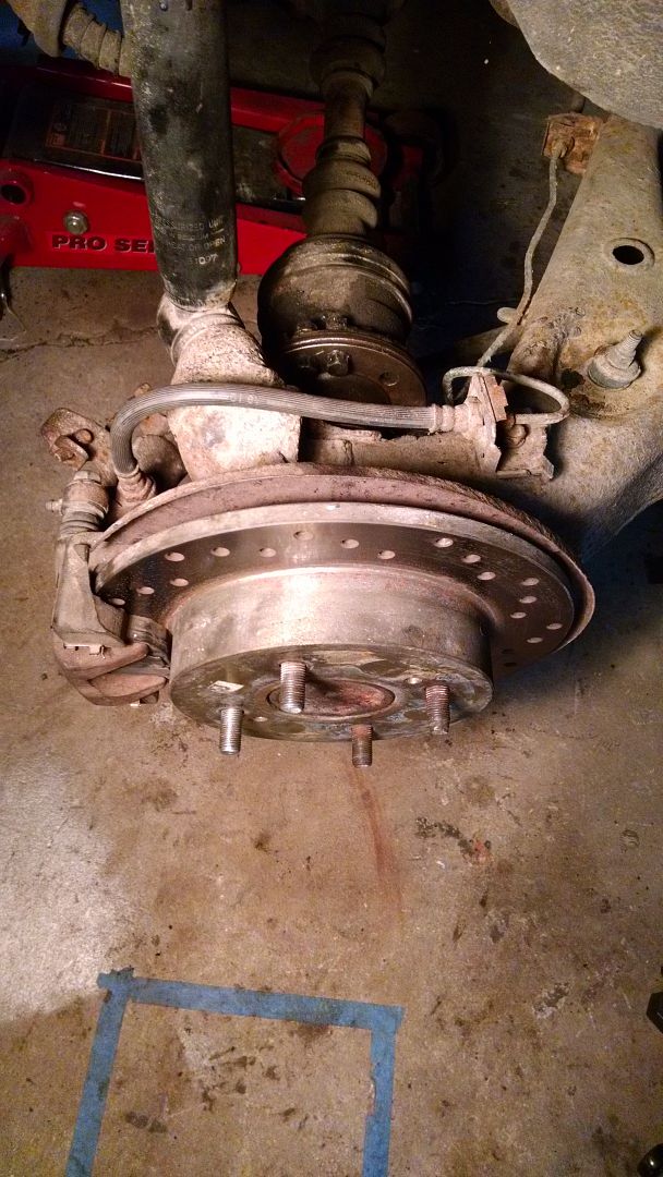

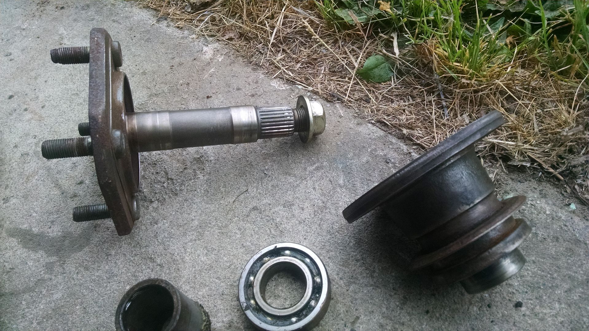

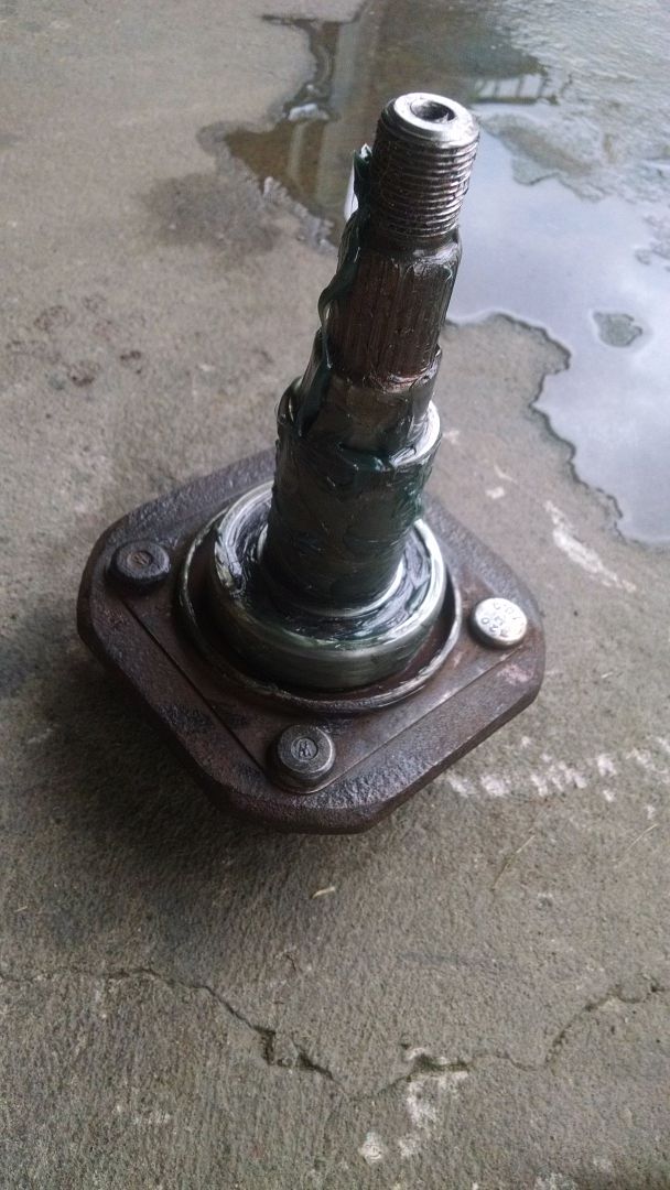

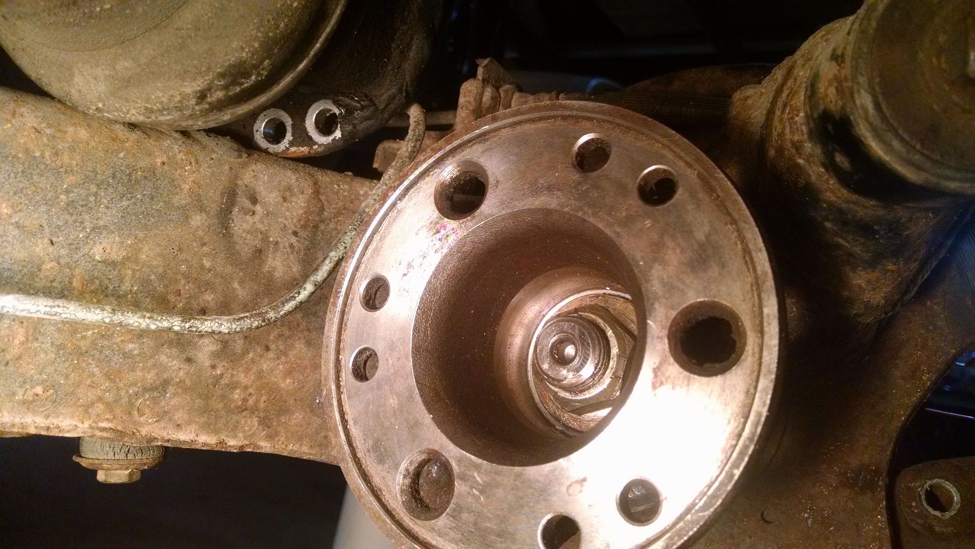

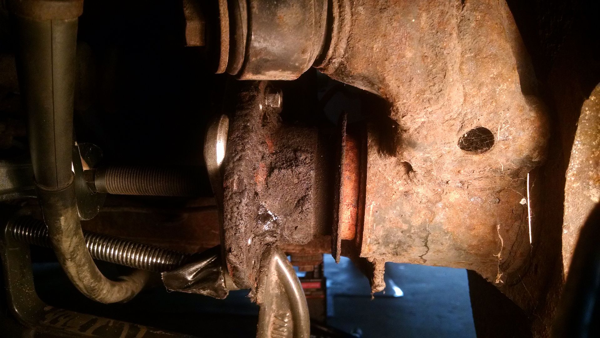

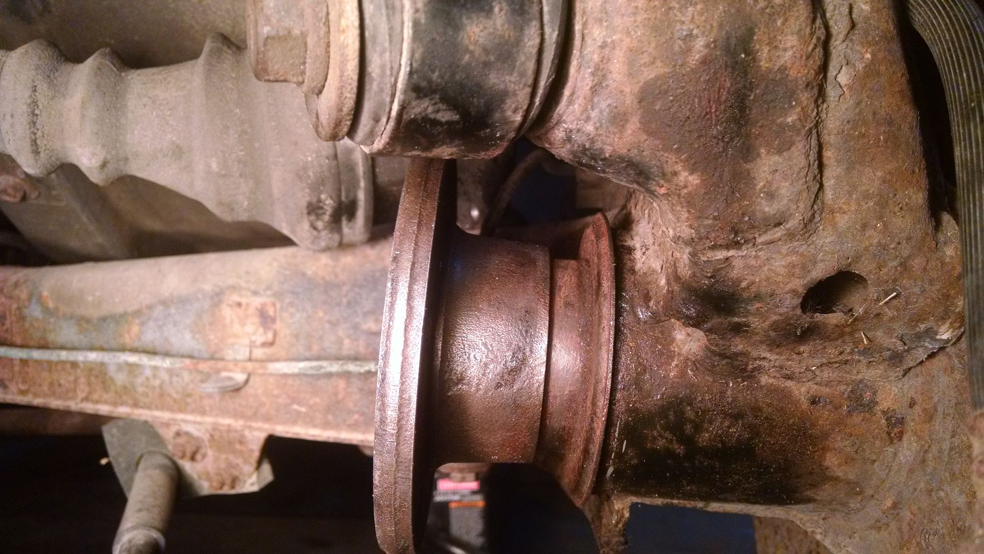

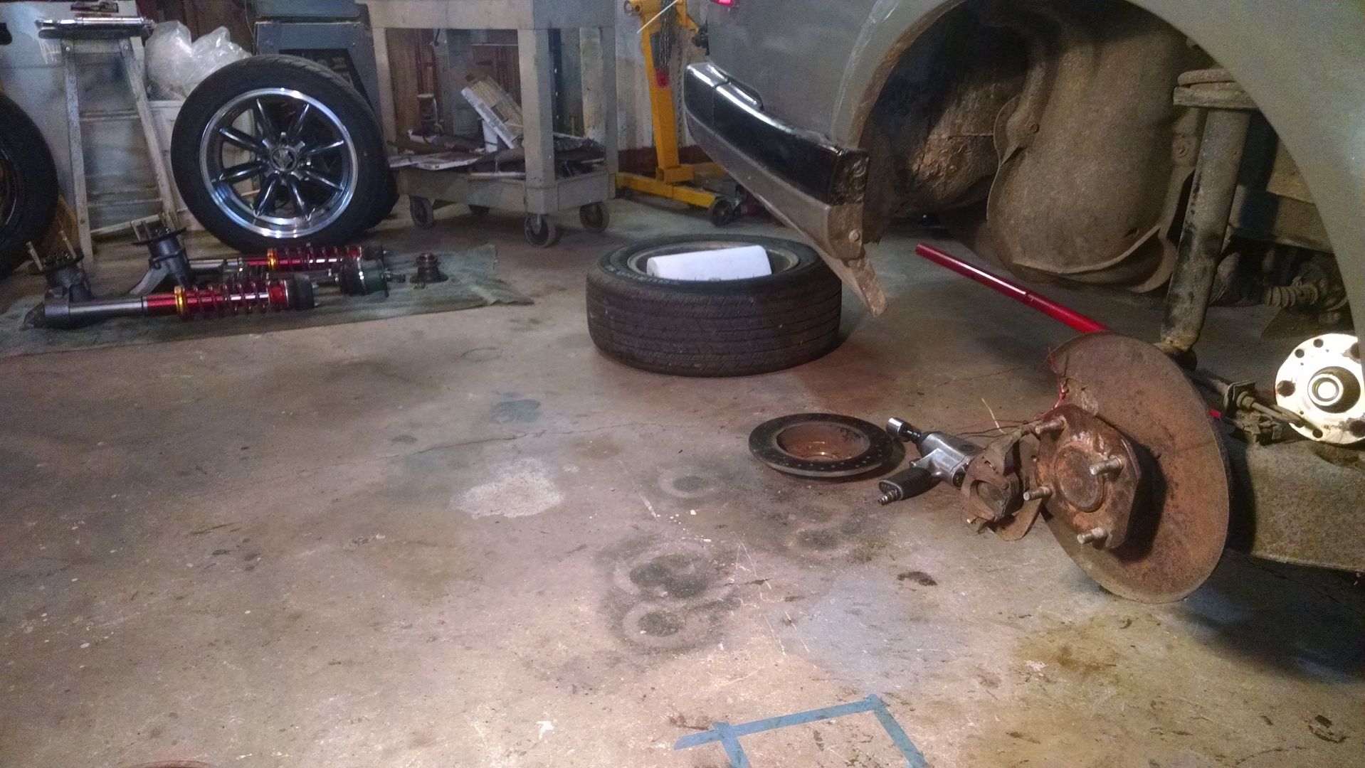

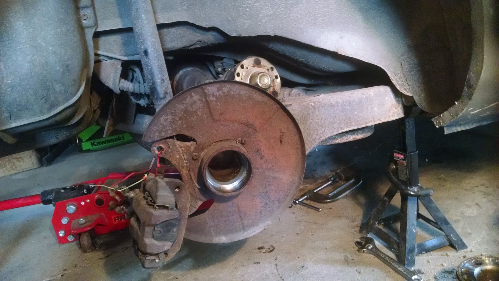

The car has always had a bad passenger's rear wheel bearing. I've been putting it off, because I had little hope of the stub axle actually coming free.
Regardless, I bought a set of rear bearings, and got to work. (+$80)

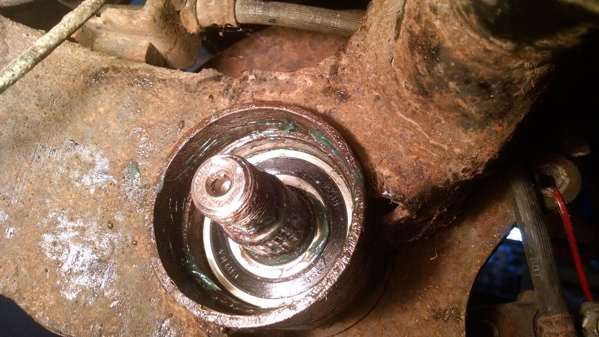

Here's some before. Obviously the grease seal wasn't working too well.
IMG_20150530_162958013_HDR_zpswjlm7euz.j
YES! Separation. Sweet sweet separation.
....I don't believe it.

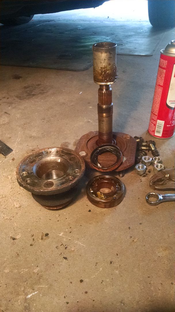

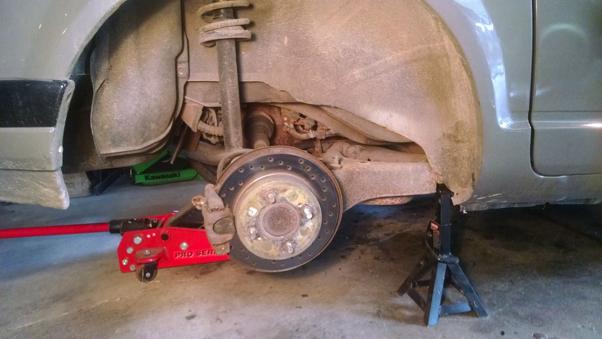

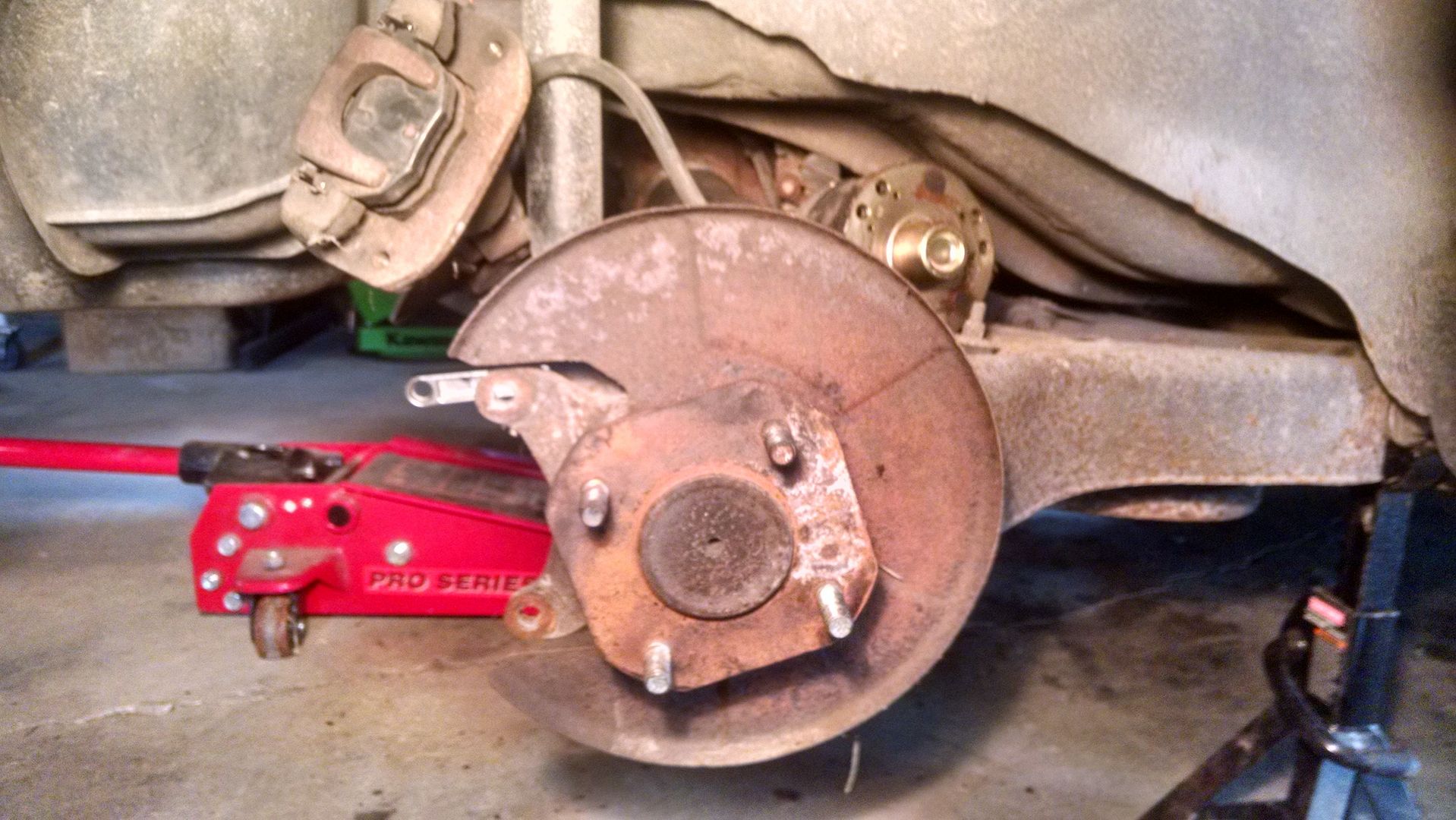

Grease cleaned off - Budget car clean. Just lots of never seize, where appropriate.

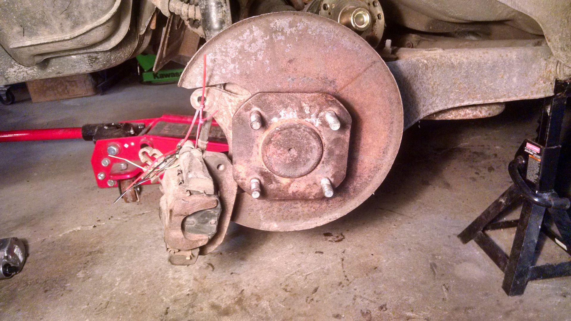

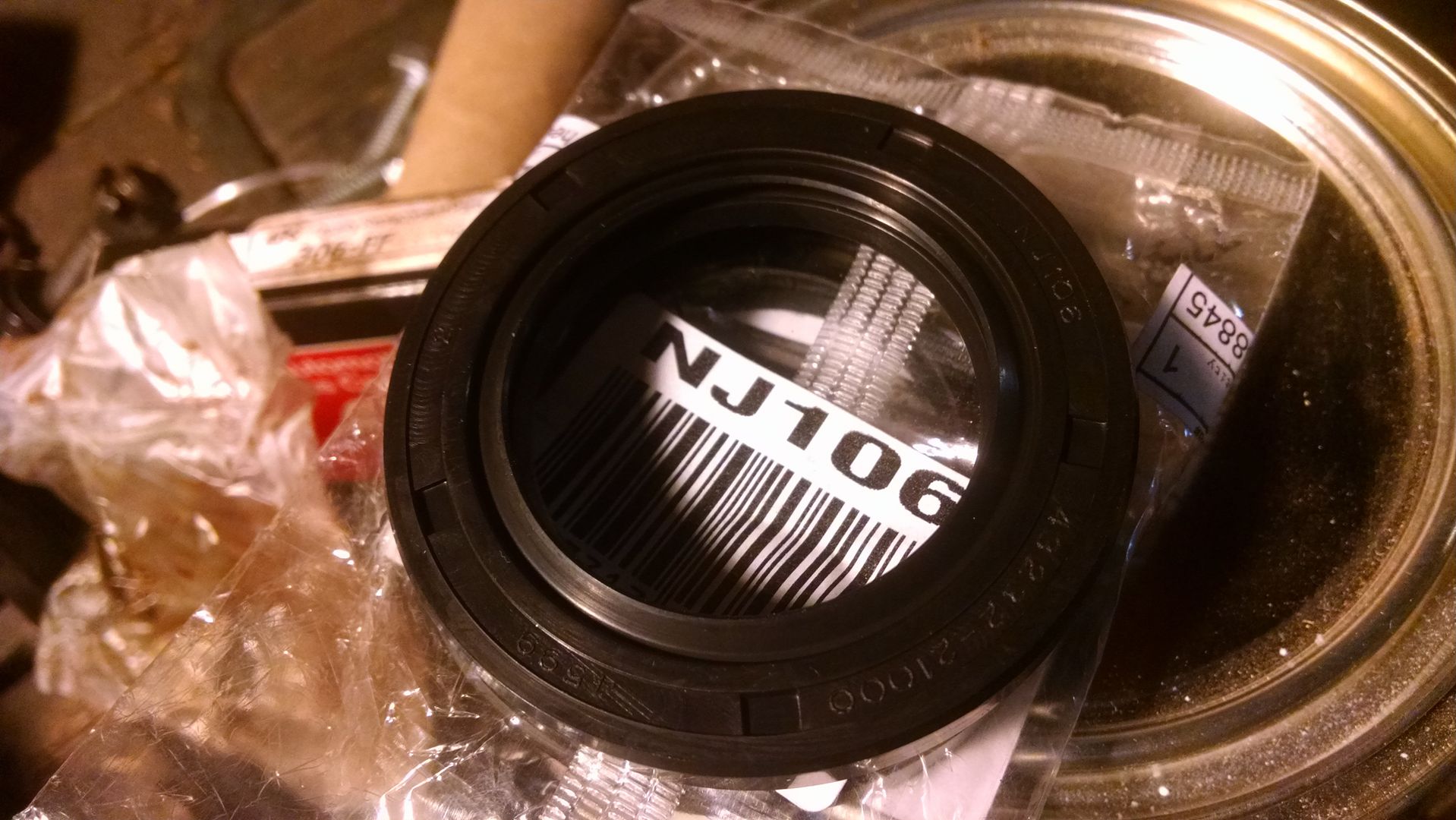

Pressed the outer bearing in place. Loaded up the spacer.
And back in place. The seals arrive Monday, so I have to stop here.
Have you ever seen anything so beautiful?

As mentioned, I got my inner bearing seals Monday. So I finished up the bearing install.
Woot!

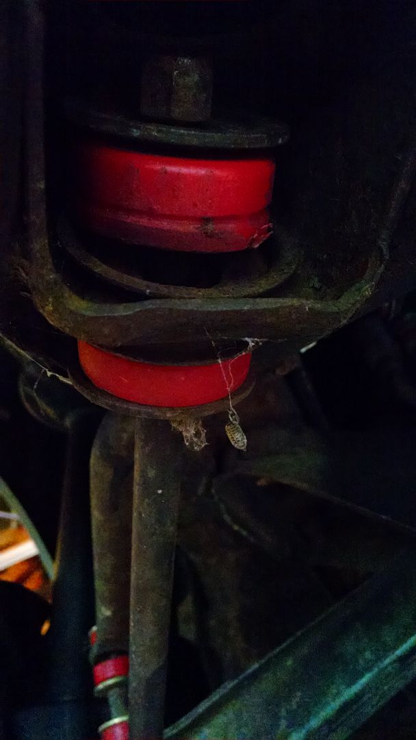

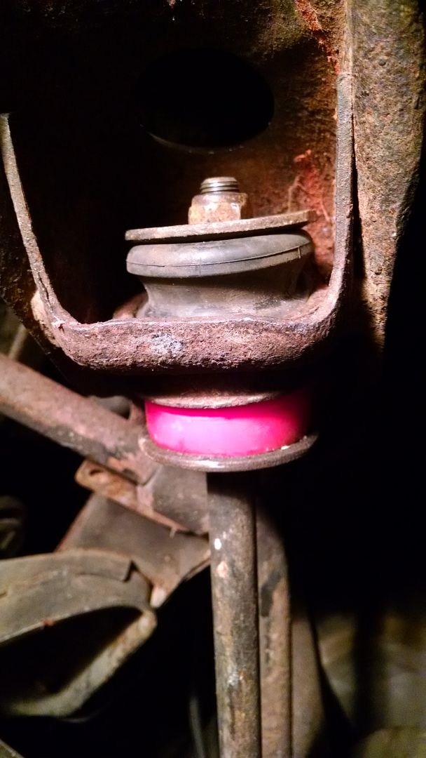

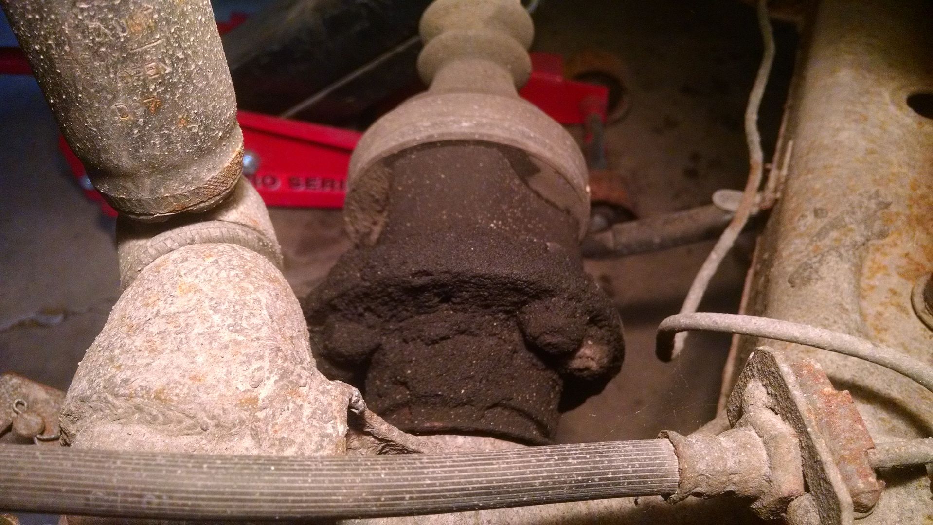

- Swapping one of the tension rod poly bushings with rubber, as double poly bushings are commonly known to fail tension rods...So rubber it is, on the nut side.
               Before - looks better, but needlessly stiff.
               After - rubber/poly

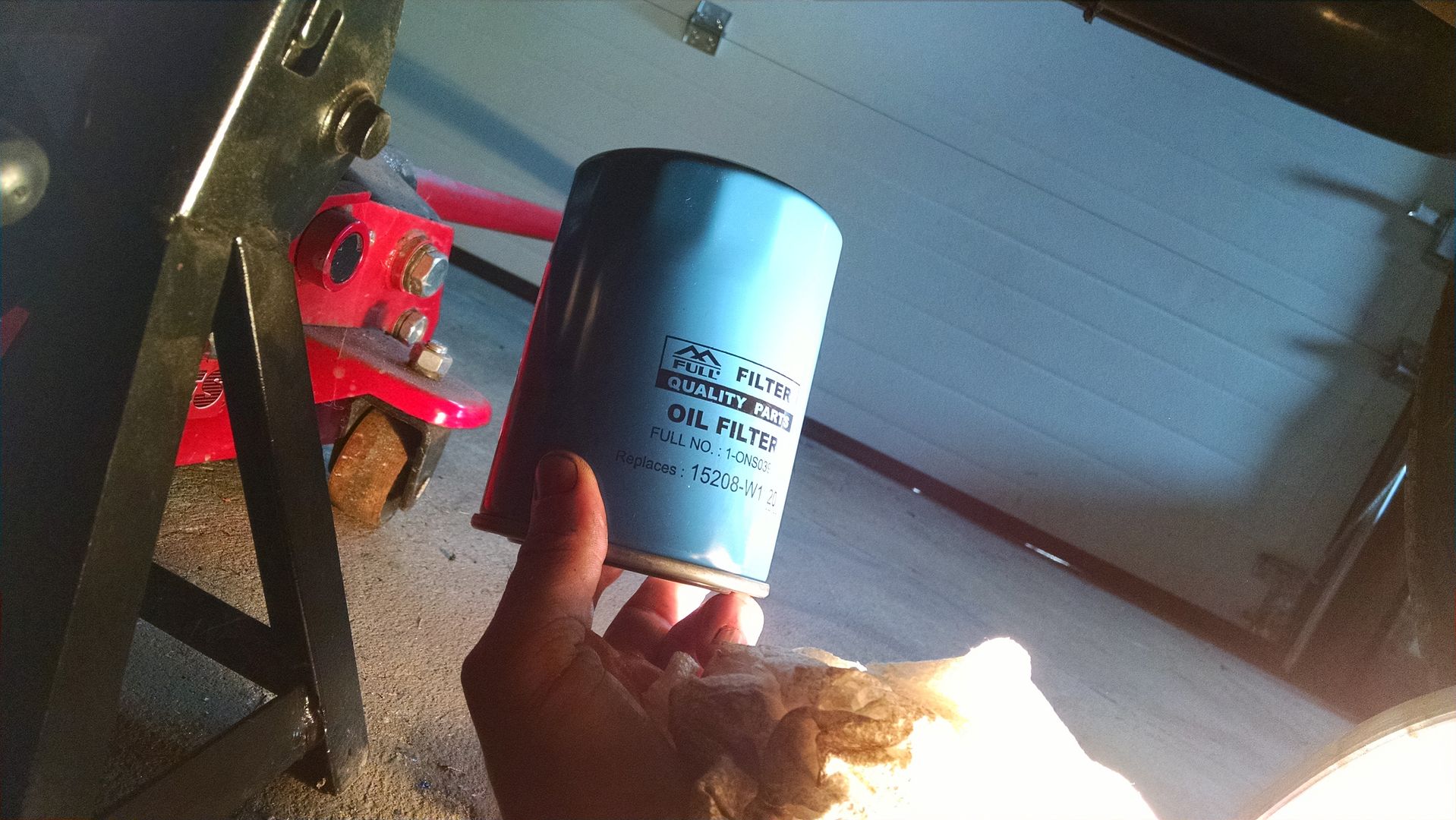

- Oil change - the turbo thanks me. LOOONG overdue. (+$30)

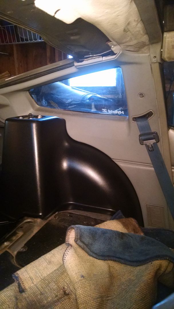

- And a 20 dollar interior 'refresh'  - that still continues currently. But here's some progress.  (+$20 - 3x cans of spray bed liner)

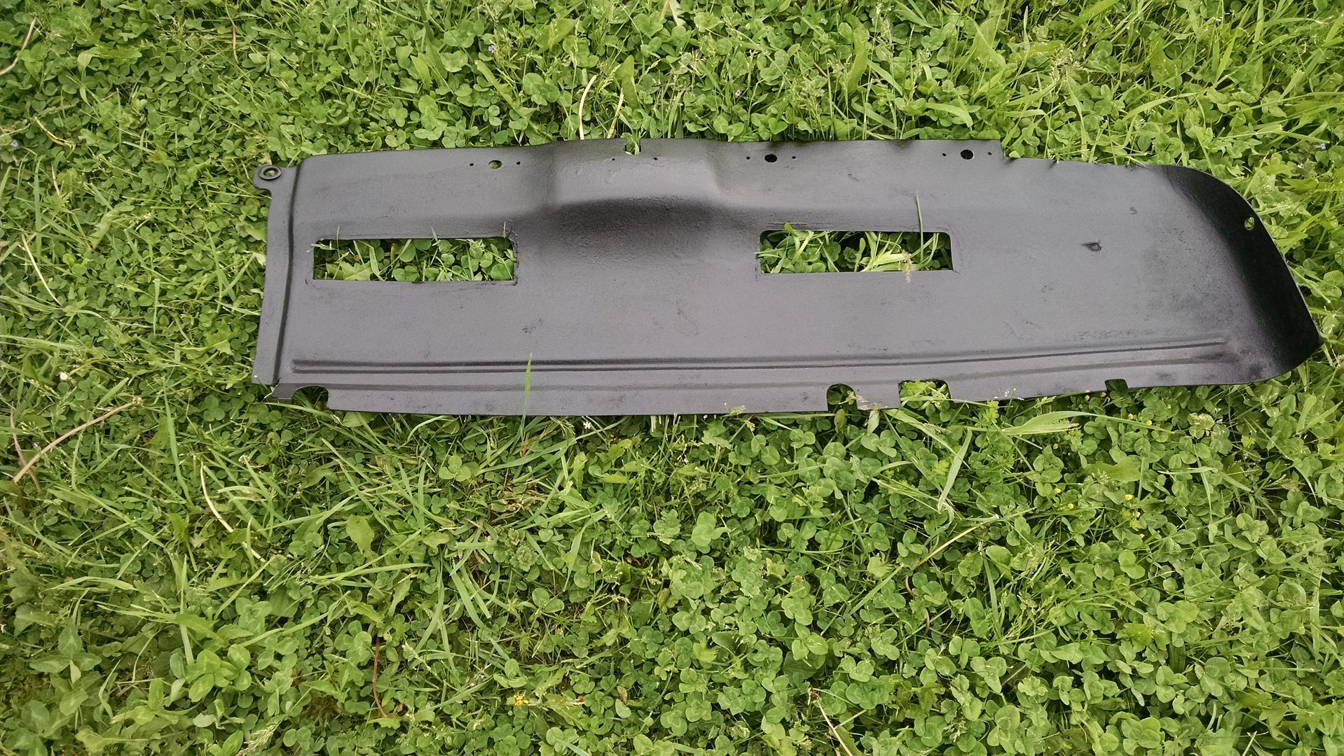

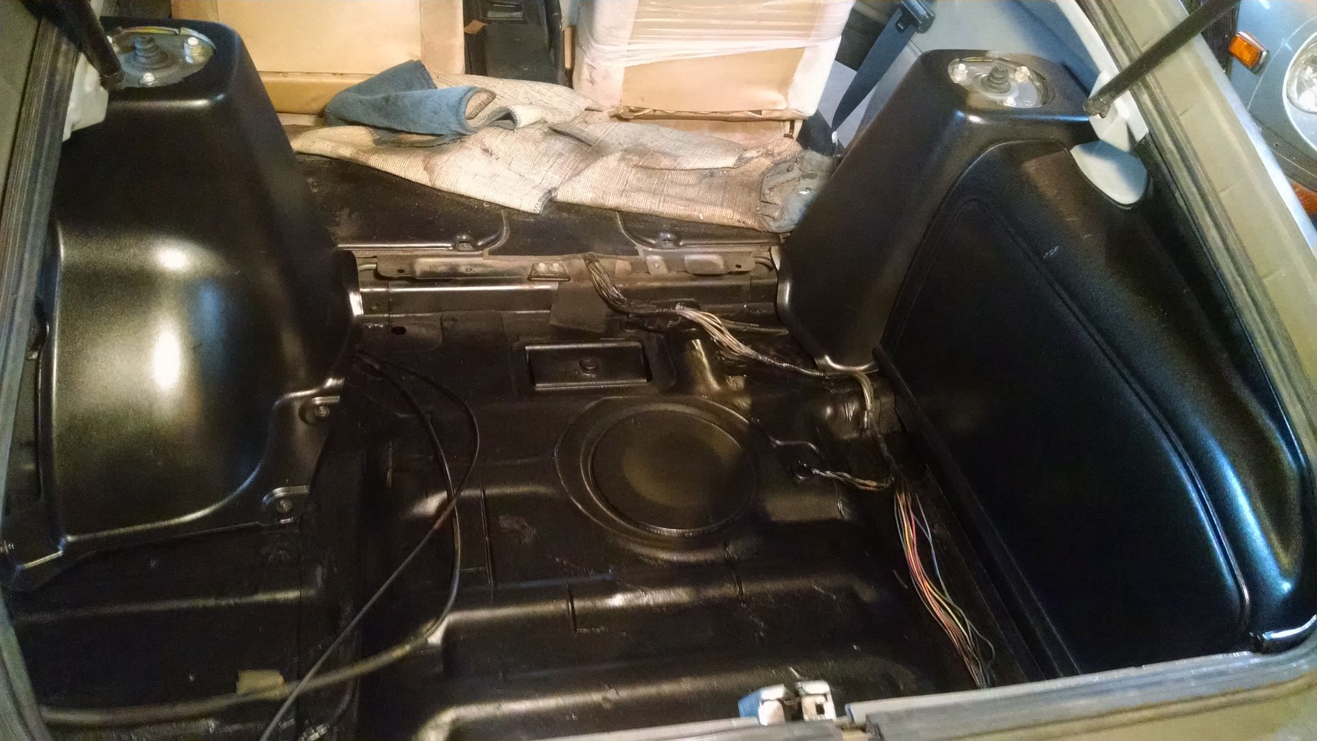

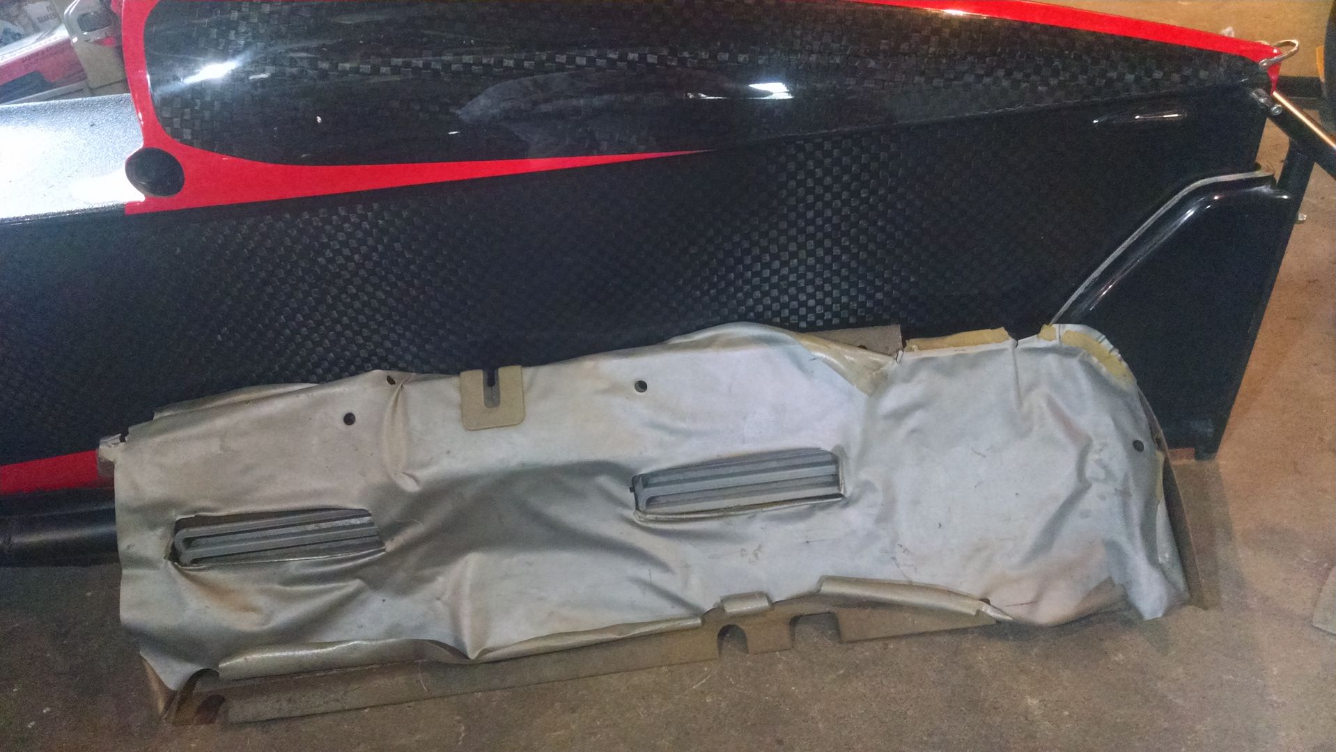

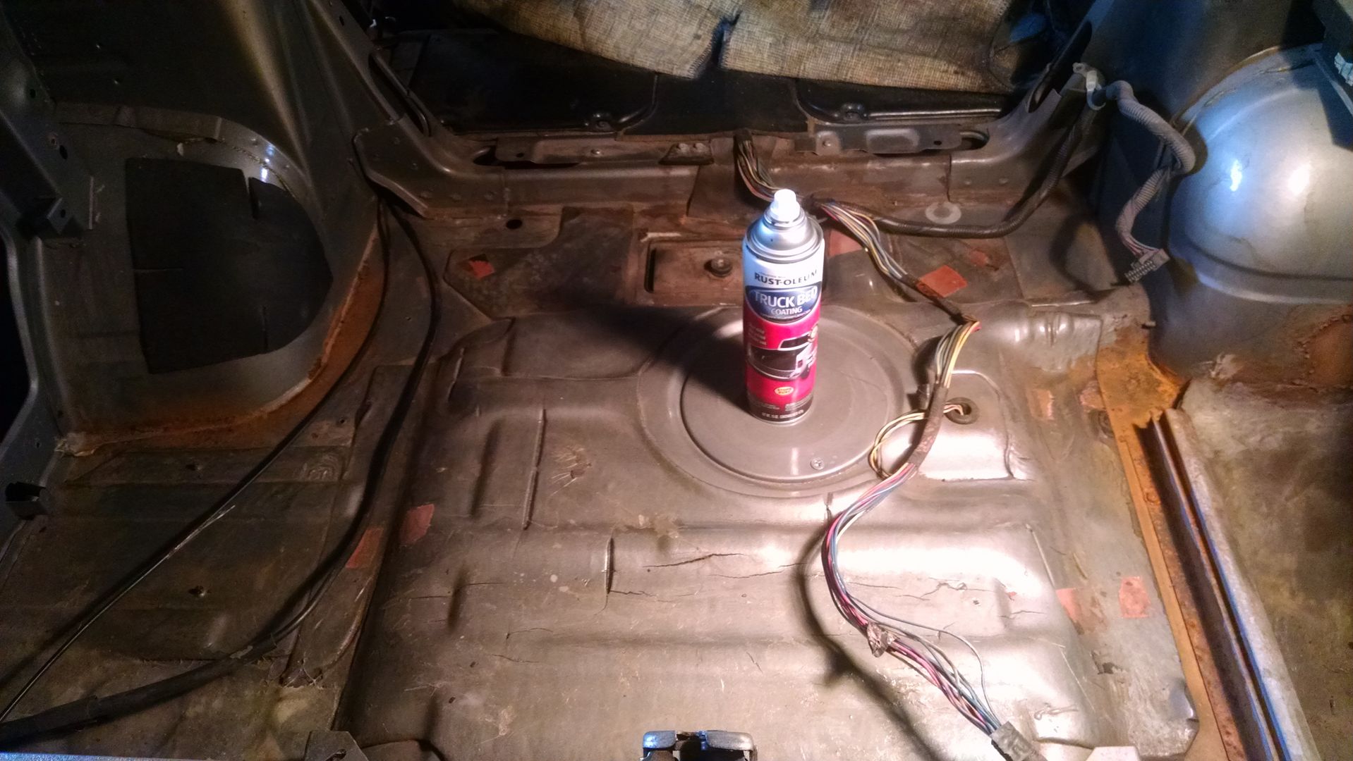

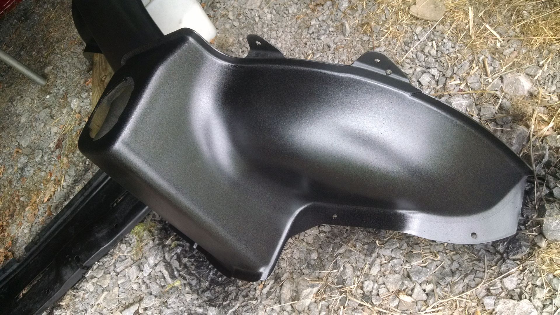

I sprayed the shock tower covers and the hatch area trim pieces with bed liner. I like the gray on black theme I've started. Nice contrast. Looks good*
*650 dollar car good
Initial pictures - I will replace the hatch carpet with black marine grade carpet, once the opportunity arises.
Here everything just tossed in place...Still lots to do yet. But at least it looks complete again. No more hanging/exposed wiring - nice.

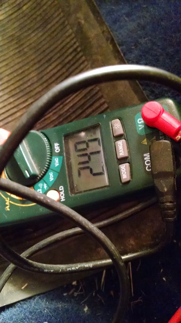

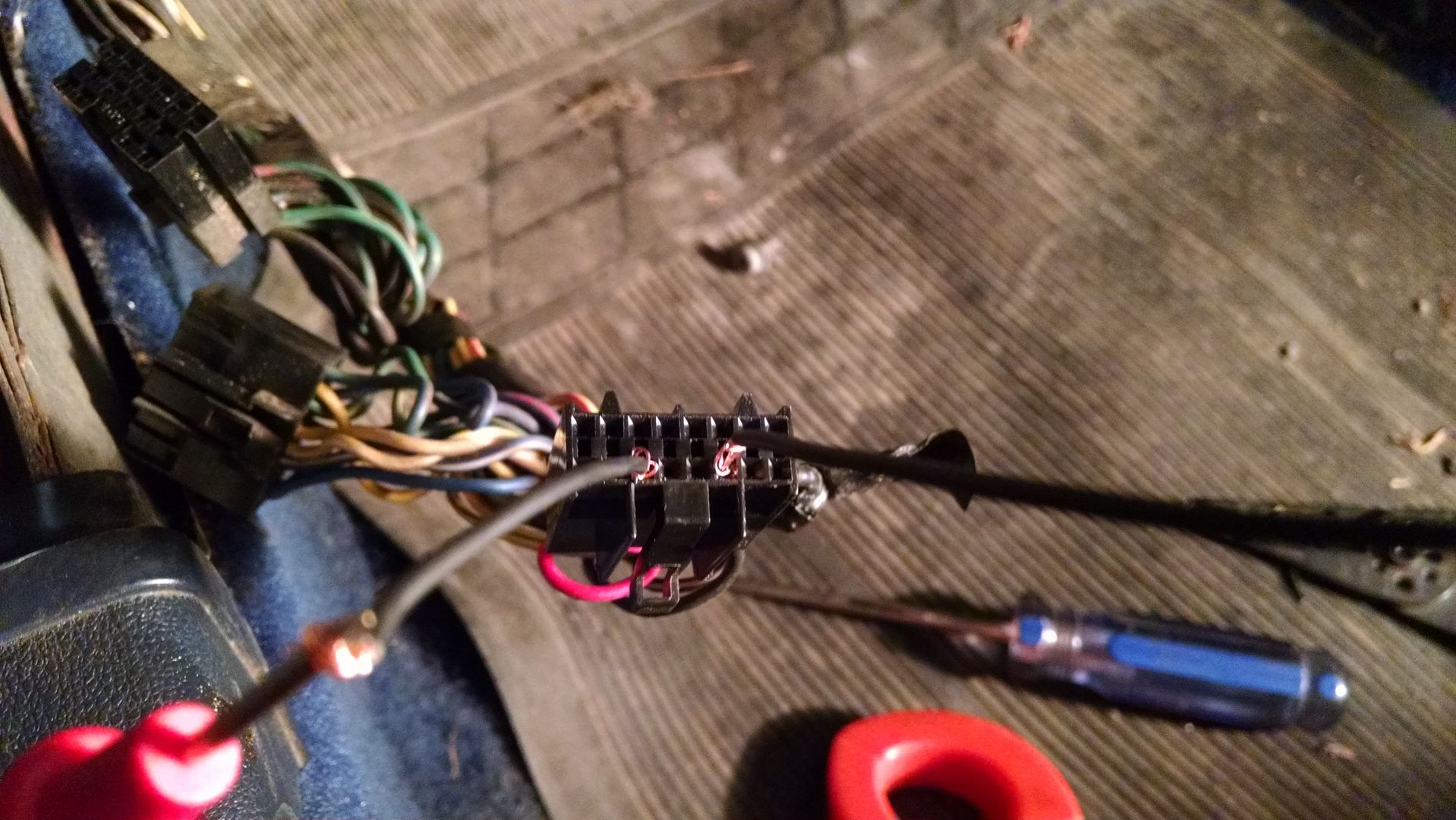

So after work today I decided to do a little diagnosing. Factory service manual to the rescue! Seriously guys, download it if you haven't.. It literally tells you how to fix your car step by step.
a few tests later...CHT sensor checked out. ECU was the next potential problem.
Confirmed my ECU was at fault. Luckily I had a spare from the 82 parts car.
Swapped in the new ECU. Half turn of the key...

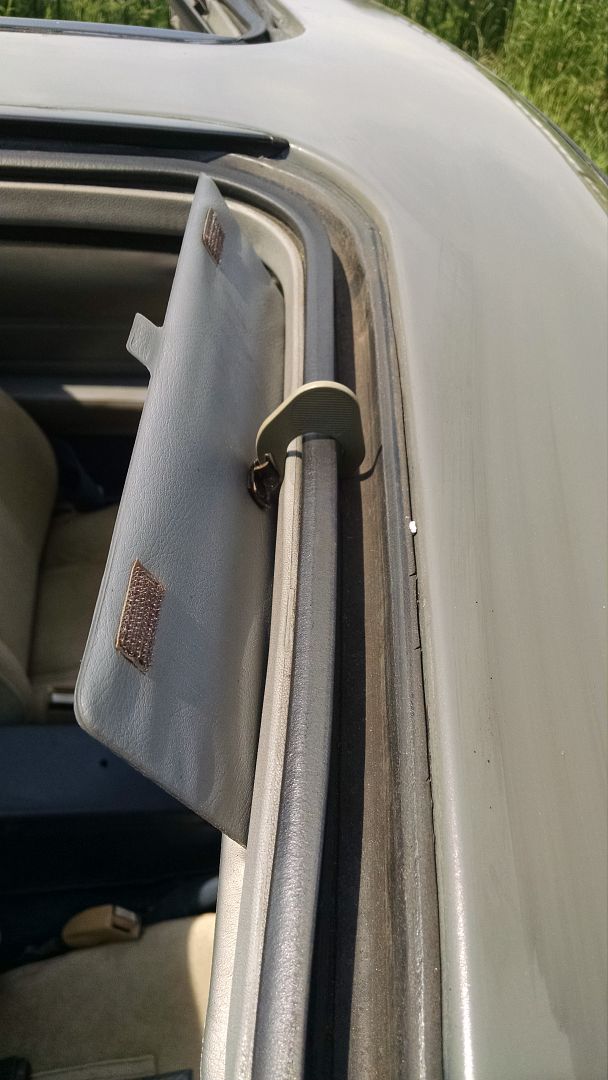

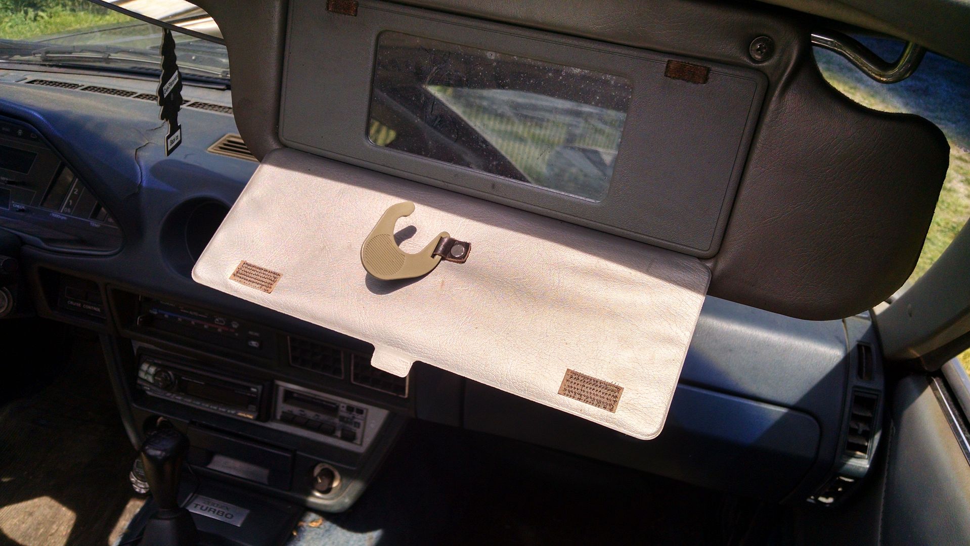

Got a chance to pop the T-Tops and finally utilize these really neat hooks that I had ZERO idea what they did until a couple days ago.
At first I thought: Tie holder? Obviously that didn't make sense.
IMG_20150605_145213824_HDR_zps3ifnzeau.j
OH! THAT'S where they go.
Keeps the wind out of your face. Works flawlessly, even at 80+mph.
Tip of the hat Nissan, that was clever.

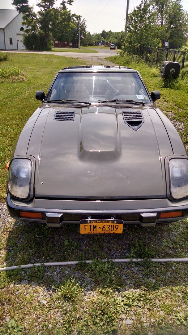

I've put around 500 miles on the car since I've started driving it again.
It's going great. Getting me all sorts of places.
IMG_20150613_183043894_HDR_zpsobeef9bn.j
Next step: NYS inspection and then alignment. Sweet!
