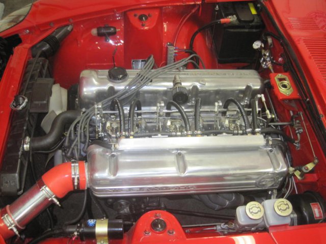

I know i viewed pics on this site of a guy who made a plenum out of a Z valve cover. Maybe finding those pics may help in your quest.
If you can get all your pieces together of how you want the plenum to look. You can always have a good aluminum welder, weld it all up for you. Maybe find a local out of work welder, send him more business if he does a good job for you.
Just some thoughts
I thought of doing the turbo route with my CAI valve cover, but thought better of trying to pressurizing mikuni's. You could use the valve cover with some minor welding by someone else. The tough part will be getting it to seal without having to come with more bolt down points. Not sure if my 6 bolts would seal to a backing plate during pressure.post-1083-0-27658300-1380854926_thumb.jpg

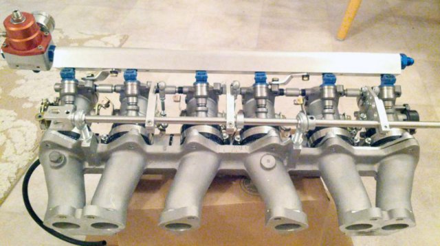

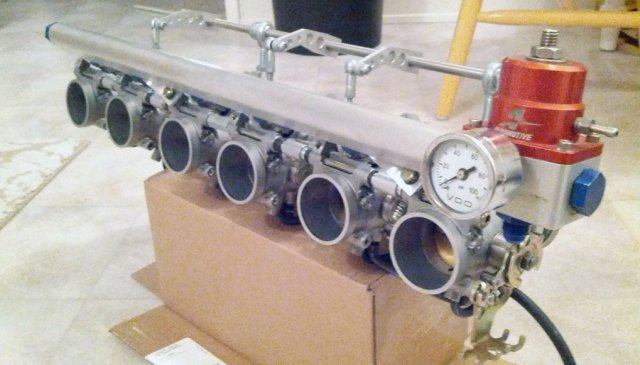

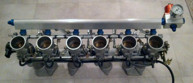

Thanks, they're 46mm Suzuki GSXR ITBs with DCOE adapters. I fired it up last Sunday, but it's still a work in progress.  I'm still probably a month or two away from driving it, there's about a dozen small problems to work through.
