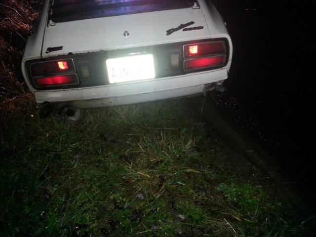

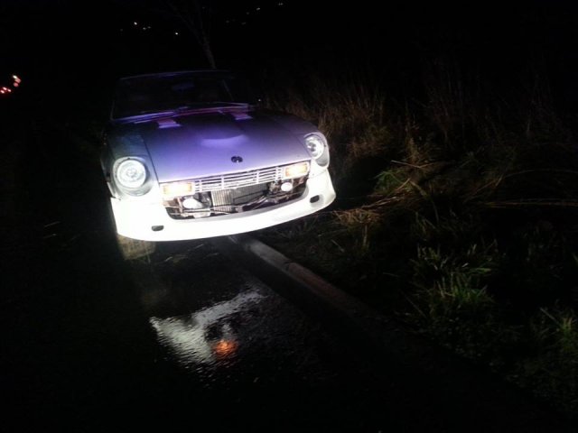

Today was going well: got off work, went for a run, it was raining so I could slip the back end out a little bit. Until on my way home, I took a detour in order to drift a little. Nothing crazy. Well go figure, I hit a super slick spot on a semi-narrow road so I spun completely around after counter steering. I ended up slamming into the curb, which was about 6 inches high and wide, while still spinning. My back two tires and driver tire were over the curb in the ditch.
Cops showed up to make sure I was okay and access the situation. They didn't do anything except tell me to stay out of the road and give me a break on my ticket. The officer could have cited me for negligent driving ($500) but instead only gave me driving too quick to conditions($175) as the road was fairly wet and nobody was hurt. Tow truck got there and pulled me out after dragging me along the curb for almost twenty feet until I showed him the better place to pull the car from. He ended up charging me $271 after also giving me a break because I didn't have more than $261 in my bank account. The actual price would have been over $300 without taxes because the car was in an "accident".  I actually just couldn't move my car because the rear wheels weren't on the ground. It did drive though.

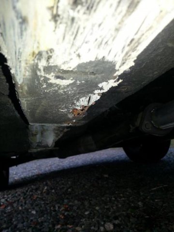

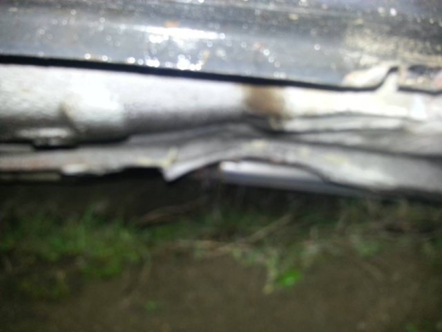

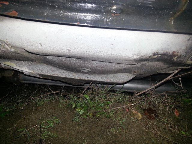

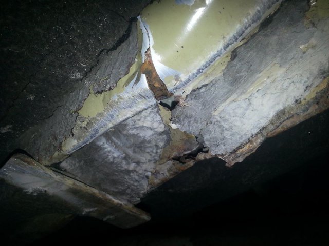

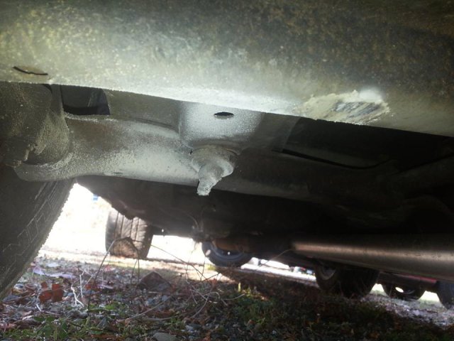

The total damage that I could assess in the dark while the car was pretty much bottomed out was overall fairly minimal. The engine compartment seemed fine besides the battery flying over and disconnecting. The fuel tank had a dent in the bottom about eight inches in diameter. The rear driver wheel was definitely not in its correct position, and the entire rear end was squatting. The rails are my main concern. While not in the greatest shape when I acquired the car, it looked like I bent them on the curb pretty bad. The damaged portions were flat with the body and possibly a little above the bottom of the car. The passenger rail split open in a very small spot.
So my options are to fix what I broke, swap everything into a new shell, or just part with it all which I truly do not wish to do. Fixing it could require straitening the rails, pulling the dent out of the tank, and possibly getting new suspension components. Swapping my parts into a shell could require any where from just the motor/tranny to almost everything. So what would you do? What are some pro's and cons of each?
I have attached a couple pictures of the crash at the scene. I will take better pictures tomorrow in the daylight to give a better understanding of the damage. Sorry for some of the blurriness as I was fairly cold in awkward positions to get the camera under the car. On the last picture, I was shooting blind. So the damage is on the left edge.

If the frame is bent where the suspension attaches, the alignment will be screwy and it might be unsafe to drive. If it looks OK underneath but the floor is and rail is dented in the middle, that's not a big deal.
What Jon said and, if your alignment is too screwy, you could chew up one or a pair of tires pretty quick.

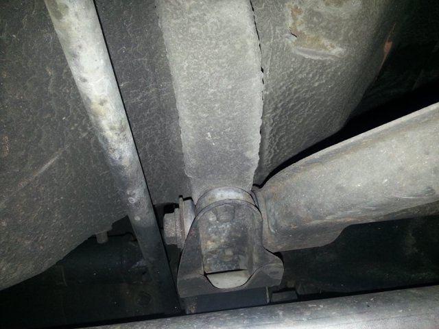

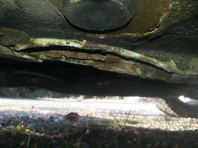

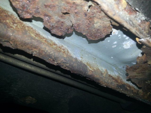

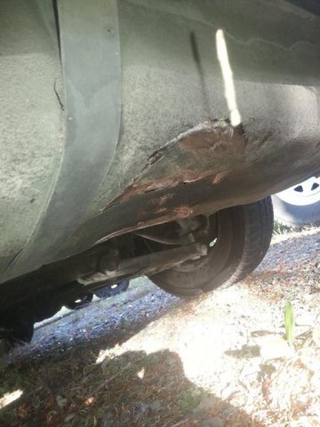

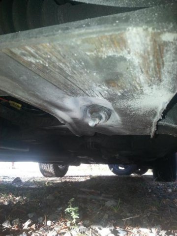

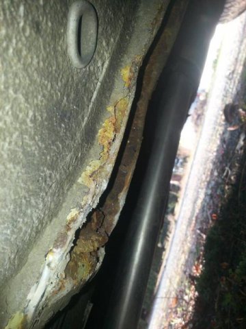

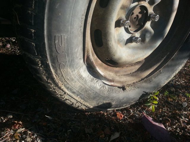

So I went to look at the car today while it sat at my uncle's house. I lifted the back up and got these pictures. As you can see by the wheel, I hit the curb fairly hard. The fact that the tire hasn't tried to remove itself from the rim is surprising. The control arms seemed to be fine except for where the sway bar attaches to. I didn't spend much time in the back before this so I'm not sure if where the sway bar bolts to is supposed to be crooked or not. You can also see the amount of rust on my rails. The holes weren't there before this incident. The rust hadn't eaten all the way through at that point. Or it seemed that way. Doesn't matter now anyways.
The suspension pickups seem to be completely fine though. The only indication the suspension was damaged, aside from the sway bar bolts, revealed itself in how the wheel sat with weight on it. The passenger side rear had a lot of toe in both jacked and on the ground. The driver rear tire had more negative camber than the passenger side.
Overall, it seems as though the damage was not too extensive. Seems is key. I wouldn't drive it very far (more than 100ft) without being inspected by my mechanic. He is some what a mentor as my his experience level far exceeds my own.
Anybody change their mind about the advice Jon gave me? Should I be looking for a different shell or just replace the rails and move on?

I was thinking about trying to tease you, but that would be hypocritical. I too, have made an off-road excusion going backwards into the trees. Luckily I missed all the trees (and it was all luck), but I broke two rims and my airdam when I smashed into a curb on the way to the woods. Also snapped the rear cast iron strut off below the hub in the webbing near the spindle pin. I replaced the broken strut, had the wheels straightened fiberglassed the airdam back together. Still driving it-evidently the chassis wasn't hurt. Your biggest problem is rusted frame rails. If I were you I would replace anything visibly bent and get back to driving it. Start budgeting for some rust repair. Now about that wreckless driving. I'm older now and I get my rocks off driving on the track. In fact, my street tires are so skinny that I'm afraid to take a corner any faster than other folks in traffic-I just sort of putt around driving to and from work-any more than that brings out the guys with the blue lights. "Drifting" is for guys who really don't care about their cars. If you want to jeopardize your nice antique car, think about getting a clapped out Ford Escort-they do great handbrake turns, and you won't lose anything you cant live without. With street drifting, it isn't a question of "if", it is a question of "when" and "where." You are gonna wreck.
I appreciate the tact, and you're right. It definitely isn't something I should be doing with a car I really care about. I had on the original rims and semi-bald tires on the back to have a little fun but took it too far. I had planned upon going through the suspension after selling the Honda and knowing my ship date for the Air force. At the moment though, I can't fix the bent pieces until I save up some more money. I think I will just put it in storage for now until I know what's happening in my future.
As for rust repair, I think replacing the rails would go a long way. There are only a couple spots that need attention without going over the entire body. The rails and control arms seemed to be the only important pieces damaged that will affect it driving. I also havent looked over it with my mechanic yet. I want to get his opinion before anything as well.
