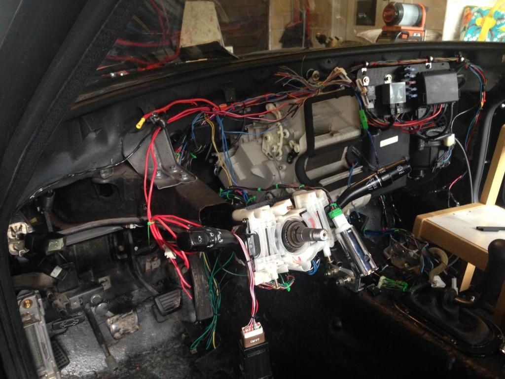

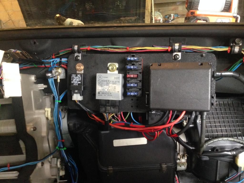

Not so fine is the progress of the electrical system.
I actually had everything hooked up and functional but the layout was appalling and like most of my projects, I could see improvements that weren't obvious until I'd built it. So, I'm redoing the entire dash/firewall area.
Fortunately, this time I can concentrate on just the physical routing/component siting as all the connections have been figured out.
I also came upon some components that will make things easier and neater, it's really amazing the cool widgets hidden in the junkyard.

I spent another two weeks or so on the chassis electrical but finally got it all functional.
As it will all come out to install the soundproofing, I've waited on most of the looming as it's easier when not constrained within the cabin.

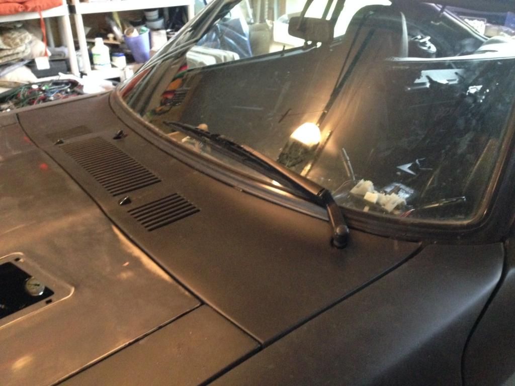

Along the way, got sidetracked for a week or so inexplicably obsessed with the wipers again.

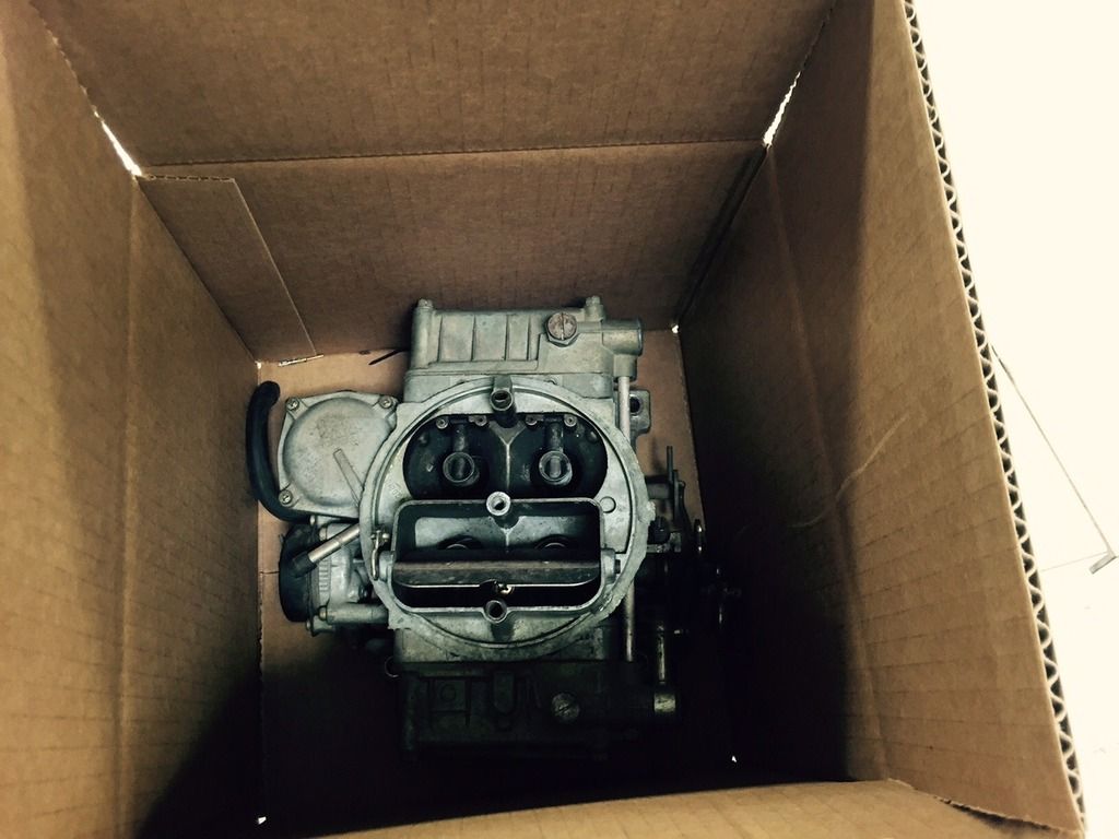

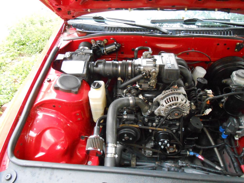

Finally got around to modding the intake on my daily (1990 RX7 GTU), which I'd thought about for years:
When suddenly, this shows up:

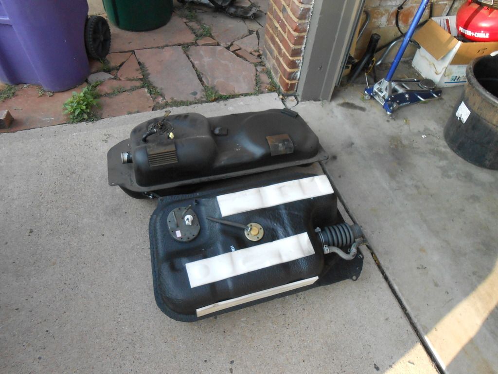

Moving from FI to the carb triggered a whole cascade of changes.
The most difficult (primarily due to working solo in a severely underequipped garage) was swapping the fuel tank to a RX7 unit.

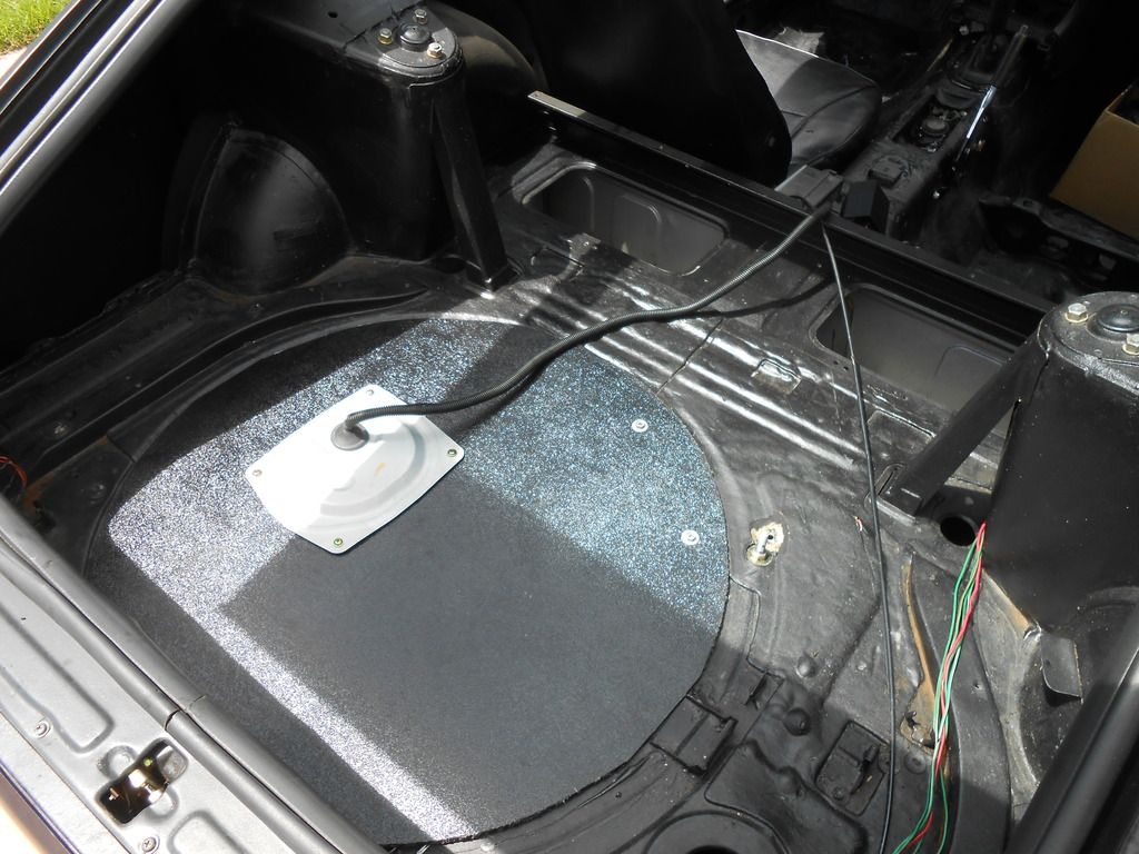

I've long wanted to do it; we gain the ability to run a dual exhaust should it be desired, it eliminates the clunky vent system, the fuel senders are compatible with the Miata gauges and best of all, it has an internal pump.
Here are the tanks together:
(the tanks are reversed here...the fill ports are actually on the same side)

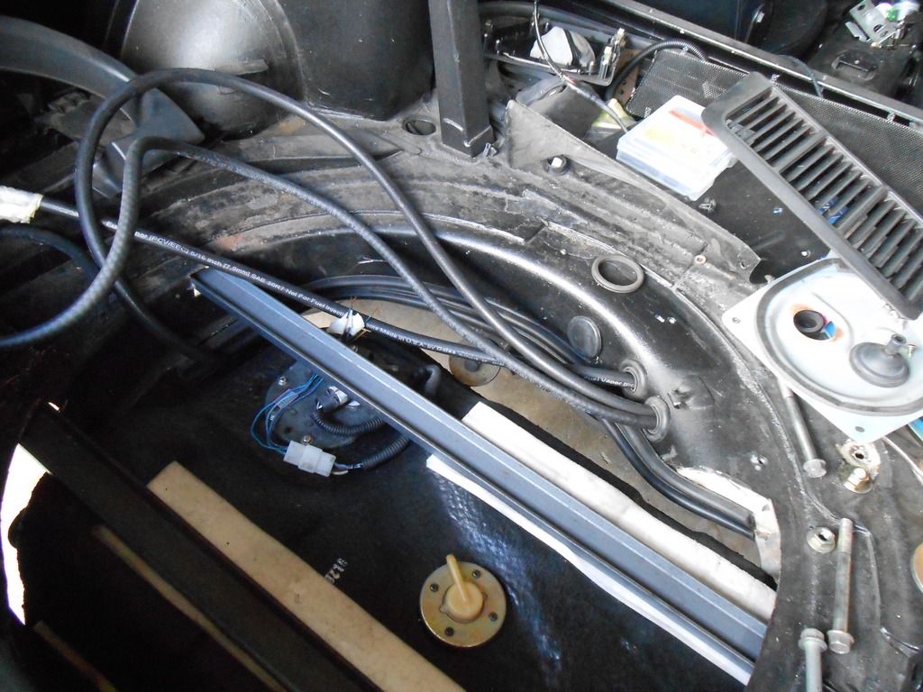

I used the fuel pump from a 1976 Toyota Corolla, turns out it's kinda hard to find low pressure, in-tank pumps but this one is perfect.
And, after lots of fiddling about, it fits:
I used one piece rubber hoses from the tank to the engine bay after deleting the ancient janky original hardlines.
For the run under the floorpan the hoses are encased in aluminum tubing from Ace Hardware Racing.

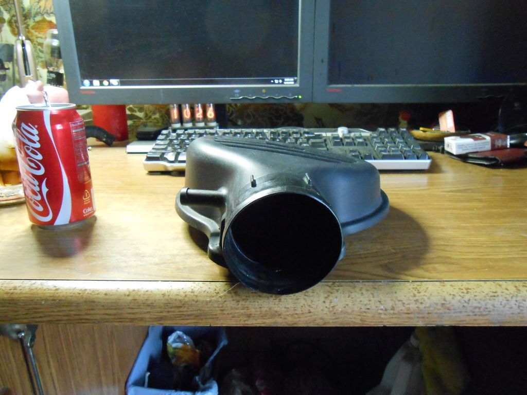

We had the Arizona Z recommended pancake filter but our 280 hood has a vent directly above the filter.
Seemed like if it rained, we'd just be gobbling water.
Figured I'd use the low profile Spectre top hat but before investing the $100, I checked my favorite parts supply- the junkyard.
And found this:
It's off a Dodge Dakota and after some trimmage and stuff, it's fits beautifully.
I finally got motivated to build the efan setup...I've had the fan/electrics for two years now.
The shroud is made of sidepanels from a Lian-li computer case (nice 3.5mm aluminum), the fan and relays are Volvo and the fan trigger is a BMW part.
The bay now looks like this:

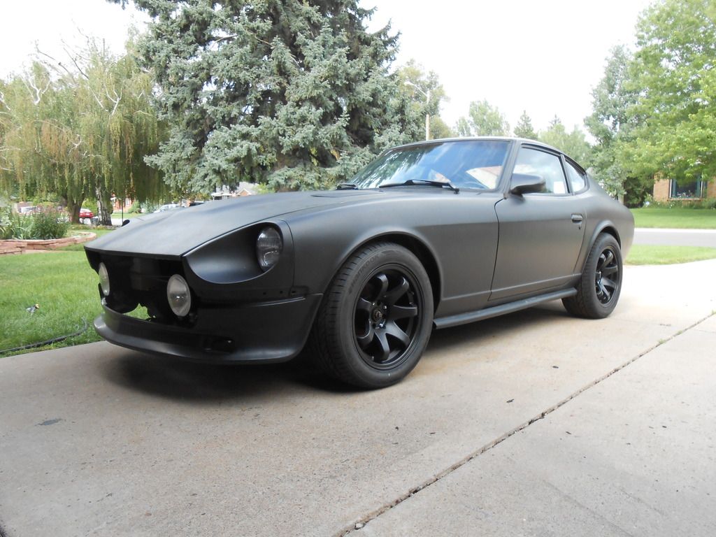

And as she sits today:

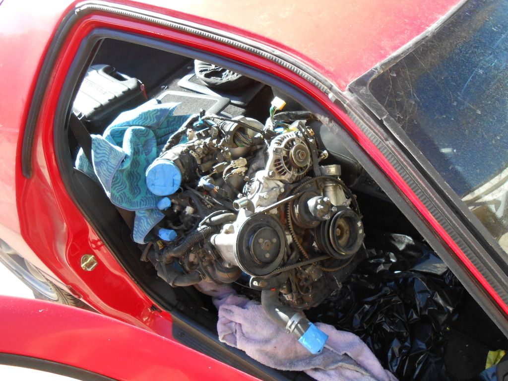

I finally found a replacement engine for the Mazda, at nearly 300k miles mine is kinda tired.
I'll be using all my manifolds/ancillaries, so this needs to be stripped to the keg and cleaned up.
I hope the current engine keeps working through the winter so I can refresh the replacement at my leisure and deal with it when the weather isn't actively trying to kill me.

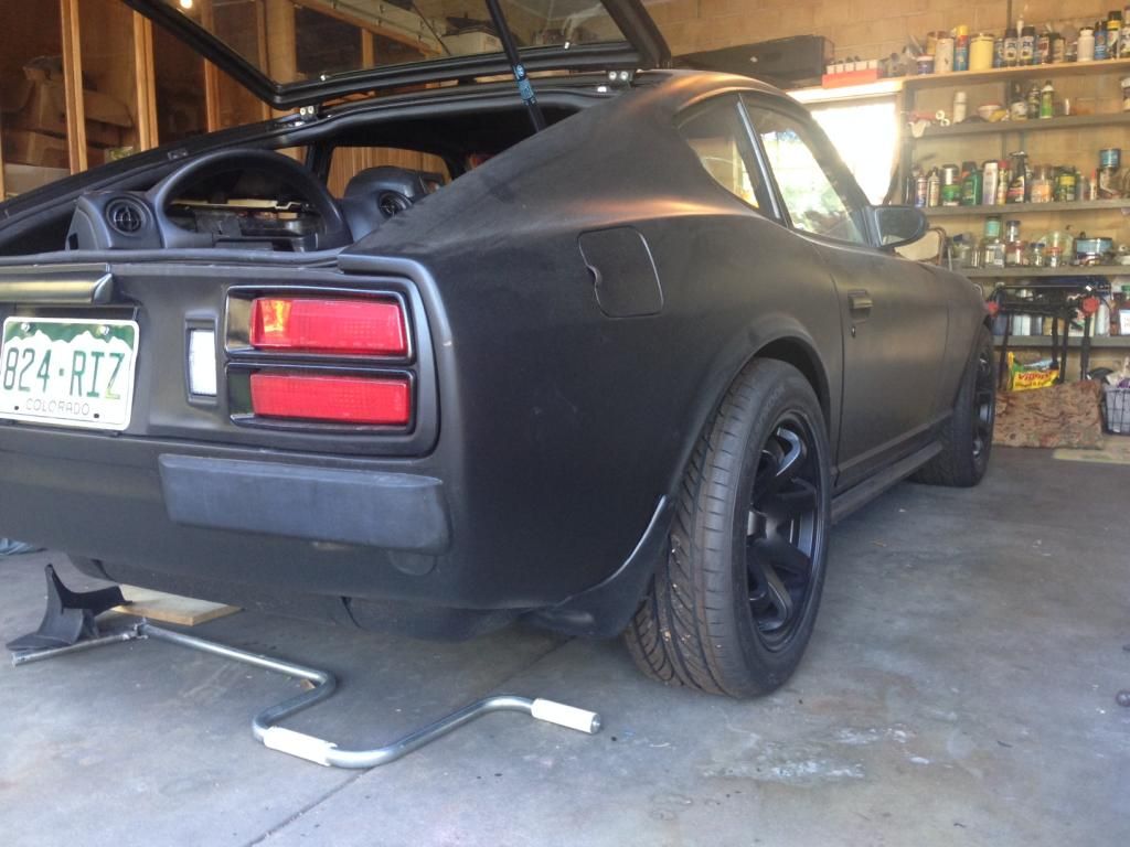

Sigfrid's California experiment has ended and his return to Denver has accelerated work on the Z.
Losing his company car means Ratchet is his daily and that meant getting her more functional...like seatbelts, for instance.
We spent two weekends getting to this point:
The seats are Honda (Prelude, I believe), that I've had for a few years...not what we want, but good enough for now and worlds better than the Datsun originals. The seatbelts are from the rear of a '88 Mercedes 300 sedan, steering wheel is Audi A4, switchgear is Lexus and dash is Miata.
Everything works.

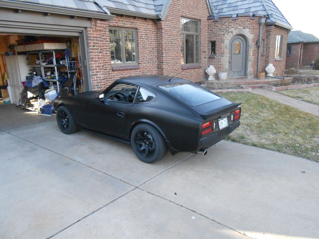

She looks like this now, I'm surprised how well the Plastidip is holding up but S. still wants "real paint", so that might happen this summer.
She runs well, no leaks/drips and the interior continues to be bone dry...very happy about that.
Still a lot of interior work to do but at least the major touch points are fixed and she's comfy to drive.

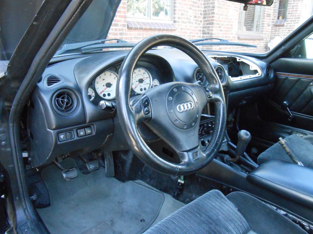

Sigfrid was to begin his new job on Feb. 18th, so we went into overdrive to prepare the Z for daily use...basically, we wanted Stage 1 of the build to be complete.

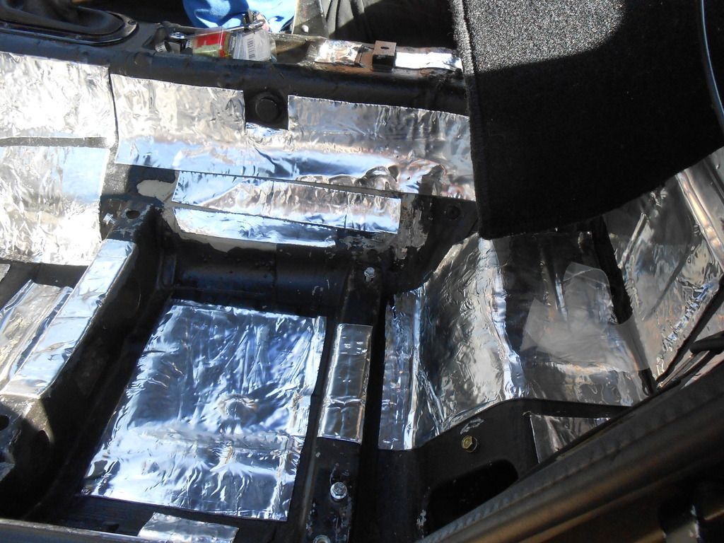

The main project was the interior and that had to start with sound mitigation. S. investigated various options/strategies and chose a two part option. This first layer is a heavy, foil backed sheet (NOT roof stuff from Home Depot) that is selectively (and from the pics, apparently randomly) placed on panels to dampen booming and vibration.
You apply a piece, rap on the panel, then apply more till the panel is acoustically "dead"...it seems capricious but actually works amazingly well. Then the entire interior is covered with a thin black foam layer (also adhesive backed).
You can see some of the foam just under the front glass at the firewall top.
(The wiring was cleaned up and rerouted quite a bit after this pic. We wanted to use a Miata center console and to get it aligned with the dash centerstack the dash had to move a bit, which meant the entire HVAC system had to move a little bit and in the process, the electrical moved a lot. Along the way we refined the bracketry/hardware and the dash is very nicely solid now...no creaks nor rattles.)
We changed the seats for some different model Prelude chairs, which we painted black. We consider these seats temporary and the risk of paint was outweighed by the visual payoff, so we did it.
Actually turned out much better than I'd expected- coverage was good and although the nap is stiffer, it's not really objectionable and time seems to soften it a bit. We'll see.
Along the way we added some finishing touches...
And we finished up here:
There are still some aesthetic issues to address- the door cards need recovering to match the interior better and we don't know what to do about the rear strut towers yet but the interior is almost 100% functionally complete.
I consider it a complete success, the cabin is (nearly) Lexus level quiet and comfortable. Certainly better than you'd expect from a 40 year old car.

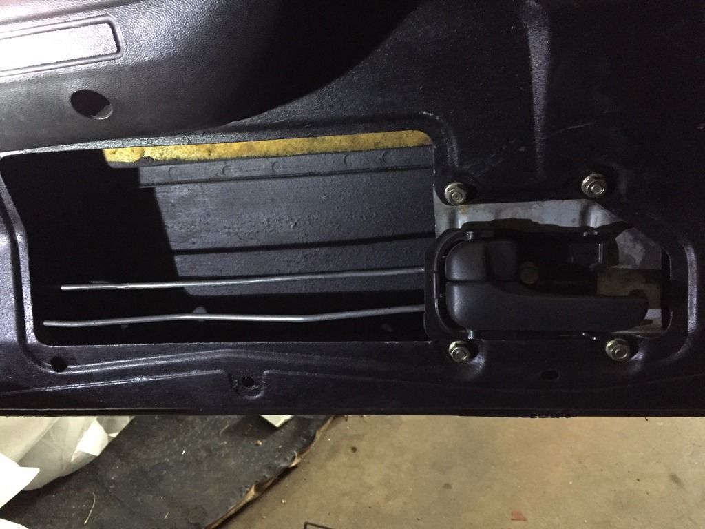

I still have a few loose ends to tie up- the rear hatch release and getting the turn signals to self cancel and we need to get the windows tinted (for heat control as well as looks).

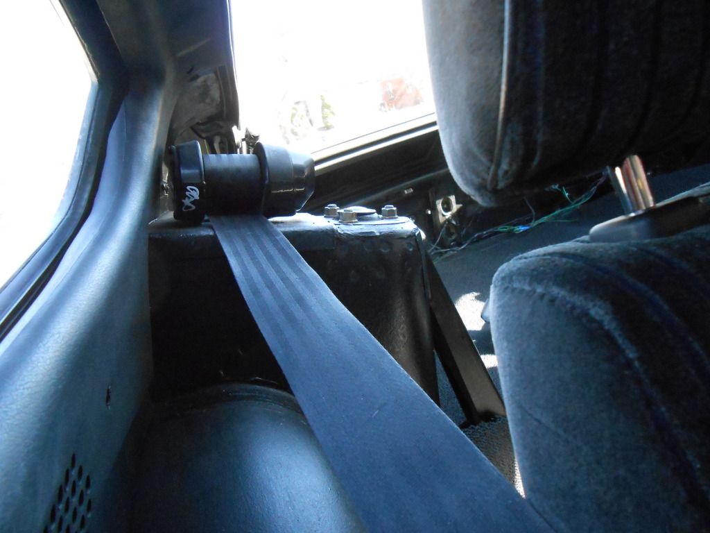

Progress has been fitful since the last update, but that's mainly due to the fact that Ratchet has been driven a lot and pretty much everything works.
Most of our effort has gone towards chasing down the random creaks/rattles/glitches that only show up after some use and we've pretty much got her locked down finally.
On my theoretical wish list is a revamp of the electrical system. It all works but I can see several methods to clean up the install and eliminate some unneeded complexity and we are contemplating a return to FI, but only with an aftermarket ECU, so that would be a big change anyway.
More practically, we finally decided to enter the great unknown and attempt to revamp the doorpanels and create some way to dress the rear strut towers.
We basically made up a technique to shape the panels, involving spray expandable foam, fiberglass, foam sheet and vinyl and after a few weekends came up with this:
We're testing this out for fit and comfort before finishing the other side but it's looking pretty good so far.

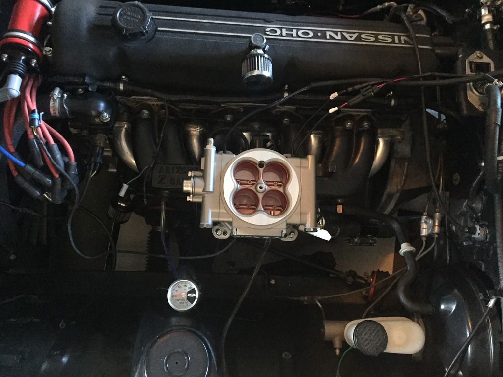

Well, she survived the winter just fine and everything continues to work.
The only real issues we've had are all carb related and we finally decided that this worn out old Holley just wasn't gonna cut it, so we got this:
It's a FI Tech fuel injected throttle body with self contained ECU...https://www.summitra...parts/FIF-30003.
Install is set for Saturday, we've been gathering parts and prepping for the last few weeks...it should be pretty simple.
We had to remove the headers to get an O2 sensor bung welded on and will have to replace the low pressure fuel pump and hose with high pressure stuff (we're hoping to use the stock RX7 pump that came in the tank I installed) but I hope she's running again by Sat. night.
This will not only make her run better (hopefully) but more significantly, signals a commitment to the stock drivetrain, which we've always considered swapping out. With all that uncertainty removed, progress can logically continue.
I hope.
