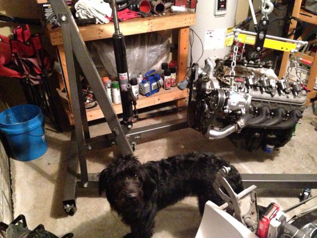

Well, I got her back in for hopefully the last time on the turbo fire up! Engine bay has been touched up with paint, new AC bulkhead installed, rubber grommets patching up factory AC holes (1/2" solid plugs), 90* elbow on AC drain hose, remove surface rust off passenger side frame rail, wrapped Datsun harness with insulted heat wrap on passenger side, cleanup wiring crimps with solder and heat shrink tubing, cutoff factory engine bay metal for more turbo air filter room. Then I prepped the transmission and motor for install and it went in smooth! Lol. Time to cleanup the heads and valley cover due to bad intake manifold gaskets and no catch can system... There's a coating of oil in the intake... Hoping the morose parts I bought will solve this issue.
