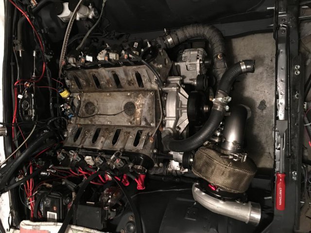

I've not posted in a while but I'm in the tuning phase currently. Had some small tweaks to figure out before it would react to my changes but now that I've got that glitch out of the way all I can say is WOW! I've never ridden in a 500-600 hp tin can before but this thing screams! Had a 10 lb spring in and boost creep has me a few pounds higher so I'm going to lower the spring to 6 lbs and hopefully keep it at or under 10 lbs of boost. It literally blows the tires off of it, granted I'm only running 225/50/16's.
I'm just amazed at the power. My Duramax is no longer the fastest vehicle in my garage lol. I love this car! It turns heads and will blow the doors off nearly everything it seems lol!
I figured up about $3120 including $500 for hp tuners so hard parts and fluids equaled $2620. Worth every penny. If I ever have time I'll load up a parts list with pricing breakdown.
In the past it ran around 186-200* and now it's 200-220* with the higher temps sitting in traffic and as soon as you take off it cools back down to 200. Being out of boost driving to work and around town it's super streetable and I still have the factory cam installed. I have an ls6 cam in a box in the garage if I want to crank it up some in the future. I feel that the rear end will need updating to an 8.8 before I up the power anymore with the 6 speed.

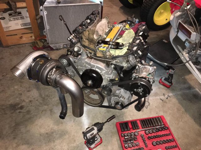

Thanks for the complements and yes it is a blast to drive! I hadn't realized how much I missed driving this thing but after a 7 month hiatus for the transmission rebuild and turbo add on it was well worth all of it. Actually drive it to work yesterday for the first time since late October 2015.

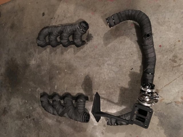

Well I've been driving/fixing the tune and have ran a 1/2 mile event earlier this month with RenekahsZ! Being able to run wide open without a speed limit is just flat awesome. Sadly I only made 1 shake down pass up to 5k rpm for 5 gears and ran 125 mph. I'm currently waiting on new clamps for my wastegate downpipe because I blew it off between the 3-4 or 4-5 shift on the track. I want to drive this car every day!!! I am only running a 5lb spring right now and it is very streetable but I've had a 10 lb spring installed for a short time and it is a completely different animal! Ridiculously fast which was the goal! Probably only 500hp but I drove this thing with a straight 6 for a while... I highly recommend the turbo after the v8 install. Next will be hooking up the AC lines again because the turbo setup rearranged my crimped lines. Hoping to gap rings on the next 5.3 I will be getting soon and a sloppy mechanics budget build boost ready engine to swap in sometime. I already have an ls6 cam to put in! :) keep turning those wrenches! It's worth it!
