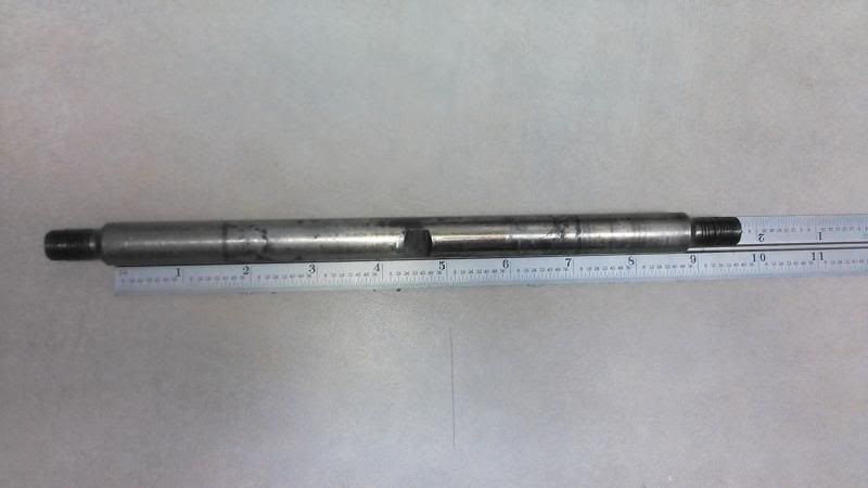

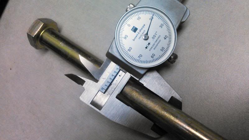

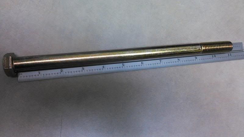

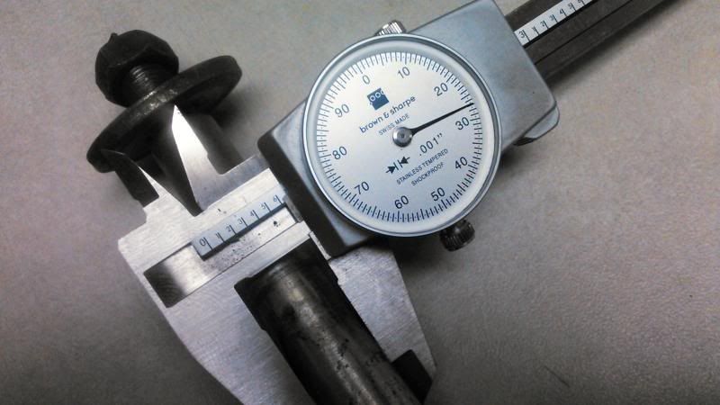

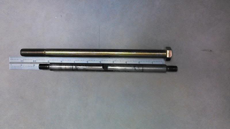

Having pulled my spindle pins three times in the past few years and somehow managing to save them. On my last attempt I finials messed up the threads to the point were replacement was going to be a must. Having done some digging around I decided to go the 5/8 bolt route There are many people who say do not do this but if you look at the techno  tuning toys rear lower control arms. Granted they are using a hime joint they use a 5/8 bolt. On these grounds I set off to find the right bolt for the job and this is what I came up with. From Fastenal a 5/8-11 x11 yz8 haven taken many measurements and driving the people at Fastenal crazy we decided that this was the best bolt for the job at hand. I hope this helps for anyone considering doing this swap and any info on pros or cons would be appreciated. And here are a few photos of the bolt I will be using. And they cost only $12.90 each . Fastenal part #15335

Be thoughtful about it, though...file a flat in the bolt and put the lock pin back in place. You do NOT want the bolt spinning in the upright, you want the bushings to be turning on the bolt. Otherwise the bolt is metal-on-metal and rubbing the upright. You want it metal-on-bushing and stationary in the upright.

Just had an interesting throught about how to keep the 5/8 bolt from spinning in the housing. How about tapping the lock pin hole in the strut and threading a bolt in to touch and lock the pin in place. Easier than trial and erroring a slot in the bolt that the original lock pin will fit into. I feel like that also weakens the bolt. The stock lock pin has 8x1.25 threads, which pass through, so likely have to drill and tap for 10x1.25. Common bolt. Do it from the bottom. What do you think?

I was having a similar thought, and am currently investigating some options on locking the bolt. And will post my findings soon I hope I am ordering a second set to test on and see what works best. I work at a manufacturing facility and have access to a full machine shop and they are currently working on notching the first set for stock lock pins. And the second set we are kicking around ideas on how to lock the pin safely only using tool most have at home. I will let you guys know what we come up with, and please keep the input coming we need ideas.
