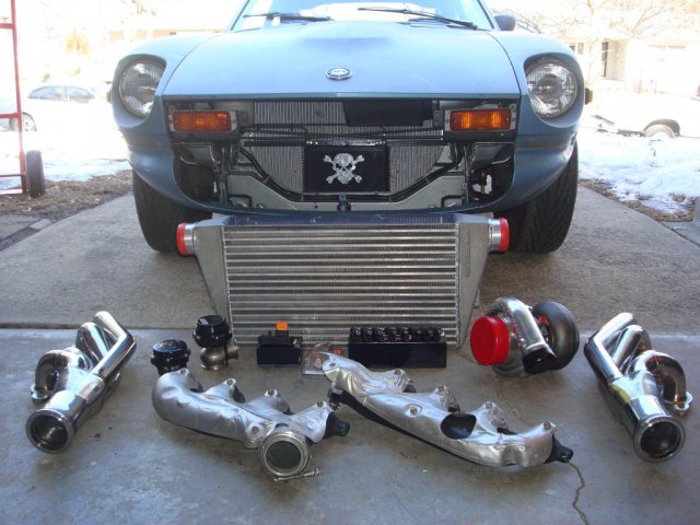

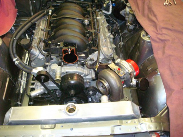

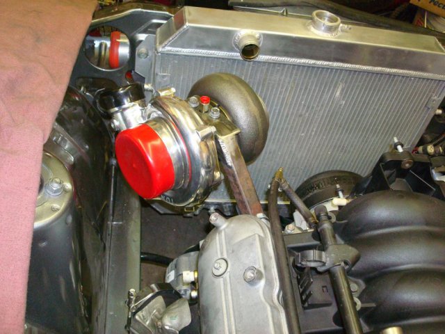

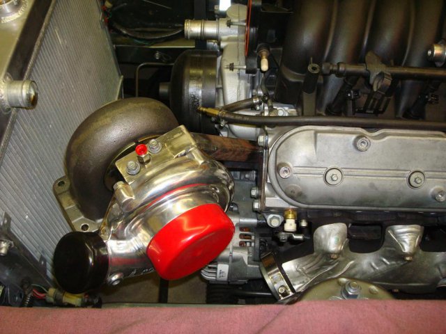

Here is what I'm starting with
A few parts

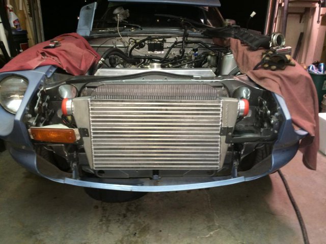

Partially installed intercooler. I need to order and install a few pusher fans in front of the radiator so it's just sitting in there till I know what space the fans will need.

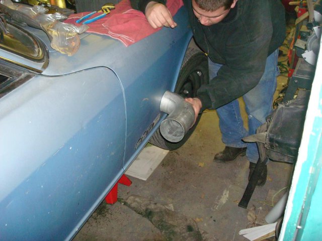

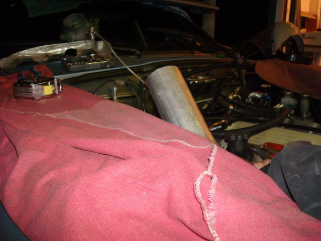

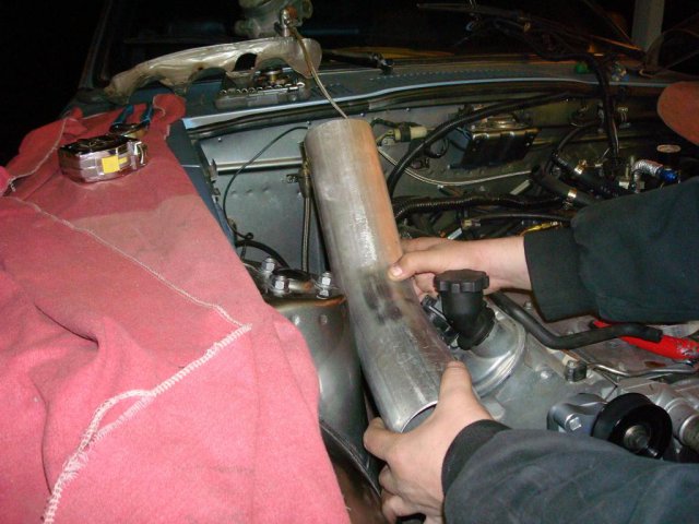

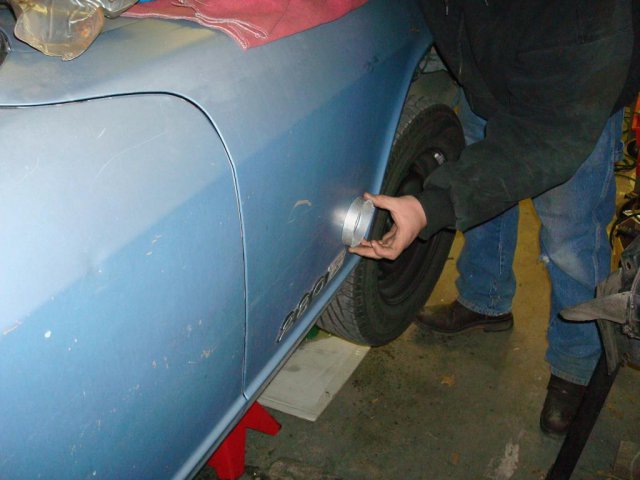

Here are a few of the ideas we had for exhaust outlets.
Bull horn out of the fender
short and stubby out of the fender
Flush cut out of the hood vent

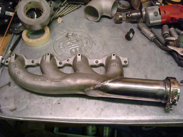

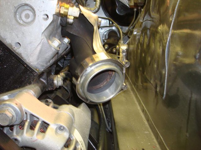

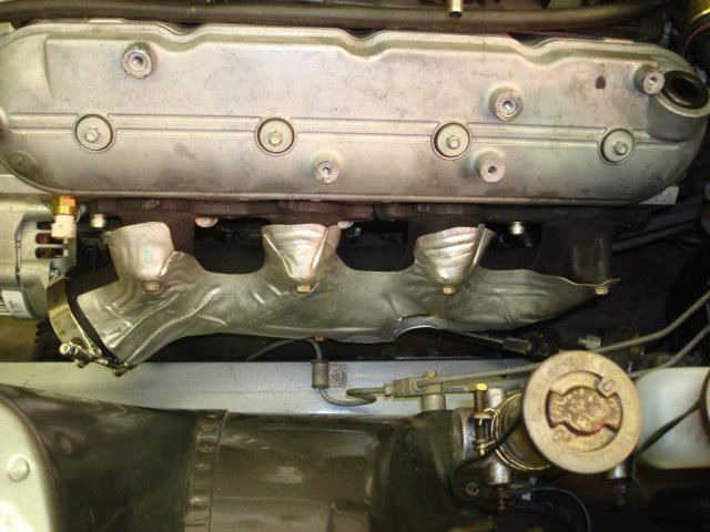

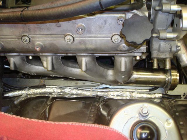

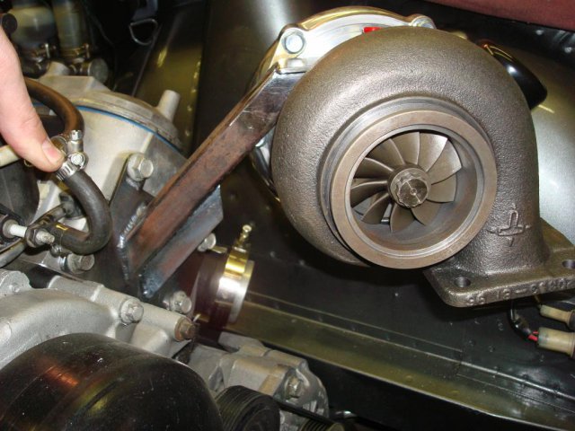

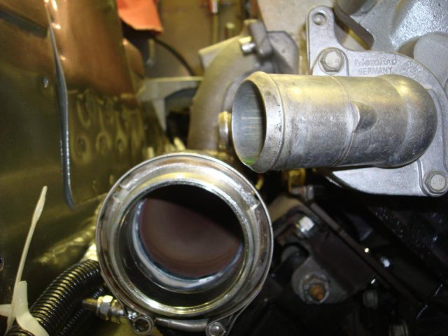

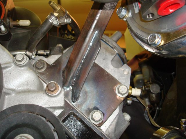

I got some tig welding done today. After finding out the headers would not work I tried to fit a LS4 front exhaust manifold on the passenger side but that wouldn't work either. It was too tall and hit on the frame. I had still another idea, take a truck manifold and modify it to work which is what happened. Here are the pics.
post-8245-0-33677900-1393206529_thumb.jpgpost-8245-0-49914400-1393206640_thumb.jpgpost-8245-0-19380000-1393206740_thumb.jpgpost-8245-0-77815600-1393206823_thumb.jpg
Here is the drivers side manifold. I traded for this one and it already had the v-band welded on.
Downpipe over the top of the passenger's manifold and out then?  I thought about this, but also couldn't find a manifold that would work without extensive mods.  Looking good.
Thanks Sunny. That's what I'm thinking for an exit. I'm not that big on cutting holes in the Z buuut, I've always thought a fender exaust would be cool.
