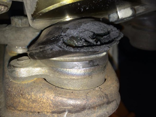

Glad to hear TTT will mod the control arm before they send them out, wish mine was done so I didn't have to grind new powdered parts. Hopefully they will begin to ask if people are running big brake kits. I  just realize they now sell a Wilwood setup of their own. Hmmm - I wish they would have pictures of the products installed on a car or at least complete struts assemblies.
Grinding back the LCA is common for running the AZC big brakes. I've never seen anyone with boots burning either. When the car is level there should be enough air gap. I don't run TTT control arms, but I doubt mounting from bottom is a problem.

Clive, use this stuff on your ball joints and get air to the front brakes.  Use stainless safety wire or zip ties to keep it in place.
http://store.bimmerworld.com/gold-foil-protective-film-p841.aspx
Johnc, thanks! Do you just stick that directly on the rubber dust boot? I guess you just inspect regularly to see that it hasn't come off? Or do we need to make a little shield from a beer can to stick the foil on? You know me-making things complicated!
