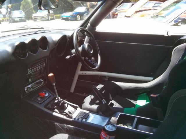

Of all the time I've been on this site I've seen tons of photos of people with full interior, without any kind of roll cage, sometimes with a simple roll bar, but I can't recall any photos of cars with a full cage and donning anything but a stripped out. Has anyone ever seen a S30 with full interior cleanly mated to a full cage with a halo and down bars?

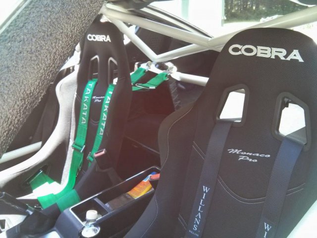

What seat is this? Cost? Source?
Why not get the best of both worlds and buy or build a quality roll bar?   This is my Custom 100% bolt in bar.  It does require 8 holes to be drilled through the rear fender wells, but it can come out at any time.
This is exactly what I want, but are harnesses still "safe" attached to a bolt-in cage?
Also, that looks like a Bride Zeta Type S, or an Exas III.
